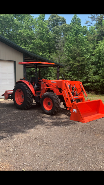

To follow up on my tire questions. I purchased the M7060 with the radial tires, got delivered yesterday. Love the wide front tires, looks good, very pleased with my decision. Thanks for all the comments.

   / M7060 Tire Choices #33
Yes!!!! That looks great!!!! Tell me again what sizes they are??? Thanks for the pic!!!

Unless you need it that narrow for attachments, I'd suggest setting them out a notch or two. It will handle much better and ride better. Less flop from side to side.
That tractor doesn't even look like a 70 with those tires!!!
FRONT - 320/85R20 R1W ALCE FRMPRO
REAR - 420/85R30 R1W ALCE FRMPRO
#36
Yeah wanted the narrowest setting due to my spacing of the Rows. Rear span is still 74"
