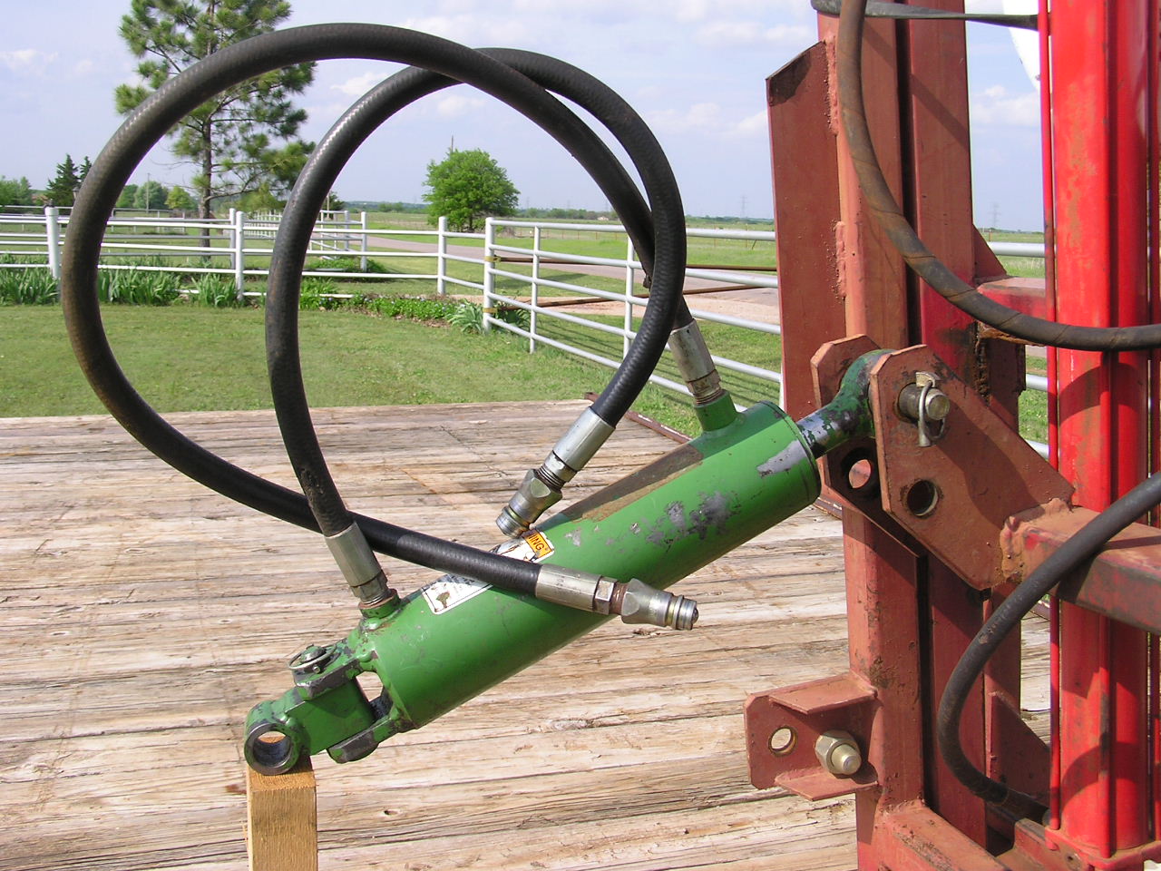

Six, you can add a lock valve to the cylinder, but you lose float.
I don't think I use float or even know exactly how it works. I can guess what a lock valve is but how does it work?
/ M7060 Hyd. Toplink #23
There are cylinders with check valves on them. The valving box on the cylinder is locked shut until a large pressure is applied on either input, then it kicks open. So basically the cylinder can't move until it gets partial system pressure. Applying float at little to no pressure isn't enough to trip the valve.
Those valves add expense & complexity, not to mention kills float. They generally are needed to combat cheap spool valves on the tractor that let the cylinders leak down.
Float just opens both ends of the cylinder to the tank. The cylinder will extend & retract freely based what is pulling or pushing on the cylinder. I love it for mowing to keep the mower following the contours of the ground.
