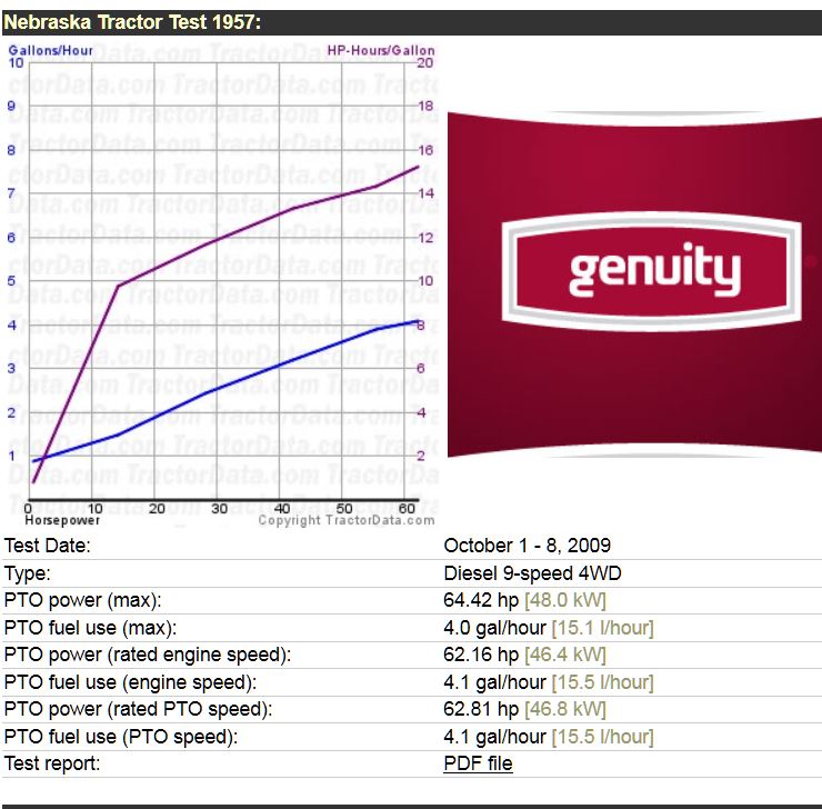

On the JD's being built in India... to me, that's not really much of a big deal. The Powertech 3029 2.9L 3-cylinder engine has been in operation for like 20+ years. It's about as dependable as you can get with an engine. And it being a 3-cyl vs. a 4, I believe you will see some fuel savings, too.
There won't be any fuel savings if a 5075E uses as much fuel as the Nebraska test states @ 4.1 GPH for pto use. My M7040 uses 1.7 GPH pulling a 9'3" disc mower cutting Bermuda grass.

I've always scratched my head at that test. Something's off there. That means I can only get about 5 hours out of one tank of fuel running at 2400rpm? That's not even close to accurate with my experiences.
E.g. the closest test to an M7040 from the Univ. of Nebraska is the M6800 - which they rate at 4.1gph consumption.
I wonder if those figures are a result of running it on the PTO dyno with a high amount of resistance? As in, a lot more than running the PTO under normal operating - rotary cutter, disc mower, etc.?

Measured fuel consumption at full rated PTO horsepower. Full load, in other words.

Gotcha. That's got to be quite a load then. Not sure I would ever run my tractor at that level for continuous hours.
