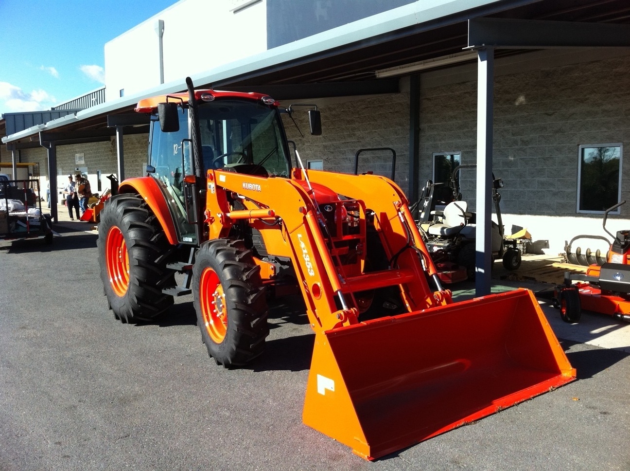

Traded the 7040 for the 9540 today. Take delivery next week after the third function remote is installed. I'm looking forward to the upgrades! Thanks for all your input.

9540 HDC 4WD Cab 12/12
Loader w/84" bucket
3rd Function Remote
2 Rear Remotes
Radial tires (came on the tractor)
This is basically the same setup as my 7040. I'm looking forward to "breaking it in" and getting ready for some snow this winter.

super nice tractor Keving. My uncle has that same tractor, It is a BEAST.

Cast iron rims and tires fluid filled?

Sweet!! :thumbsup: At first in the little pic I thought you didn't get the cab. I was gonna ask exactly how tough you are if you're going to clear much snow. LOL Again, fantastic tractor! I'm sure you'll love it and it will serve you well for decades.
Now you can be like silly me. I really couldn't decide between being "heavy" and running loaded R1 tires and having a pulling beast or running "light" and running non-filled R4 tires for mowing stalks and loader work on pavement. So.....I bought both. I run the wide and tough R4 tires during the summer and sit the bucket off when I mow and then switch to the loaded R1 tires in the winter. Yeah, I'll tell you now, that isn't exactly a cheap way to go, but it works well for me so that's all that counts; right?
Oh yeah, I forgot, I also added the front fenders to keep the front tires from flinging mud and snow on my windshield. I don't want to talk about them though. I promptly tore them off when doing some land clearing. :(
