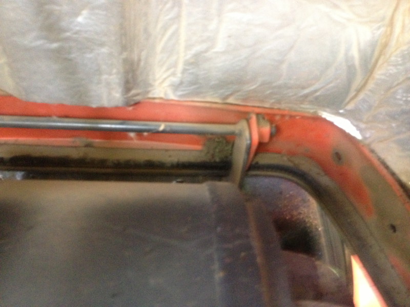

Can anybody shed light on how I remove the hood on a M7040suhd kubota tractor, I think I've blown a radiator hose but I can't see where it is coming from? I can't raise the hood enough to get in there to see where the problem is.

Thanks, my grille/hood lifts from the front and hinges on the firewall. I see a hinge pin, but it doesn't look like it can be removed without taking apart the instrument panel to get to bolts that hold the hinge pin in place.

From viewing the M7040SUHD parts schematic it appears the hood unlatches at the front and pivots up at the rear very similar to my M7040DDC-1. You should be able to view/replace radiator hoses withoutthe need to remove the hood/bonnet.
/ M7040 suhd hood removal? #7
From viewing the M7040SUHD parts schematic it appears the hood pivots up at the rear very similar to my M7040DDC-1. You should be able to inspect/replace radiator hoses without the need to remove the hood/bonnet.
Unfortunately, you can't get your head in there far enough to see where the problem is, even with the bonnet up all the way. It's definitely going to have to be removed.
/ M7040 suhd hood removal? #9
The hood not opening farther is the biggest gripe with my Kubota.
I wanted to remove my hood once and came to the same conclusion as you, there was no easy way to remove the hinges.
Thanks David, was a carter pin or some keeper holding the hinge pin in place?
/ M7040 suhd hood removal? #11
Although I have the M9540 the hood should be the same, except the decals.
You can remove the gas strut to gain a little extra height, but then someone is stuck holding the hood up.
The hood appears to me as though it can not be separated from the hinges. The hinge/hood has to be unbolted from the firewall, which is easier said than done.
