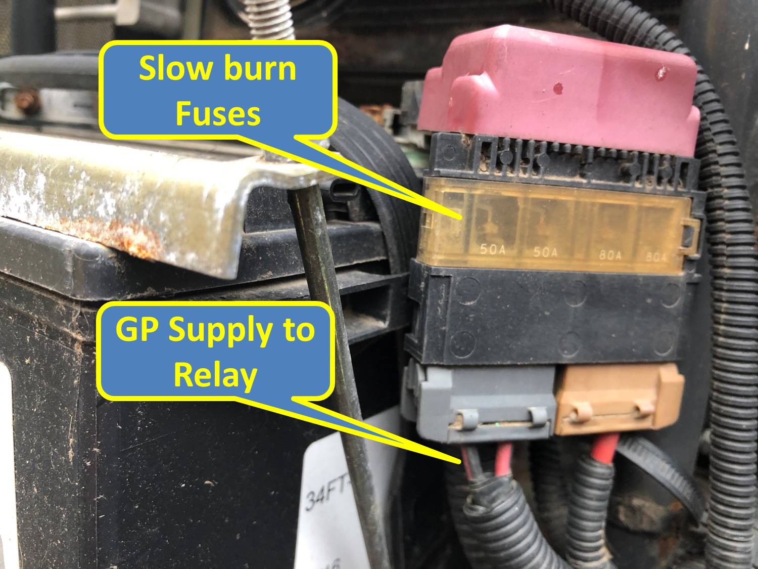

I don't have WSM for the M7040 to reference, but I do want to make you aware there may be slow burn fuses in the wiring circuit. Not saying the fuses are bad, but any termination point is a potential source of voltage drop. My Grand L40 has the slow burn fuses and are located near the battery and many folks overlook their existence in the wiring circuit.
Besides checking static voltage, I'd be testing voltage drop (under load) and narrowing down the circuit until the root cause is found. Hopefully you have a wiring diagram to reference.
Good luck!
