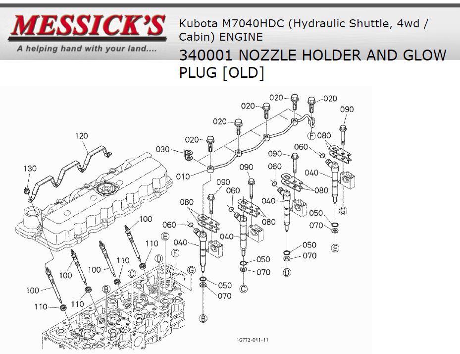

I bought a used 2007 Kubota M7040 3 months ago....like it a lot. It is the 2nd M7040 I've had. The first one, a 2008 model I bought new in Texas.
I have a unheated but insulated barn I keep the tractor in. With this cold weather, finding the tractor turning over cold really slow. I hooked another battery in series, it did help, but I don't really think this is a bad battery issue. The 08 I never experienced that...but being in Texas then, never got this cold either.
Glowplugs...on this model I've read they come on very briefly if at all. First...I wonder why so brief. Every other diesel I have, the glowplugs are on for awhile in the cold before start. I have yet to see the glowplugs come on. Temp in the barn is about 35, and have read they don't come on until it's 32. I do wonder why.
BUT...I wanted to check them, tried to locate, and I can't even find glowplugs on the motor. Anyone with M7040 have a picture of them? And...what's the opinion of a hose heater in the lower radiator hose. Thinking I may add, but want to figure out the glowplug issue first.
/ M7040 glowplugs #2
GP's are parts key #100. Electrically besides ign switch there's a timer & relay that controls the GP's.

That scheme shows why I couldn't see them. With the loader on....tough to view things on recesses on top of the motor. I doubt there is an actually issue with the plugs themselves, but in regard to how controlled...another matter.
