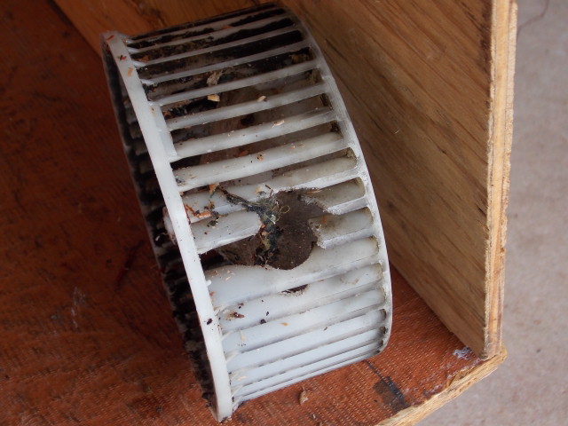

Here's what mice did to the heater fan on my neighbor's Dodge pick up.
