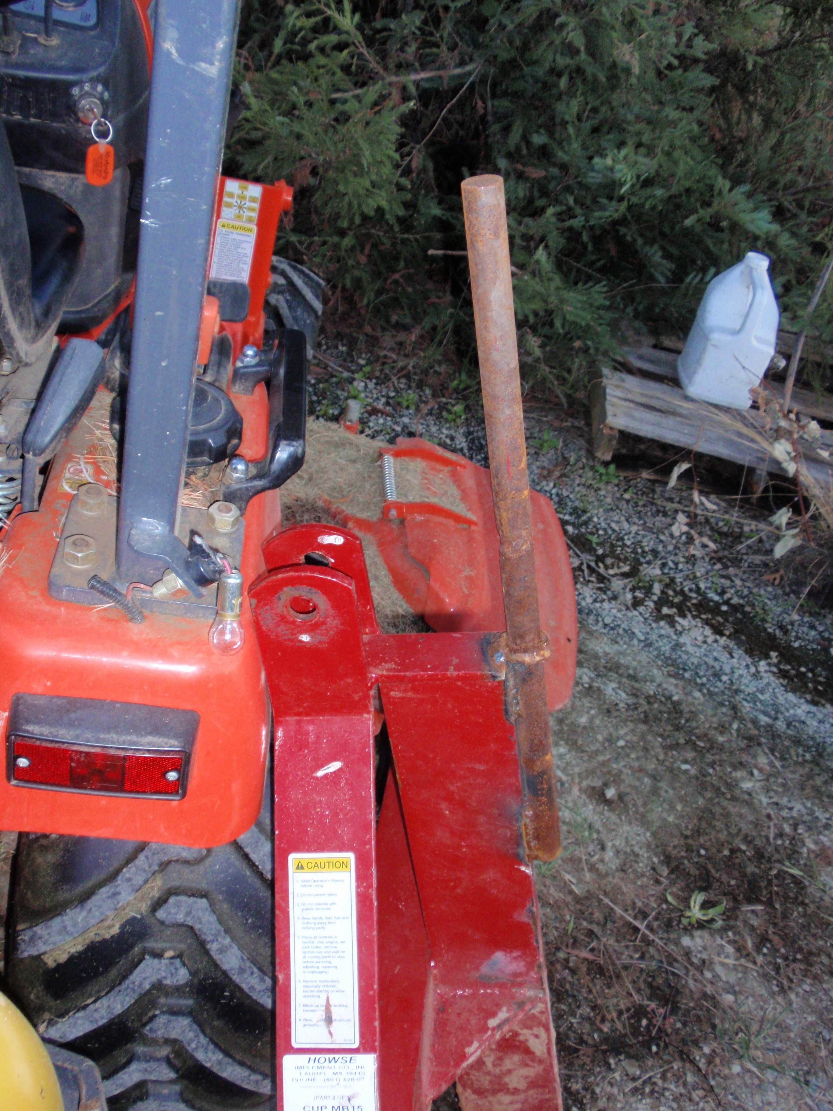

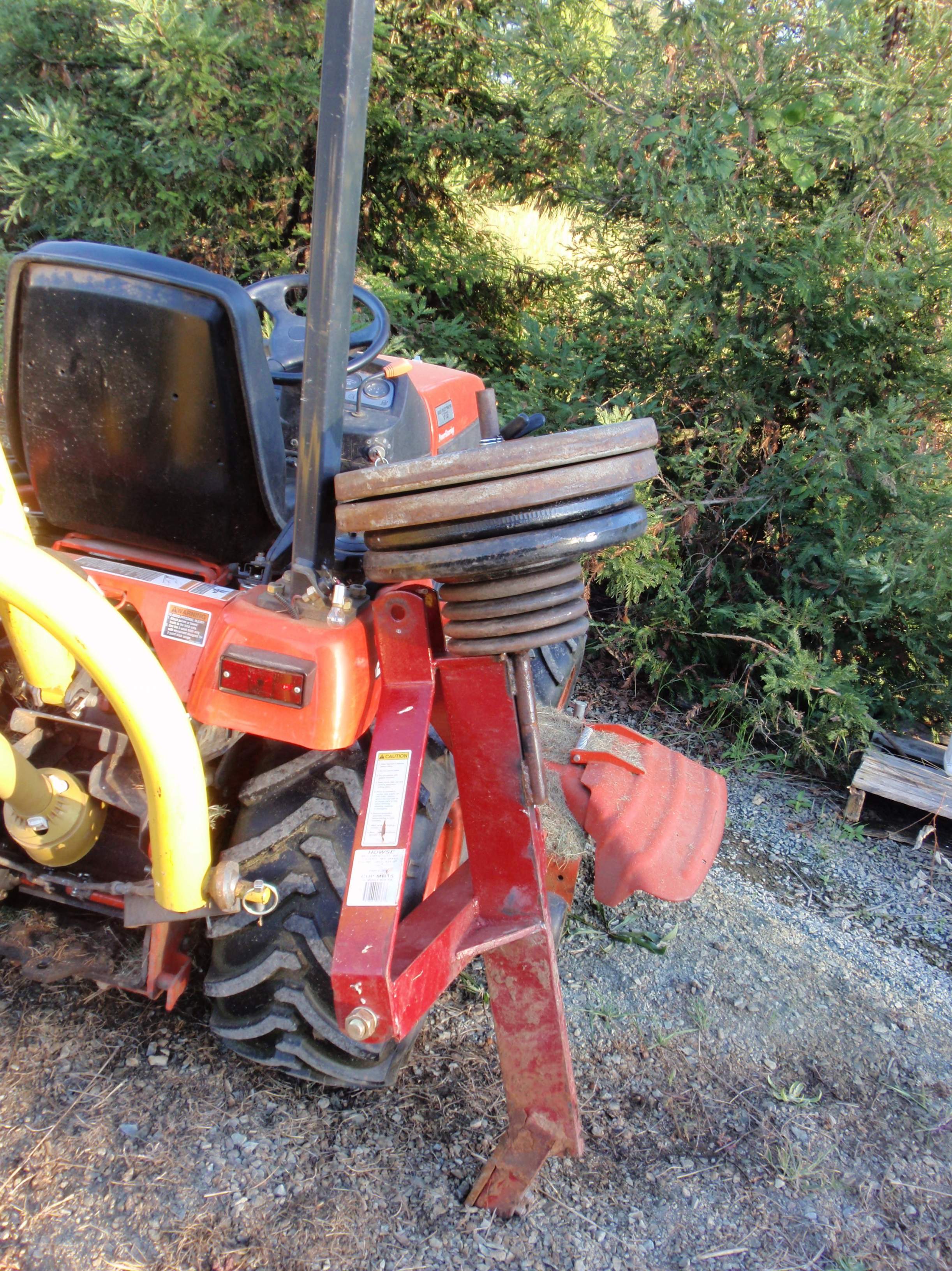

Worse than clay is hardpan. Two things can help. Make the top link as short as possible to get a better bite. Use ballast on the subsoiler:

/ M7040 and pulling a subsoiler? #7
I'd be making the top link longer to hold the point under and you won't need the weight!
/ M7040 and pulling a subsoiler? #8
No, it works the other way around. Shortening the top link makes a greater angle, which actually bites in better. I was doing it with the link long, like you said, and that wasn't working. Several TBNers told me to shorten the link instead for it to work. They were correct: when I shortened the link, it worked.
