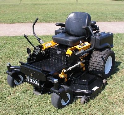

I have an M60 Tank with the 23 HP Kawasaki engine. It has a little over 500 hrs and the clutch started not wanting to engage so I adjusted the 3 screws on the clutch so it engages most of the time - sometimes have to rev engine. Problem is I just put a new battery in and either the clutch is draining the battery or it isn't charging properly. I have a multi-meter so I guess I need to start checking and see how much voltage it is putting out when running?

/ M60 Tank Can't Keep Battery Charged #7
Lets not scare him away while we are having fun.
Probably one of these.
Bruce
Bummer, but that still looks cool.
OP: Check the voltage at the battery when the engine is running. It should be about 14vdc. If not then check back up the charging circuit.
