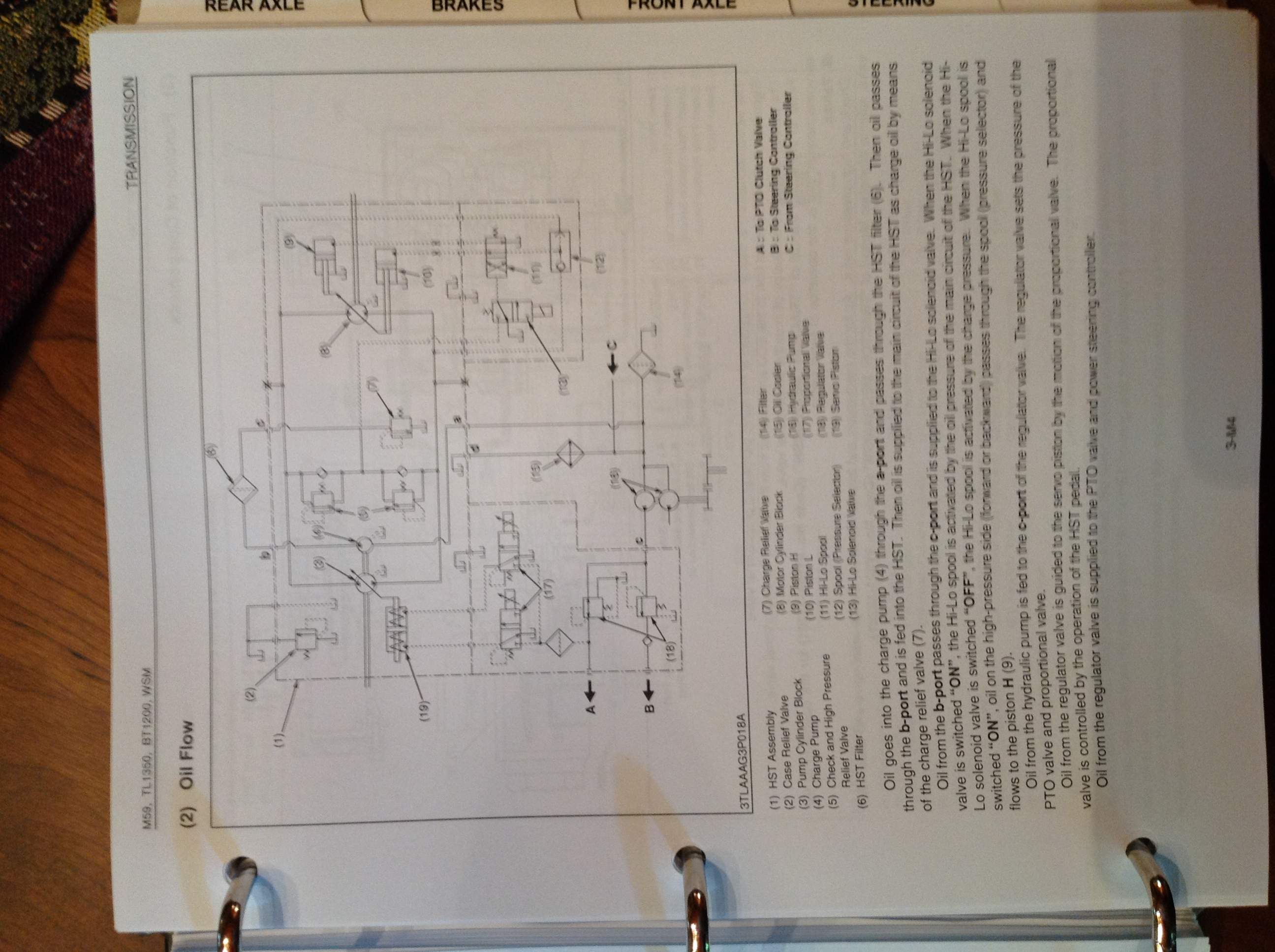

The HST drive is a hydraulic pump coupled to a hydraulic motor, separate from the other tractor hydraulics (big pump on the right side, and a smaller one for the backhoe swing circuit). If the tractor moves fine with the creep lever while in first gear, then probably the HST drive is fine. I would be looking at the foot pedal and connections in that case. But it is odd that you would have problems with both the PTO sensor and foot pedal at the same time. If it is a moisture problem having to do with heavy rain, you might just want to wait a while.

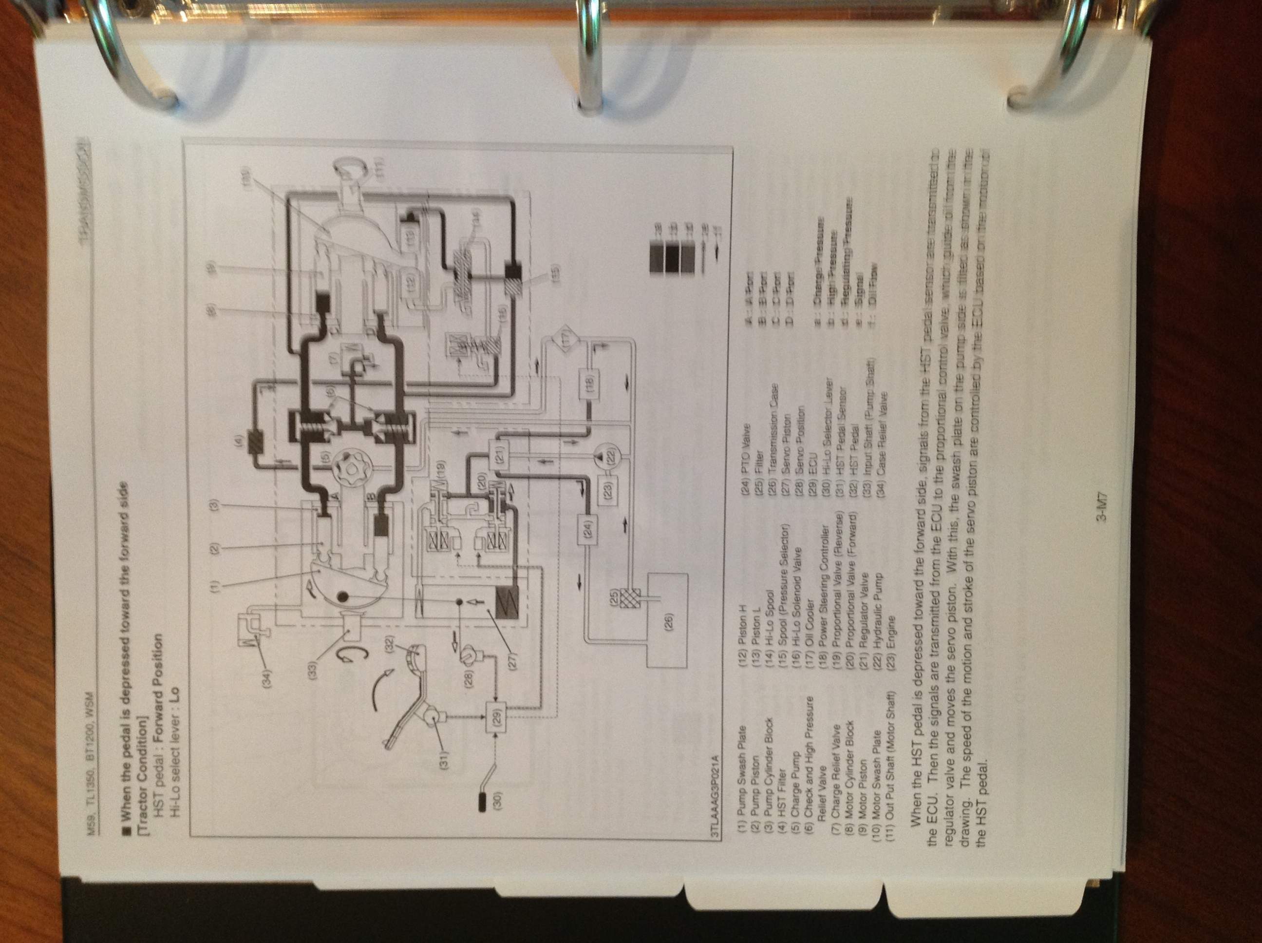

Well you could actually have a HST problem, but the symptoms suggest it may be a simpler (and much less expensive) electrical problem instead, so that would be the first thing to look for. The ECU (computer) controls everything. The HST pump is directly connected to the engine via the clutch. Flow to the HST motor is controlled by a servomechanism that is controlled by the ECU. When you move the foot pedal the ECU is sending signals to the servo which moves a swash plate. The swash plate controls flow to the HST motor, providing forward or reverse and speed control, all by controlling the flow of hydraulic oil. The bottom line is, probably either the ECU is not saying go for some reason, or (less likely) you could conceivably have a problem with the HST servo. The first thing to do is check for error indications from the ECU, after which you would have to start running diagnostic tests.

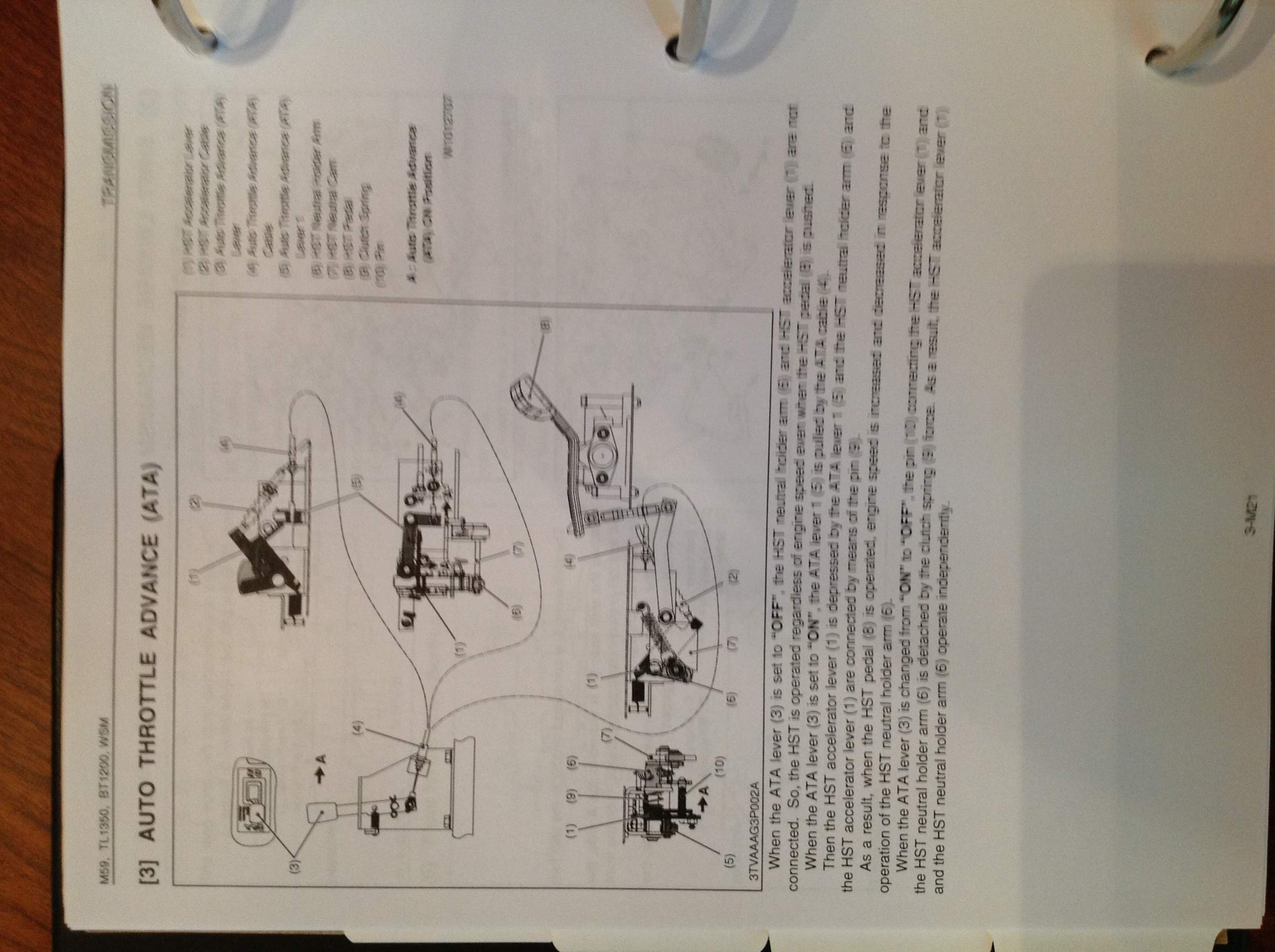

Auto throttle is a mechanical cable

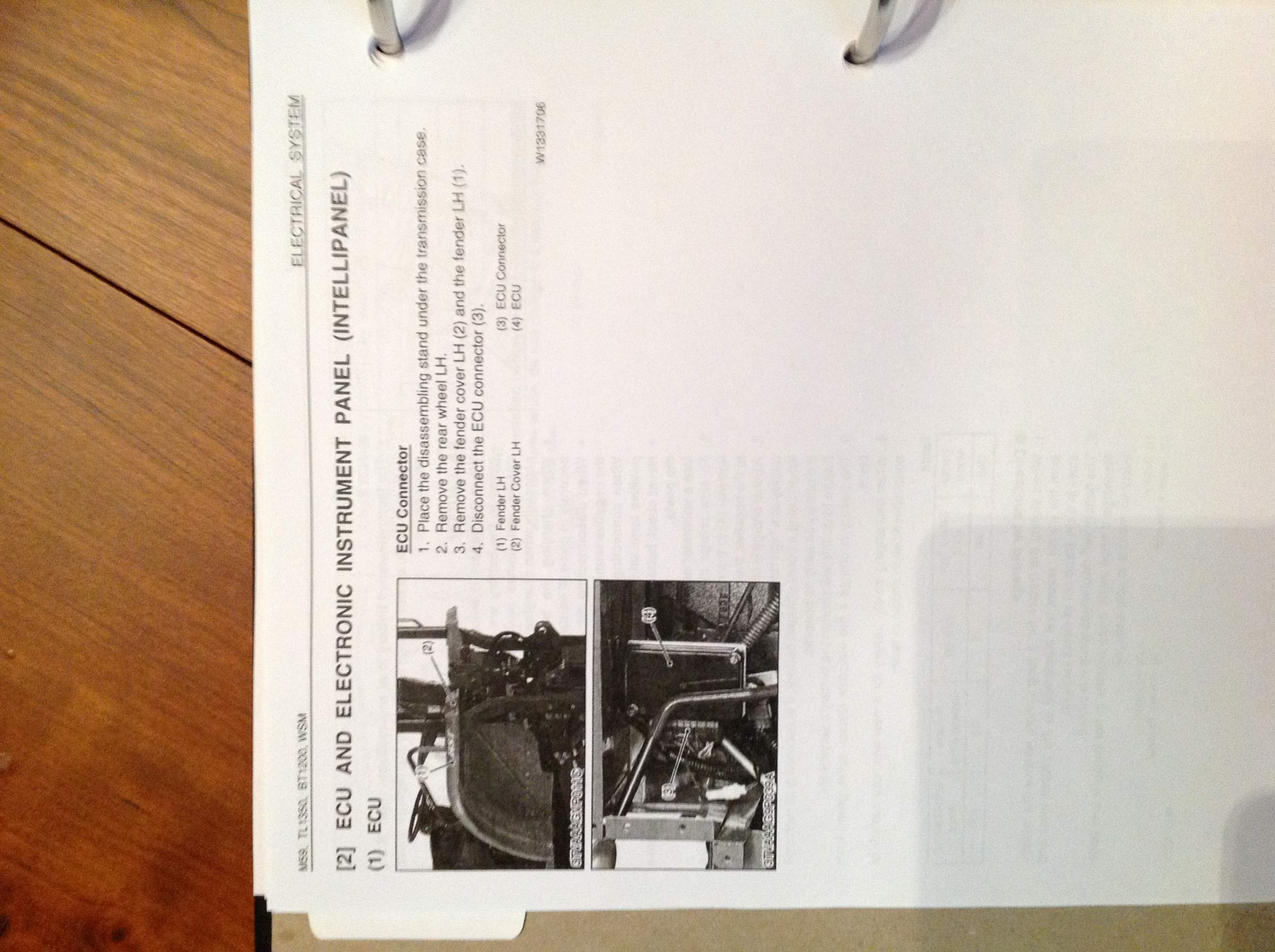

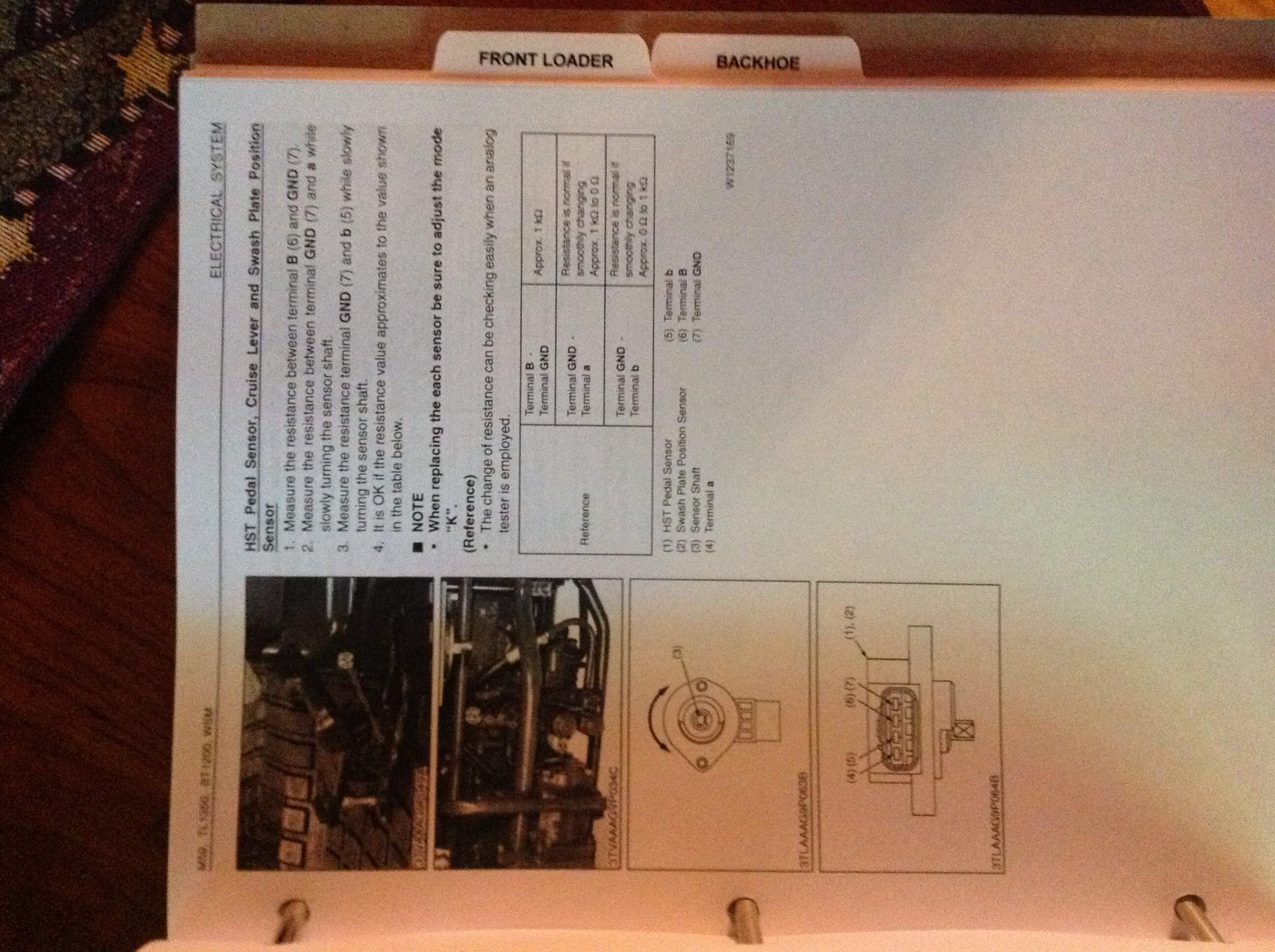

Travel pedal sensor provides feed back to the ECU.
I would start there. Perhaps you will be lucky and find the connector loose.

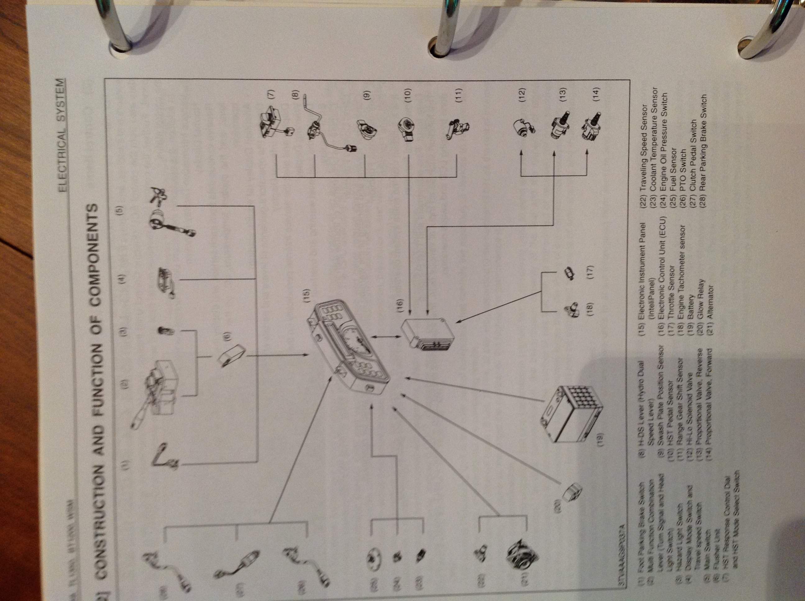

Further diagnostic details. I have the elec schematic. In general it shows sensors attaching back to the ECU.
Regards

Thanks tbard for the hst transmission explanation. I've been ignorant of how they work and that makes a lot of sense. Got a mechanic that's going to check it out thus evening. Its not giving me any error codes which I find strange.
Thanks band d cabinet for the electrical diagrams will definitely put them to use.

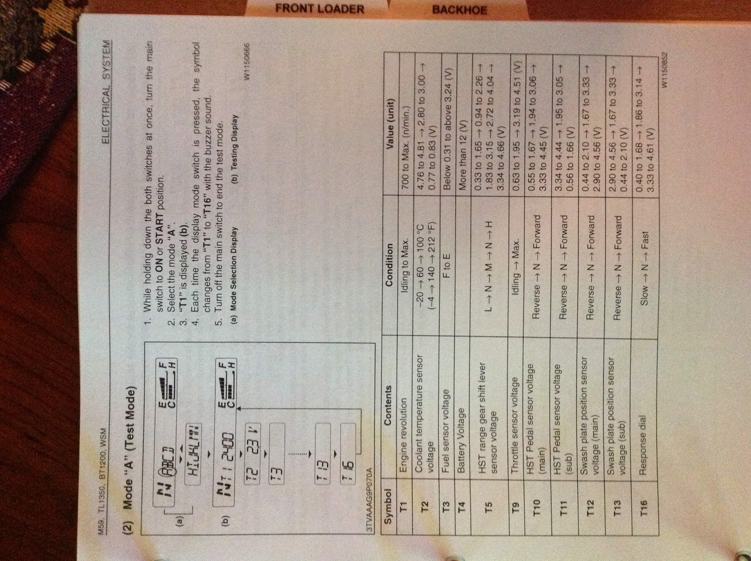

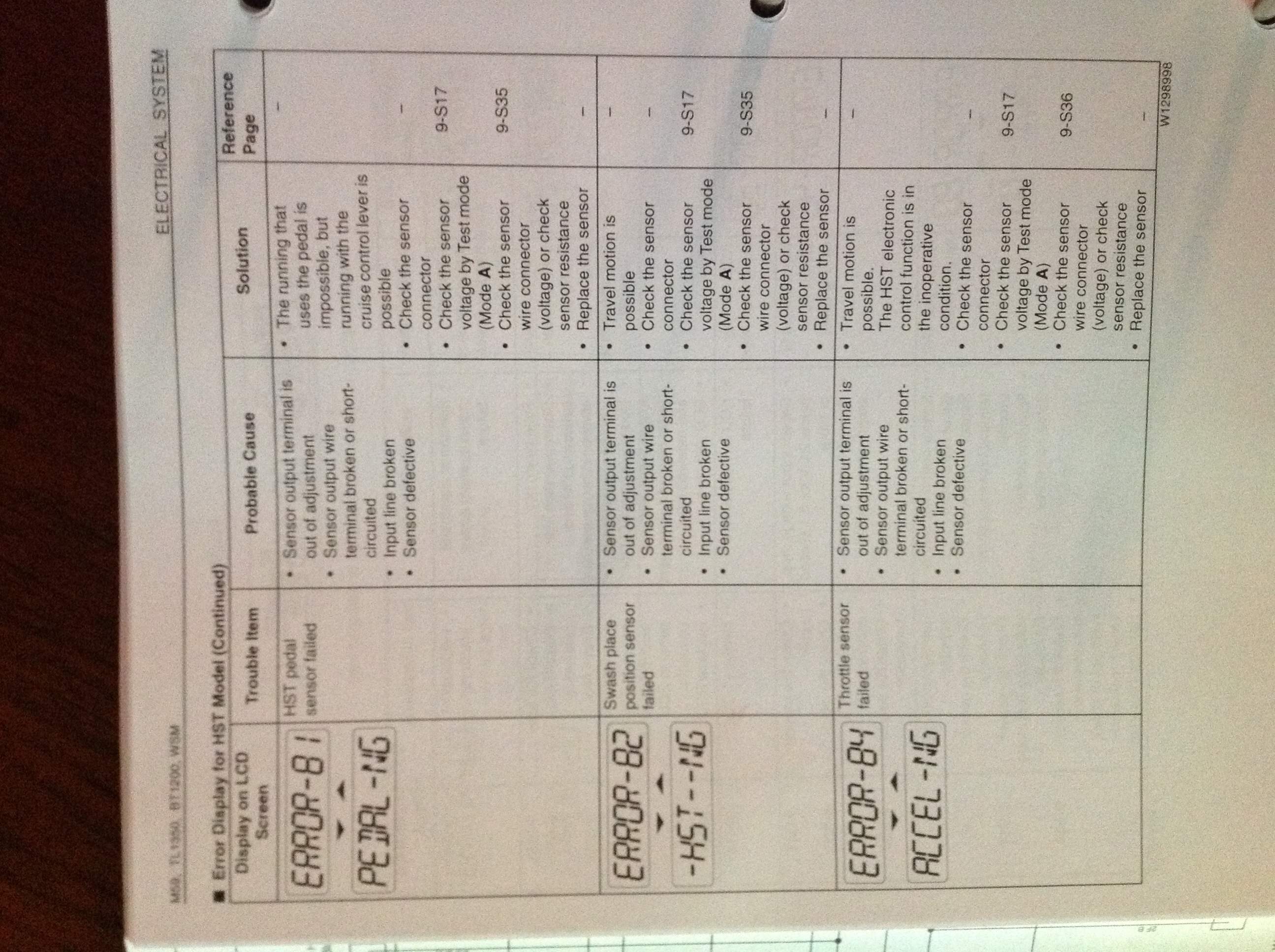

One of the pictures walks you thru testing. Have you been holding down the two buttons when you switch it on?
/ M59 will not drive #18
See attached
I would run thru Test Mode A and check the feedback from various sensors. In particular T10 and T11.
Don't hesitate to ask for more info. My binder is 5 inches thick!!!
Regards.
