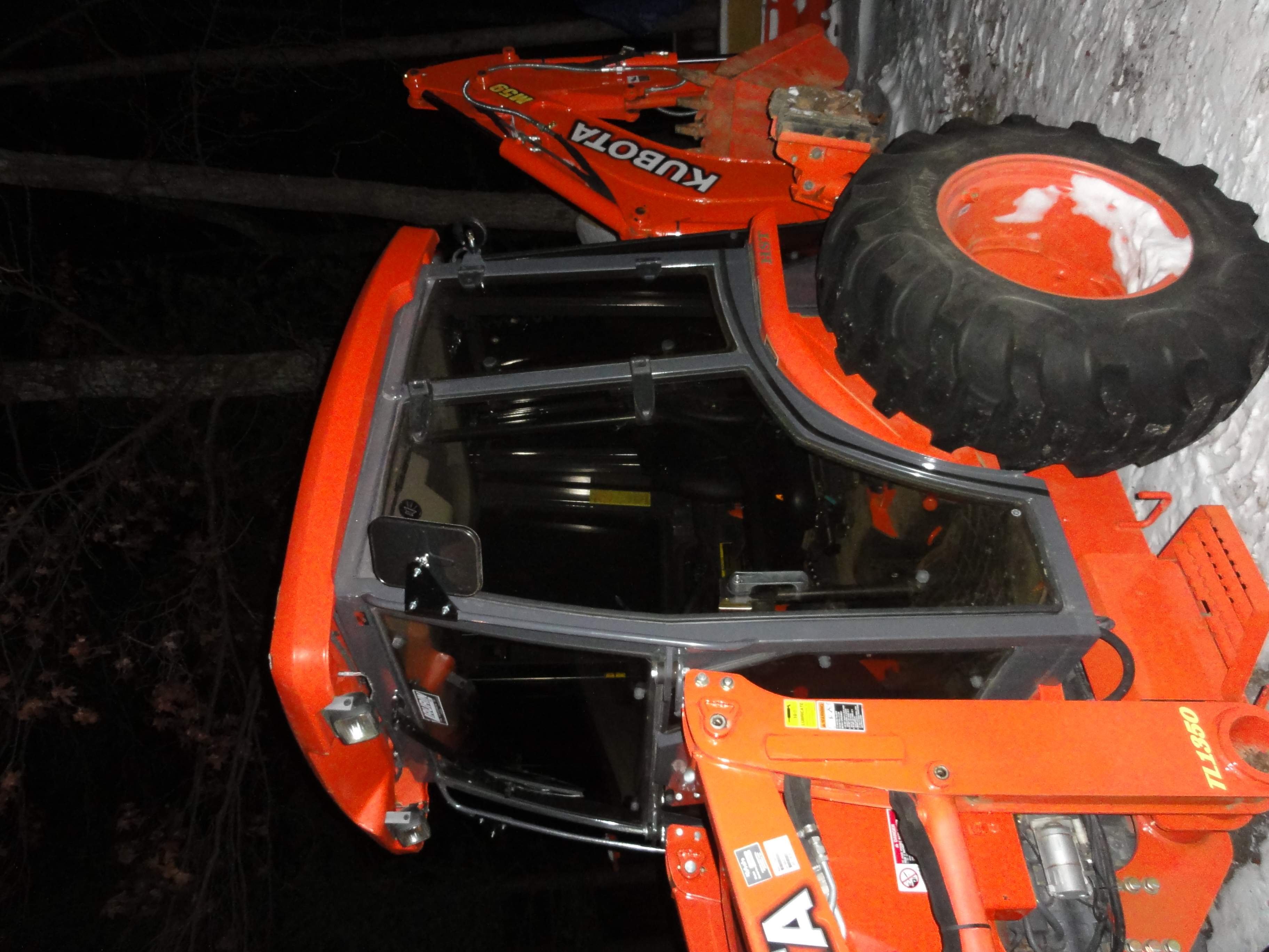

Questions- can you drop the loader on both machines ? Why no cab on the M59? If that unit had AC/Heat I'd have all my prayers answered in regards to the perfect sized tractor for most of my weather challenged tasks. Snow removal, brush hogging. Where is most of the weight in the L45 compared to the lighter L's ?
/ M59 vs L45 TLB #10
I know the bucket is QA, not sure about the loader 'arm's themselves. No idea about the cab on the M59 and why they didn't but I now Kubota has never had one for their TLB lineup. The weight of the L45 vs other lighter L's I believe is in the frame - much beefier/heavier grade steel. You can easily see the difference if you compare it with another Kubota on a lot. The BH definitely adds some weight as well of course.
/ M59 vs L45 TLB #12
M59 with cab heat and AC attached
