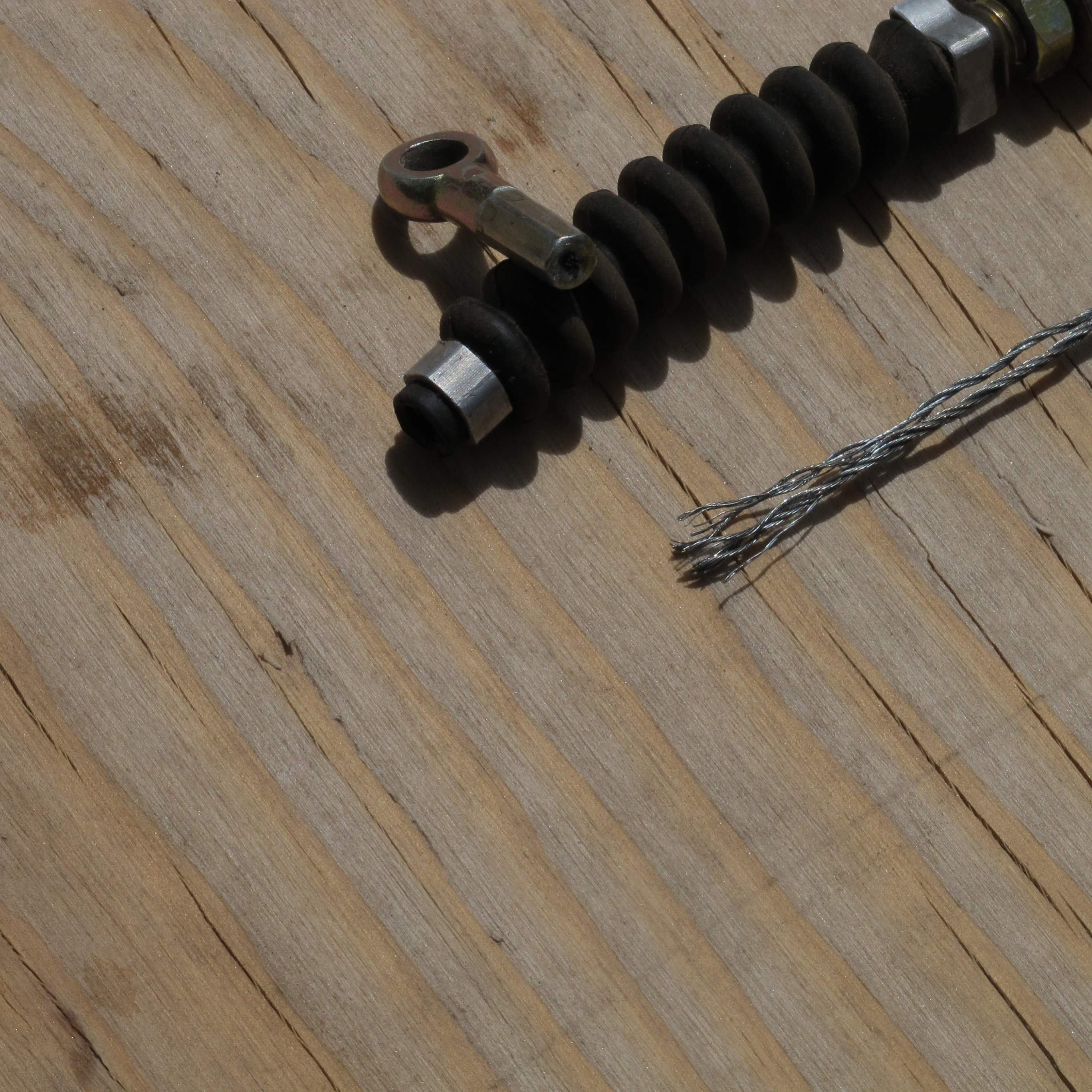

Good analysis. Where exactly did the cable fail. Did it break clean or fray? Is the design complimentary to multi strand cable such that only pull forces are called for, or is it push pull?
larry

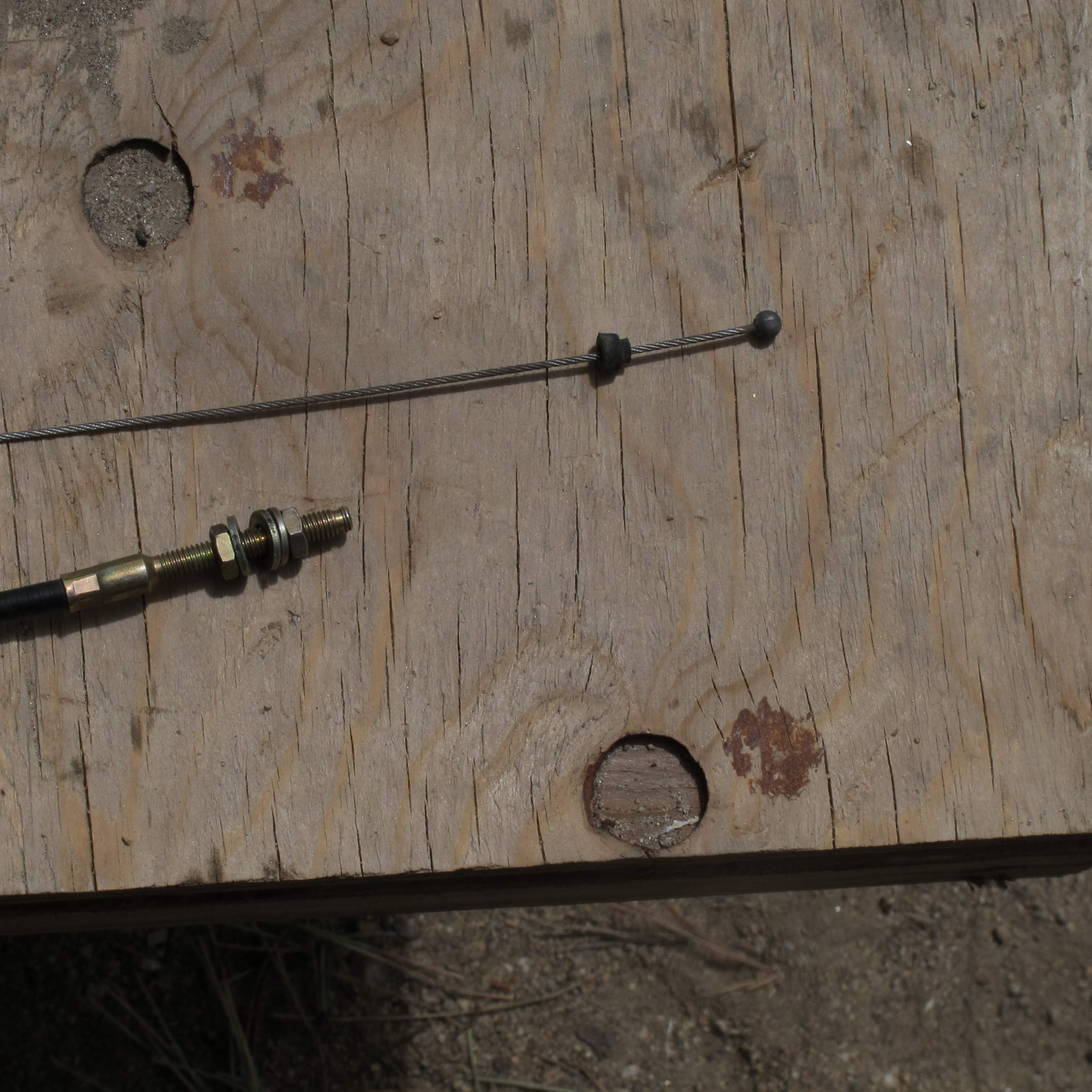

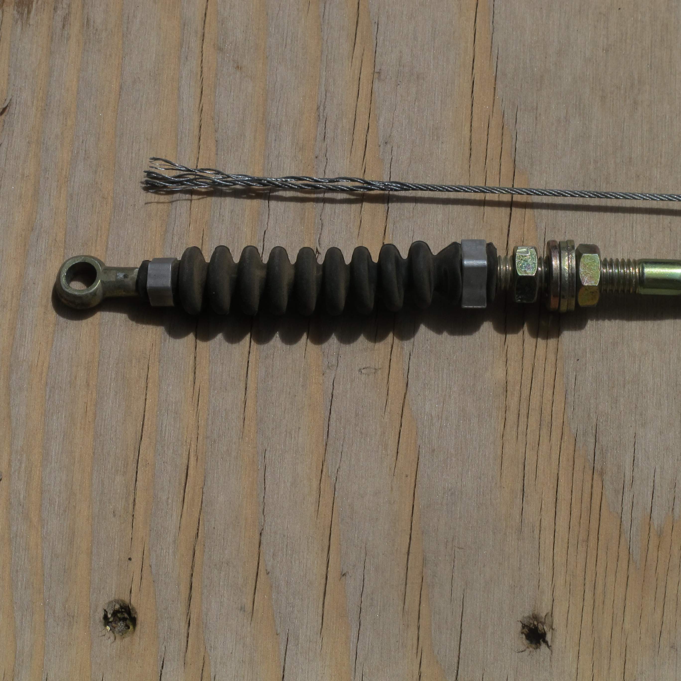

disassembled.jpgauto throttle_ transmission end.jpgAuto throttle_governor end.jpg
larry
Pics: disassembled after end of cable, after end of cable before disassembly, governor end of cable.
Thanks. Yes, you have a good question. This is a multistrand cable used only for pulling forces. Return forces are supplied by springs at the other end within the governor. The unbroken end pulls on a drum to rotate the governor. Connection there is around a about a 4" diameter drum that is large enough so that bending is small.
The after end that broke is within the rubber bellows and it broke cleanly inside that bellows about .01" from where it is compressed into the bronze aft ring eyelet. That's the eyelet that surrounds a pin on the end of a lever leading into the transmission. The broken end did fray, but because the breaks are all on the same perpendicular plane to the cable it looks to me like the cable frayed as a result of the successive parting of the strands at the high stress location. see pics.
When I took a look today I noticed signs of galling on the inside of the bronze ring eyelet. That would seem to indicate that the eyelet didn't rotate freely on it's pin and of course that would increase the bending of the cable wire. Looks like that may be the cause. That area is accessible for lubrication - with some difficulty, but accessible. If it had gotten a few drops of oil from time to time it probably would have lasted longer. Now that I'm looking at the galling of the eyelet it makes me think that's all it needed.
Thanks again. Great question, Larry! It might have led us to a cure - at the least improved things.
