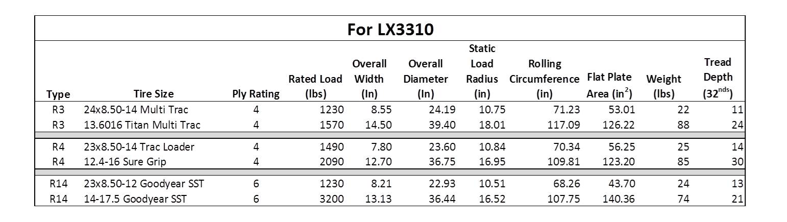

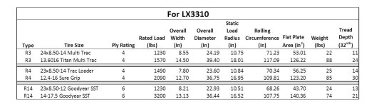

Here is quantitative data straight from the Titan Catalog, so everyone can make their own decisions on what is appropriate. R1's are not included in the table.
Hope this helps.
