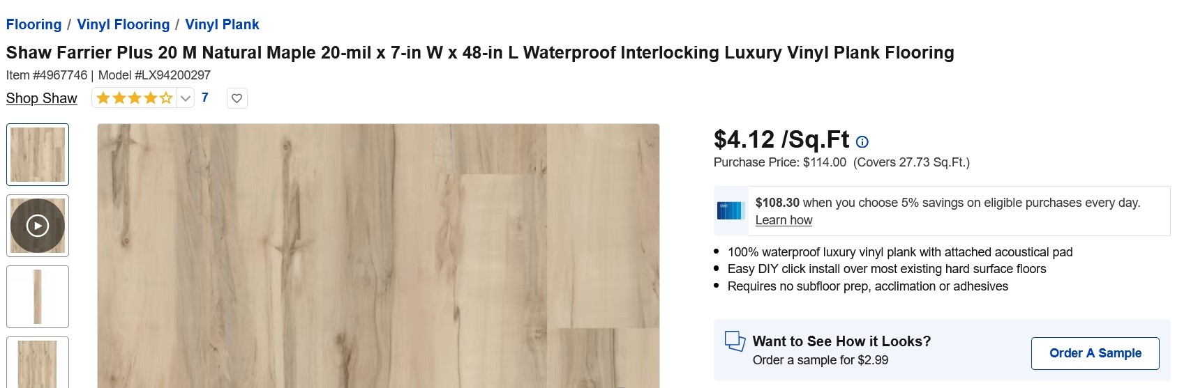

From my research it appears that MIL WEAR LAYER is important as that determines how strong the laminate face is. The thicker the wear layer, the more expensive the flooring, but worth the price. I found a LVP made by Shaw that is 20 mils thick.

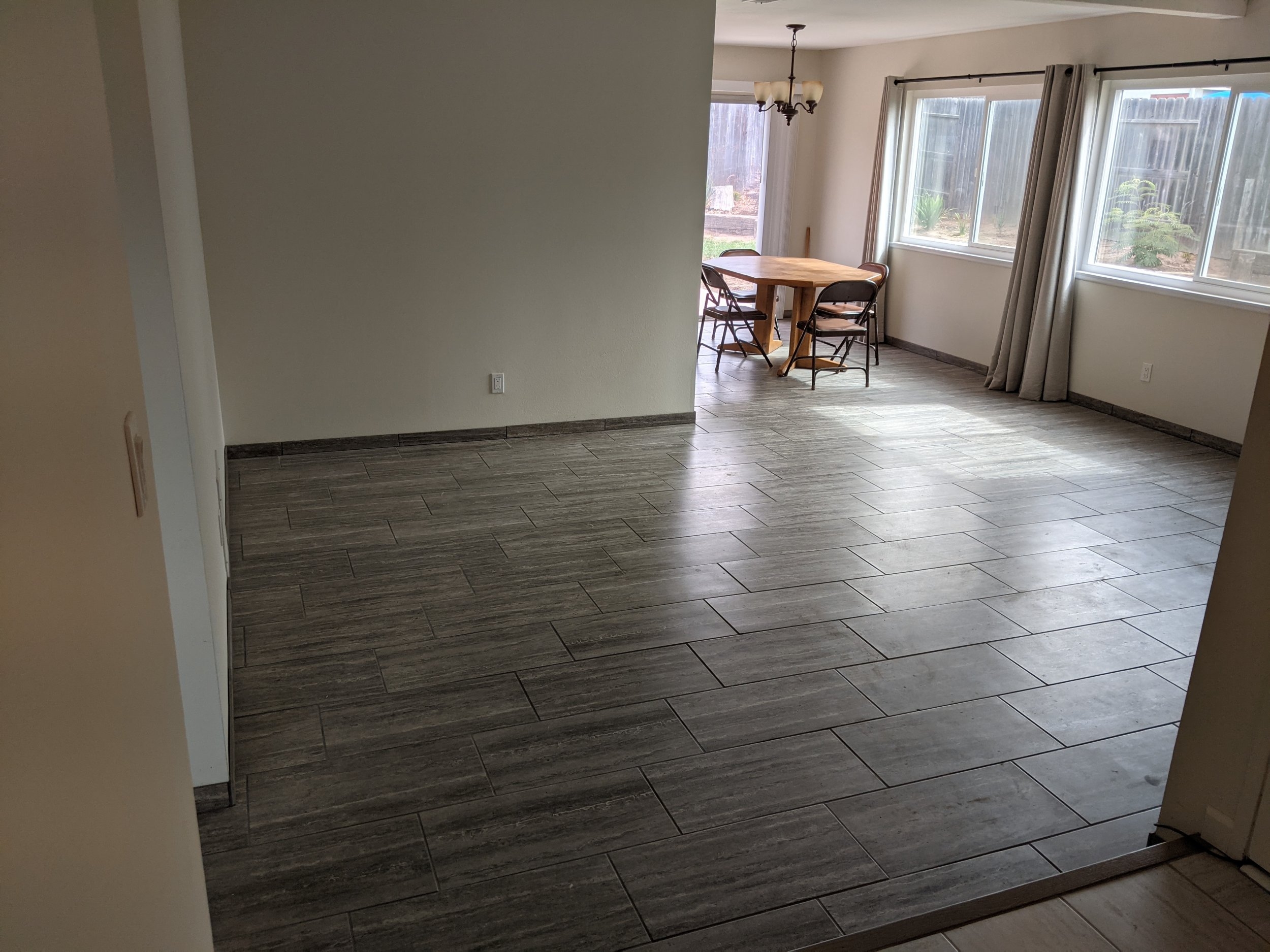

I just finished a laminate floor project in my office. I also did a porcelain tile project in a rental house last year (12x24" tiles). As far as diy is concerned, I'd do tile any day of the week over laminate. The key to either is having a really flat subfloor to put them on.

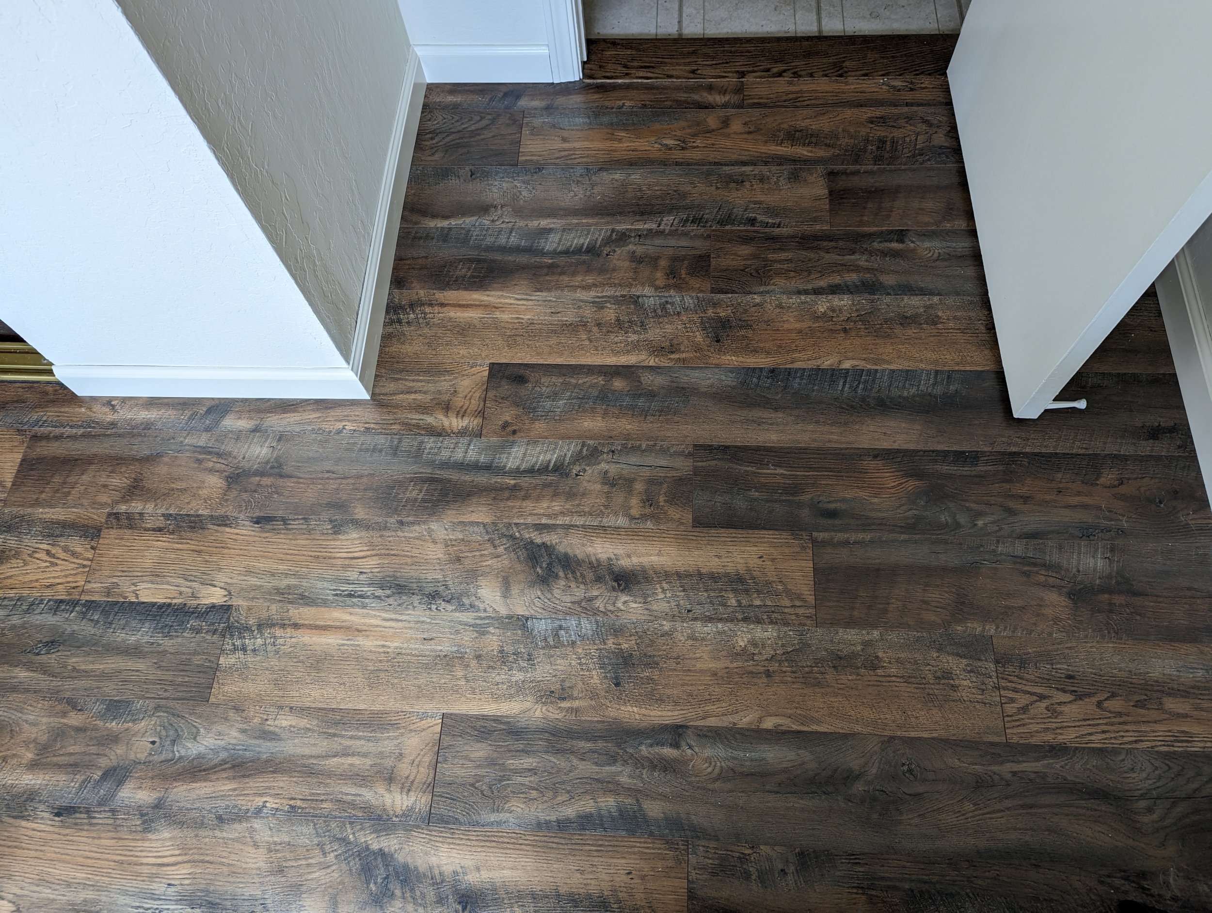

We just did LVP in our new house build. From my limited knowledge gained from that project, I found that the wear layer thickness is not directly correlated to scratch resistance. The one we eventually chose has a 12 mil wear layer with ceramic coating for scratch resistance. Time will tell if we made a good decision...

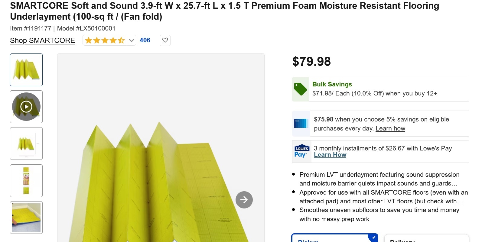

I also looked at the Lifeproof (HD) brand, it's also a 20 mil wear layer. The Shaw (Lowe's) brand comes with a pre-installed backing but they do sell a 1.5mm backing you can put down on the floor before laying the LVP. Shaw claims you don't need it but it can be used.
