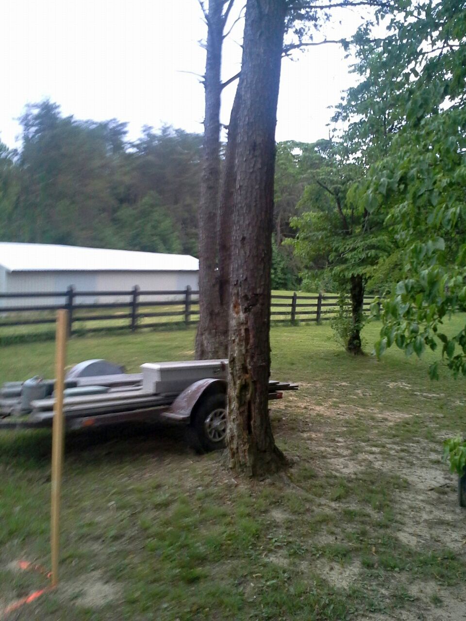

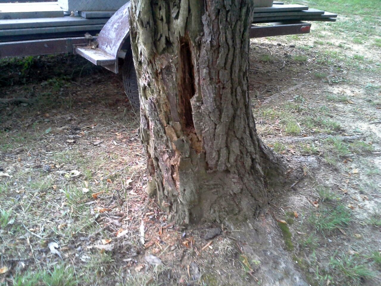

Okay, the pics did fine on my work PC. My thoughts are that I will be notching the dead side out on the same side I will be pulling from, leaving me to cut live tree to fell it. It's just goofy looking enough to make me want to ask for thoughts from others who have been there-done that. I've dropped a lot of trees, and knocking on wood, so far no problems.......but, I'm ever cautious, especially when something looks..........funky. The "barberchair" was a new one on me however, I can see it happening easily when a tree is being pulled and the saw stops before cutting far enough. I'm thinking I'll notch the crappy side with an older chain because I'm sure I'll hit some lead, then use a fresh chain and a full tank to make the back cut. If you can, visualize me trying to drop it in the opening between the trailer and the wood stake in the photo. (trailer will be moved)
I've got about a 35' wide window between the house and the neighbors fence to drop this bugger in and it's not very wide at the top. I think my shooting into it years ago stunted the limb growth. ;-) I'm not worried enough to call a "pro", or some may say not smart enough to, but I would like some thoughts now that I finally got some pictures to load.
Thanks to all so far, it's all good sensible advise.

wow -- that tree is gone.... its mostly hollow. I wouldnt worry about barberchairing much.. nothing in it to split up the middle. I see it already has a lean and its gonna go in that direction. Do you have a nearby tree? If so why not hook a cable to the base of tree for a tension point and put other end of cable high up in dead tree far up as possible. tension cable lightly. make your front cut shallow as its hollow tree and then tension cable as much you dare, but dont over do it. then do your back cut.

Yeesh! That dead rotten wood looks unpredictable.
Though it's a trade-off and makes it harder to get away from the tree if things go bad, it would lessen the chances of things going bad if you could make the cut up higher where the tree is good and not rely on rotted wood for the holding wood/hinge. You don't want to cut through the hinge when directing a tree (or anytime) and want it to be reliable to steer the tree down.
Again, put a safety strap or chain in a belt fashion around the trunk above where you're making the hold the trunk together from splitting/barber chairing.
