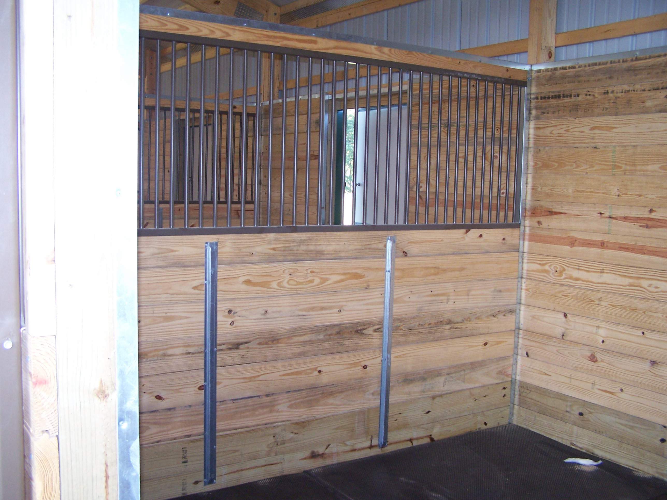

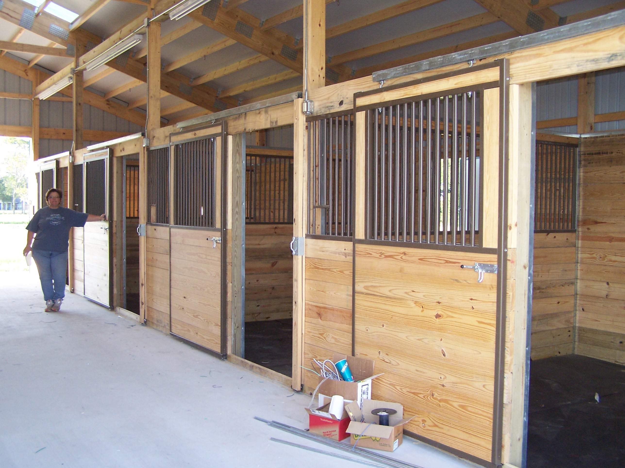

Our Morton stables has pressure treated 2"X8" tongue and groove at the bottom and untreated 2X8 tongue and groove above to 8' 100_0779.jpg100_0783.jpg. Stalls are 12'X12' with corner posts and metal supports on the walls. We have had no problems with our warmbloods kicking a wall.
