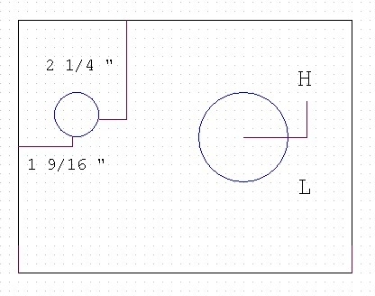

/ lubricants #25
Joe,
Very good question. Too low is obvious but a little overfilled is I guess okay but way overfilled is no good either. What happens is the gears then bash/thrash the oil and it most likely will aerate and diminishes its lubricating qualities. Heat causes the fluid to expand too. Also the front seal(especially) may not be able to hold back the oil being thrown onto it. If that happens then oil gets into clutch housing, not a good thing either.
So with that said the oil should be at a reasonable level. I had originally thought the oil overflowed a partition to fill the creeper but evidently not. I can't remember but it might have been Chip that said the oil seeps thru the rear bearing to the creeper housing. Who knows,,, maybe the Chinese use sealed bearings once in a while and this causes the no fill problem. I am just guessing at that.
Anyways if you look at the 1st pic of the creeper cover off you will see that the oil level barely covers the lower shaft and is about 5 1/2 to 6" from the top of the case. The oil is thrown all over the place once that shaft starts turning so don't try and start engine with that cover off unless you want a gear oil bath. You can use the trans dipstick to get an good approximation on where the oil level should be if you have the creeper cover off. I would guess(and only a guess) the creeper holds about 2 qts full.

/ lubricants #26
Hey Harry,
It looks like to me, that the only way for me to make sure of the proper level of the oil in the Creeper Gear box, is to remove the cover, take a look and then measure the oil level.
When I take the cover off, is it necessary to remove the operating handle, or does the operating handle and the arm that operates the Shifter fork all lift out together?
I also noticed on the parts schematic, that there is a small bearing and spring. If I remember correctly that is located in a recessed area on the shaft that the Shifter Fork slides on. I'm trying to see if there are any little parts that might fall down into the Creeper case.
I'll leave the operating lever in either the high or low range to make it easier to line up, when I put the cover back on.
There's no way around it, the covers got to come off to see where the oil level is.

/ lubricants #27
Joe, just remove the 8 bolts and the cover lifts right off. Its almost impossible to put it back on incorrectly. You will see when you take it off. Its not like some transmissions I've had to overhaul. These China tractors are simplicity in design. Thats why we like them so much.
