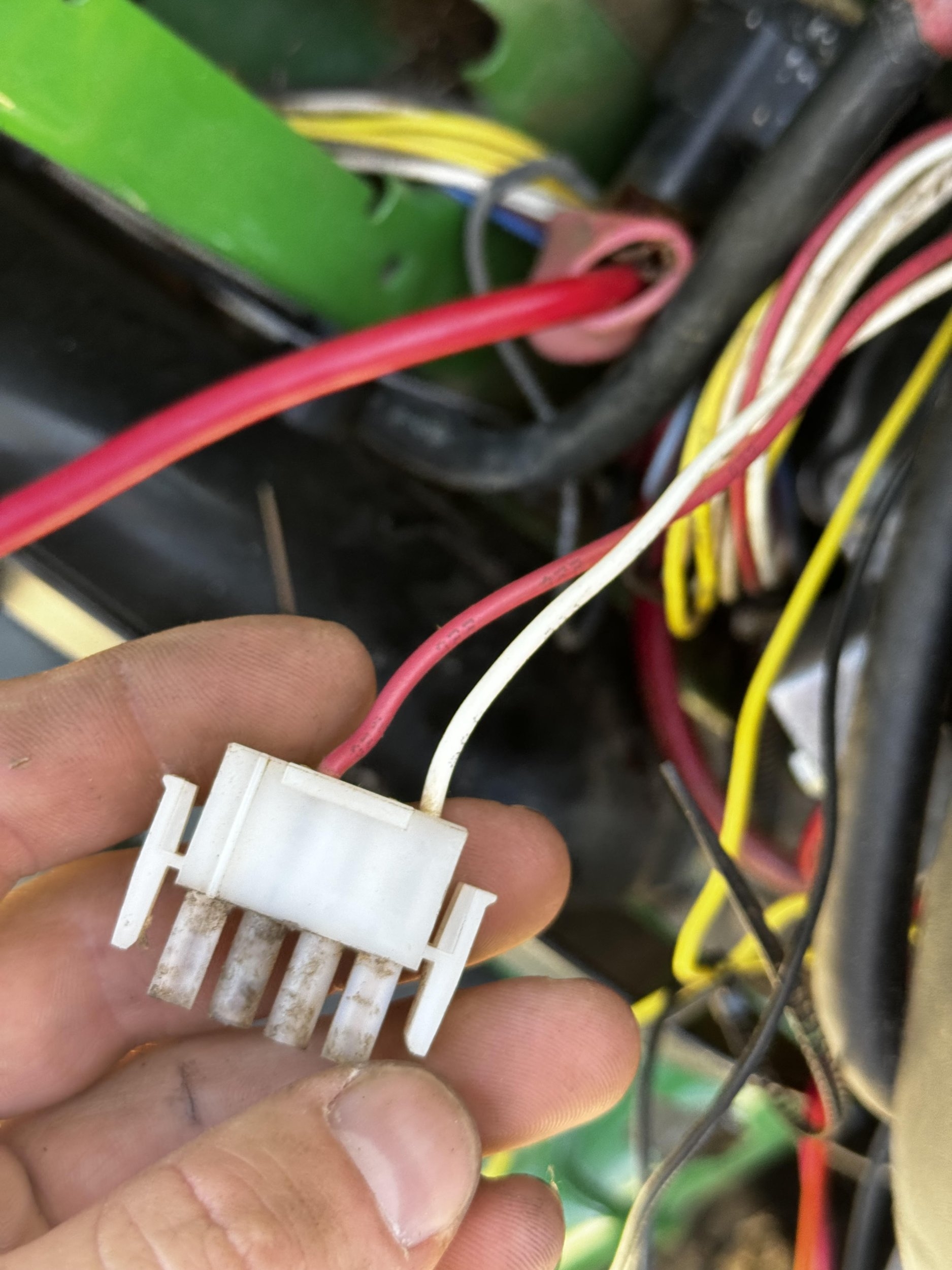

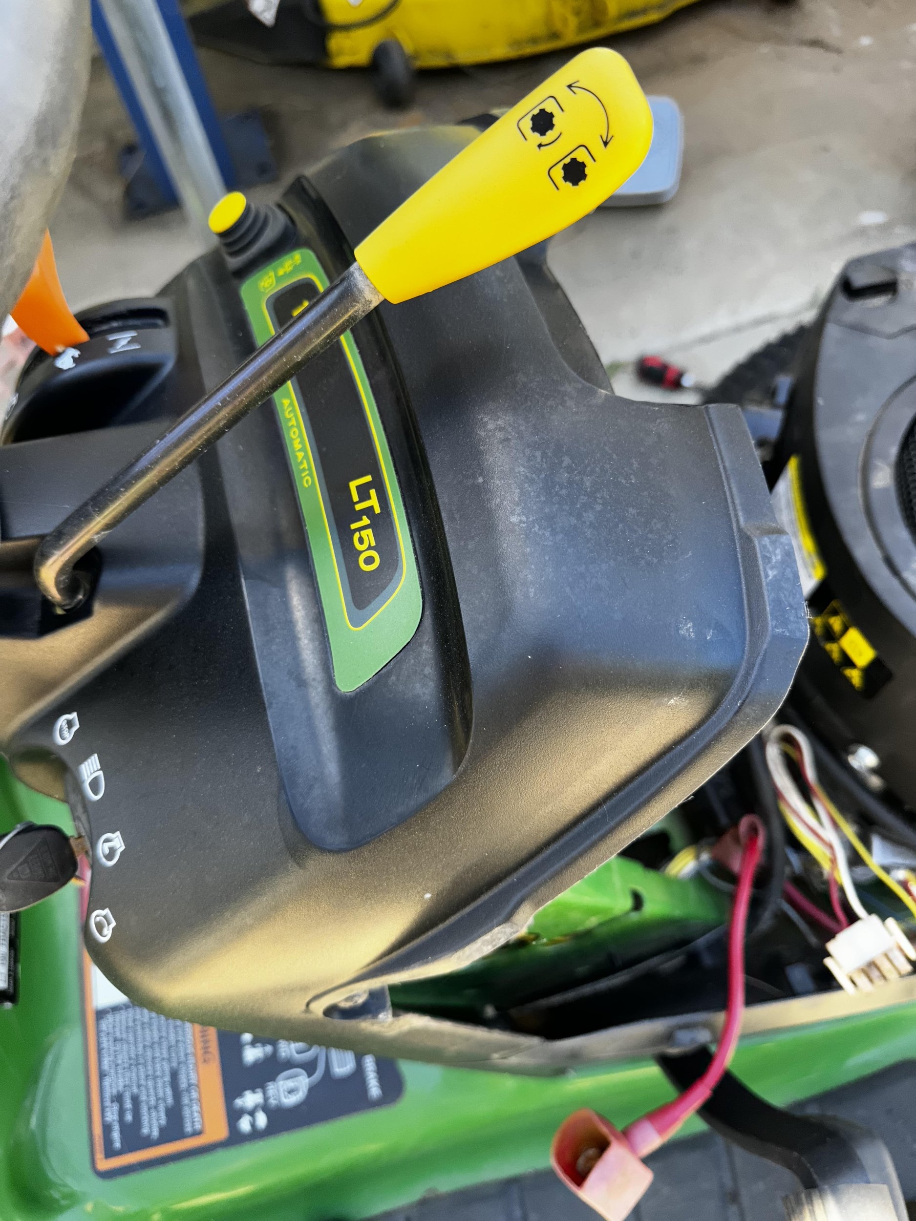

Looking to get some advice installing new motor on my 2002 LT150.

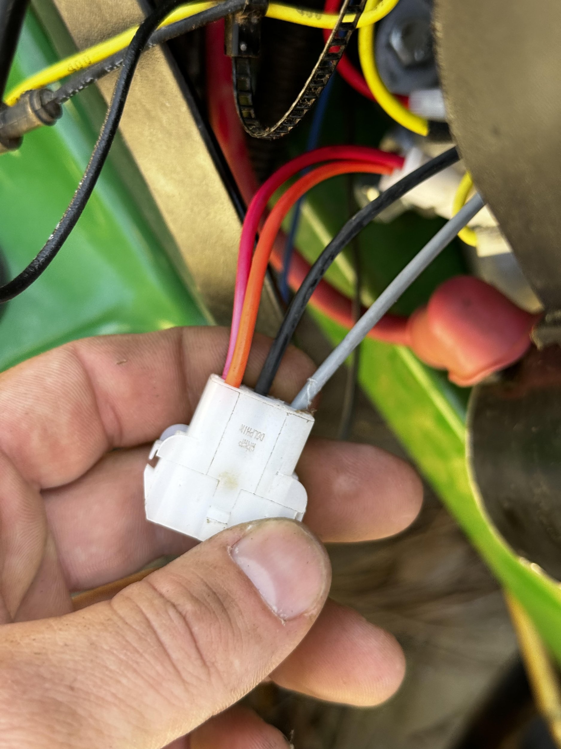

Family member purchased a brand new 19hp EX1900 but did not receive any installation instructions.
Previous motor had 2 wire plug, red and white, while new engine has grey black red and orange.
I've spent a couple hours tracing wires and testing with my voltmeter, but unable to figure out how to properly wire the new motor.
Thank you for your time
/ LT150, installing Briggs & Stratton EX1900 #2
/ LT150, installing Briggs & Stratton EX1900 #3
We have listed below, the wires found on the new Briggs & Stratton single cylinder engines and where they need to be connected to.
RED WIRE - This is your DC cable, it should be connected directly to positive power on your battery. This wire charges your battery.
BLACK WIRE - This is the engine kill switch, It needs to run to an ON/OFF switch and then run to earth. DO NOT CONNECT THIS WIRE TO POSITIVE POWER!
GREY WIRE - This needs to run to an on/off switch and then to positive power on your battery, this controls the carby solenoid for fuel.
ORANGE WIRE (IF FITTED) - Can be connected to headlights or any other accessories
