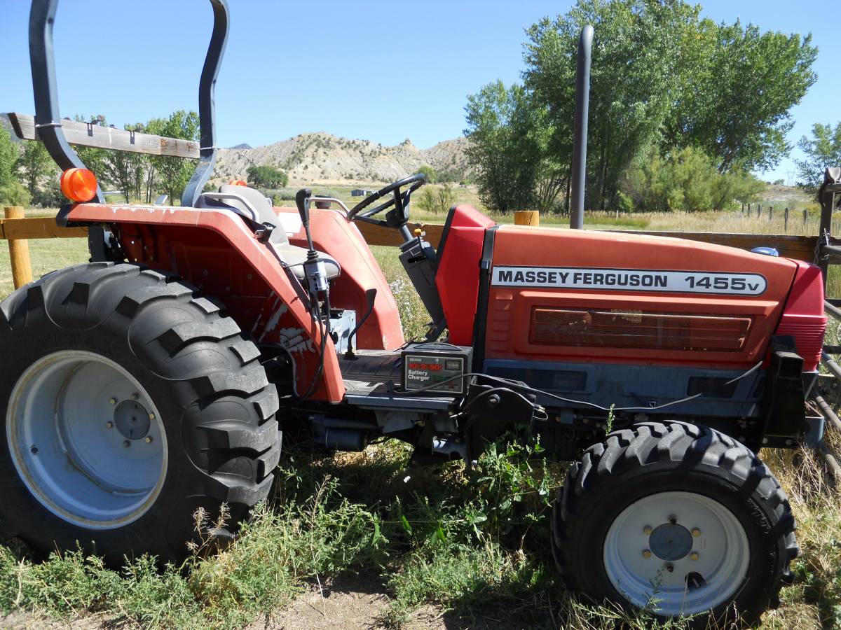

Well, I found a way to avoid the decision of which tractor to buy... Just found a MF1455 on CL for what seems like a good deal. Roughly half what either the XR4140 would have cost me... It needs paint, but paint is cheap. 480 hours. With loader.
Loader lift specs are only slightly below the LS and Branson tractors I was looking at, and it has a higher lift than either, which will be good for lifting beams! Not a turbo, but with 55hp, I think I'll be OK. :)
If it doesn't work out, I'll do a bit of fixing up and trade it in or sell it and get myself a nice new tractor, but I think it'll be fine... About the only ding against it is the lack of rear remotes... I called and IF the kits are still available, they're ~1700 for dual and ~1400 for single... Not gonna happen... But perhaps I can order the block and valves for cheaper, and make the hoses and brackets myself, or adapt some other setup if I really want them. Not worried at this point. :)
For your viewing pleasure:

Congrats, that's like my machine's grandpa! Let us know how it works in action.
Also, when comparing loader specs, don't forget to take into account the relationship between max lift weight and lift height... there are too many variables to be exact, but consider that if Tractor A can lift 1000 lbs to 80" and Tractor B can lift 900 lbs to 90" and Tractor C can lift 800 lbs to 100" ... It's possible that they are all the same "strength" and also possible that (depending on geometry and a myriad other factors) that Tractor C actually has a much stronger loader. Just food for thought.

I custom installed 3 rear remotes & TnT on my L3200 for under $2k. Mine looks better than factory to boot.
You just need to figure out where you can tap into the power beyond loop & get your own valves mounted somewhere nicely. The rest is just getting & routing hoses. Spend some time reading in the hydraulics forum & you'll get up to speed on what you need to know if you are handy.
