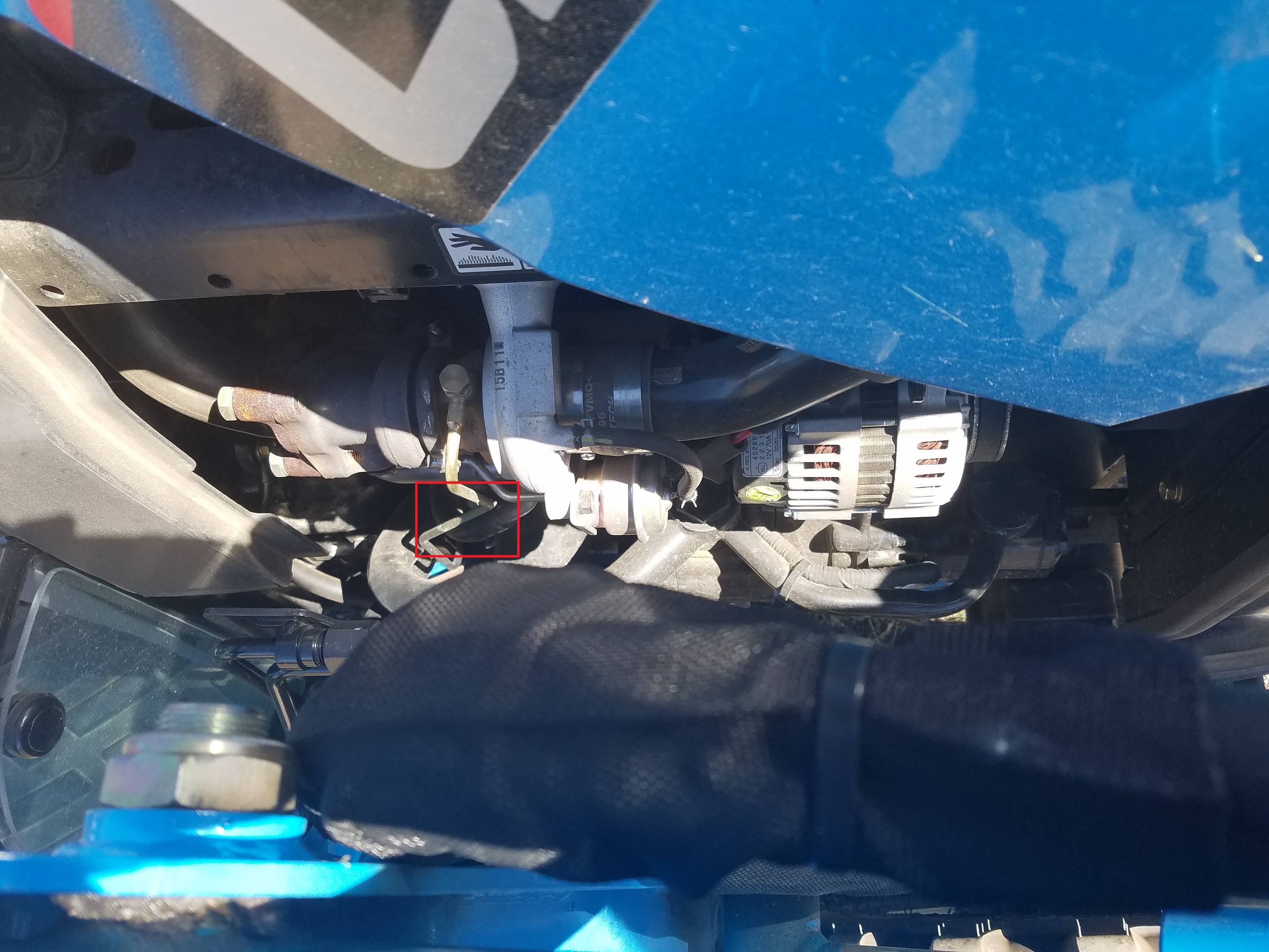

Both TYM & LS fit & finish was less than JD or Kubota. TYM you had to loosen up the brush guard on either side, then pop the hood on the left, then pull off the side panels. Then the dipstick for engine oil is hidden on the right. Sales guy had to lift the loader up so we could do some of that. Horible hood & engine cover design, pretty labor intensive to just get under there. LS you just have to pop the hood on the right, but the dipsitck is buried really well on the left. I can see the engine oil filter, but have no clue how you'd actually remove it without removing the loader & I don't think it the loader is terribly quick to remove. Kubota is easy to get to & everything you need for service is on the left side, although you do have to pull 1 pin on the left side to lay the brush guard forward. JD's hood is like TYMs with only the top opening, but you have to remove a bolt to pull the side panels. It's serviceable without pulling the side panels.
Buried oil filter, below cute tiny turbo:

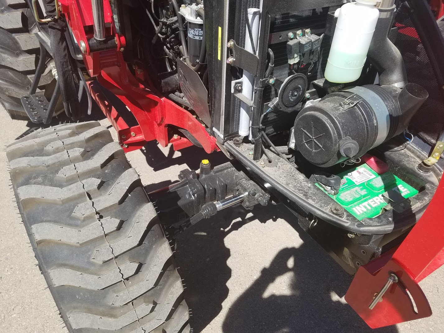

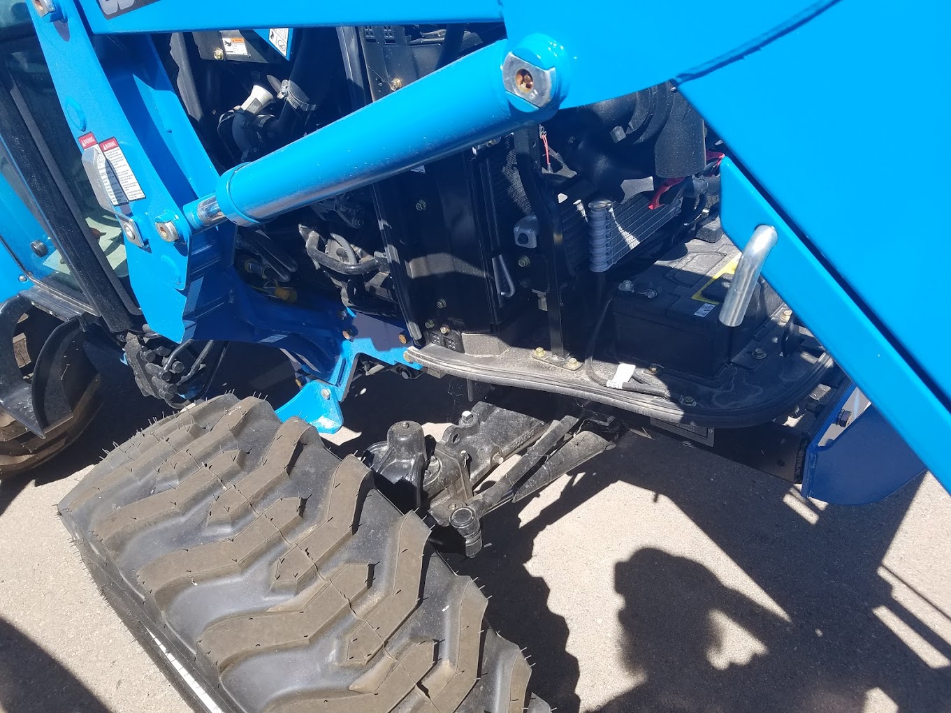

Both LS & TYM have the steering gear in-front of the axle. My L3200 is setup kind of similar where it's a bit more exposed & not protected by the axle itself. I've had to replace a snapped off grease zerk on my L3200 already (side note, Kubota tie rod ends & zerks are freaking tough, took me forever to drill out & re-tab those to put in a new zerk) think a behind the axle setup would be more durable. The Grand Kubota is a similar in-front setup, but shielded a bit better. JD has steering gear behind the axle. I'd be worried about catching a branch in there & doing some damage on the LS & TYM a little, at least the grease zerks being vulnerable to being sheered off again.
