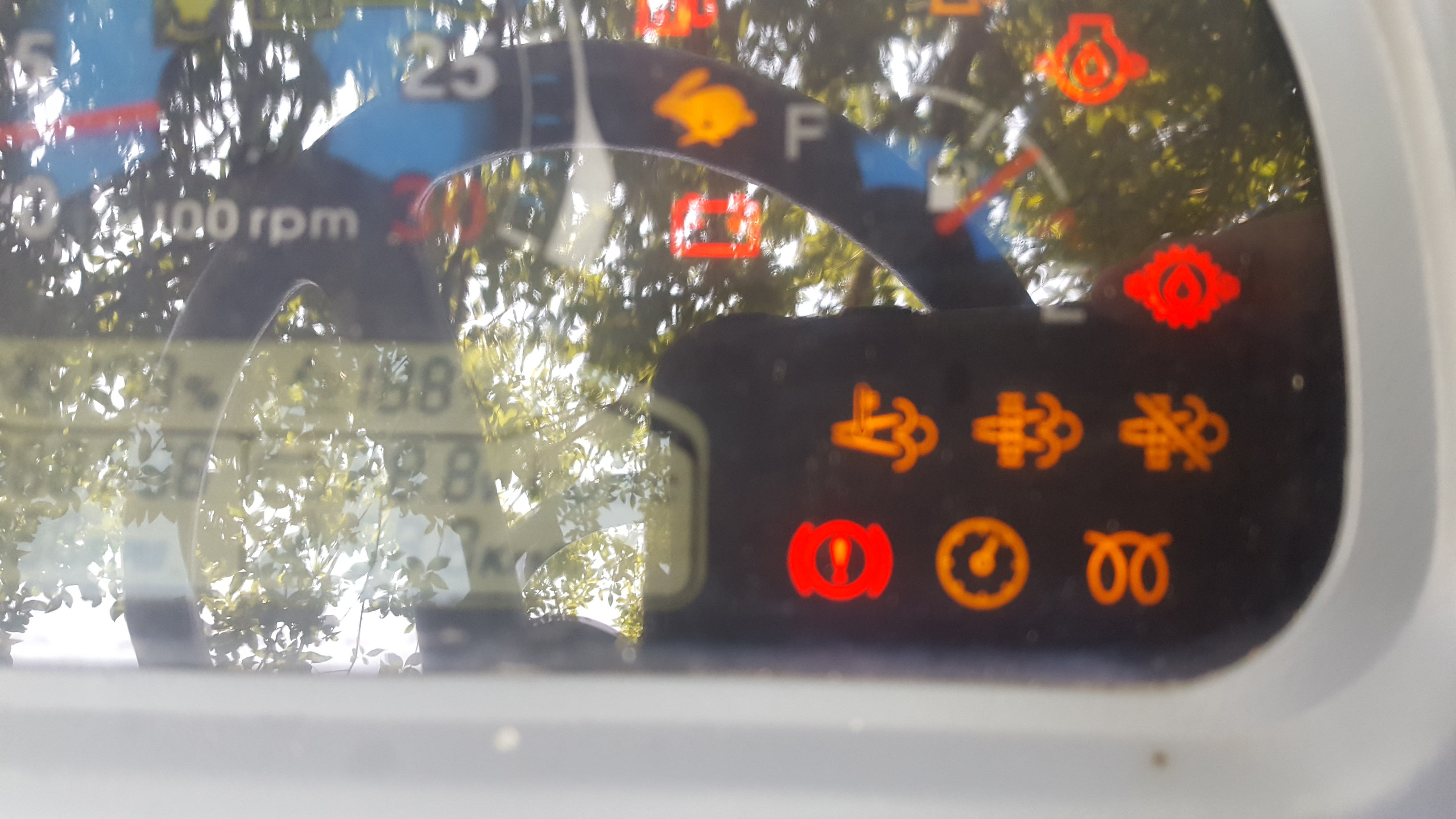

I had a weird thing happen around 21/22hrs. Started getting a weird burning smell, maybe like burning paint but not quite. I noticed one of the regen lights (the one with the thermometer) was on and believed I had just experienced a regen. I'm still not sure if I did or not. After the light went away, so did the bad smell. I came here to the forum and discussed it a bit; found out that a regen involves two lights on at the same time. Yesterday around 30hrs I noticed another burning smell not quite like the first. I was waiting for it to do regen but it didn't, just kept stinking. So I did a forced regen. I did it out of curiosity. Not sure if that's bad for it or not. But the smell is gone now.

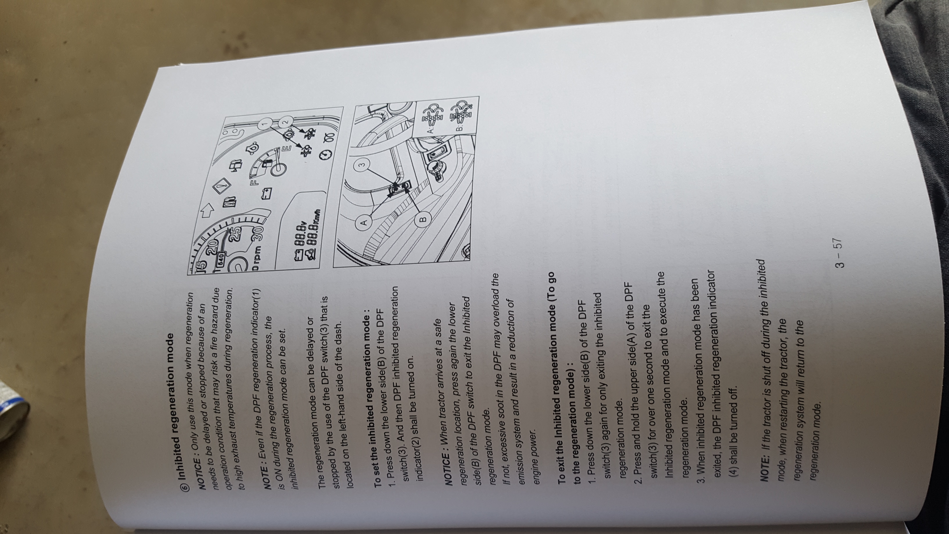

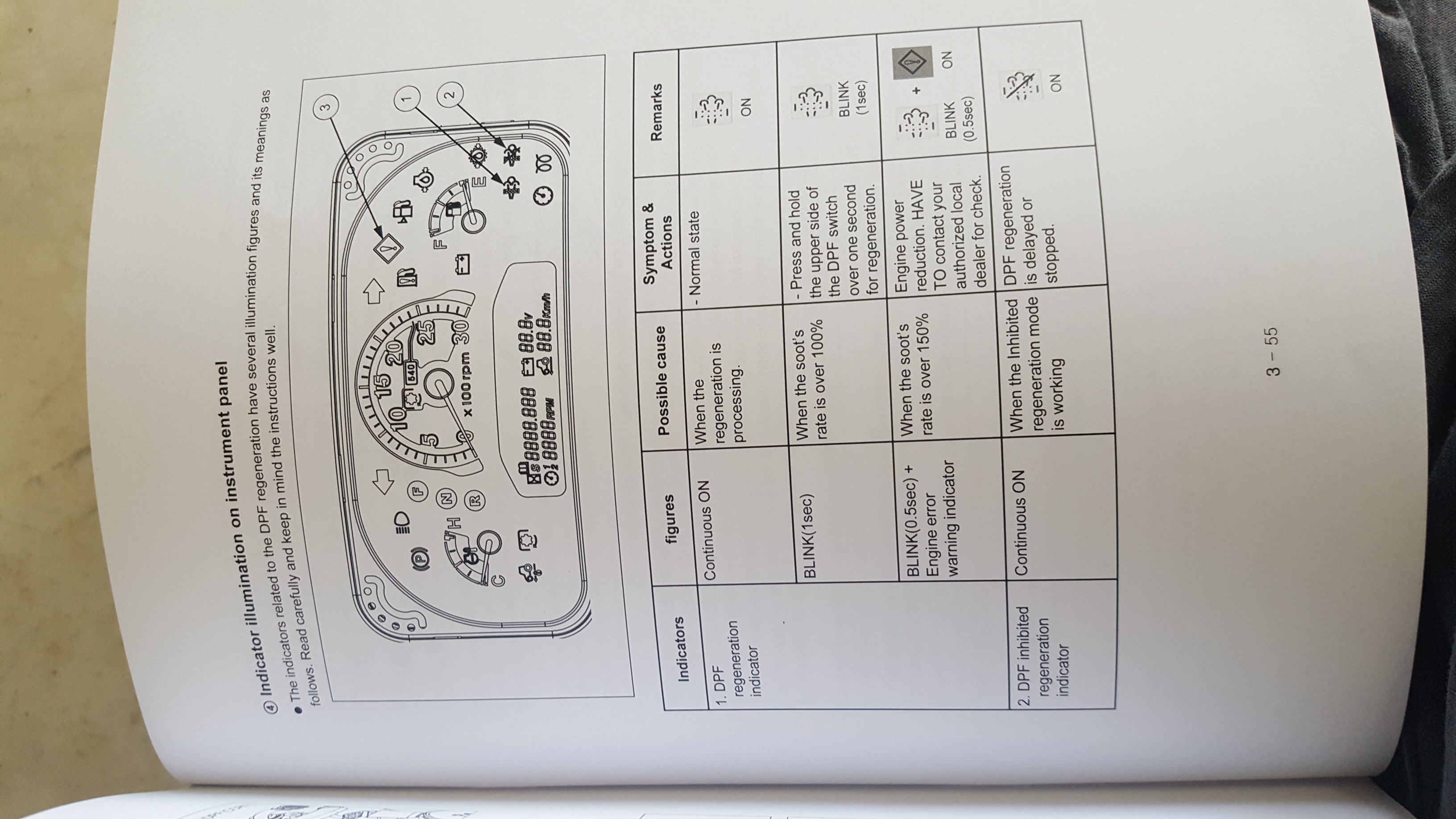

According to my manual page 3-55 (XR4100) you should only have the dog regeneration indicator on in most conditions-if you have more than one on or the dpf regen is blinking the tractor is telling you something about your DOC and DPF

Not according to the XR4100 series op manual pages 3-55 through 3-57. According to the manual the only time two indications (one of which is the regen active indication) are on is when you have a soot rate over 150%-in which case the engine error warning indicator will also light and power will be reduced.

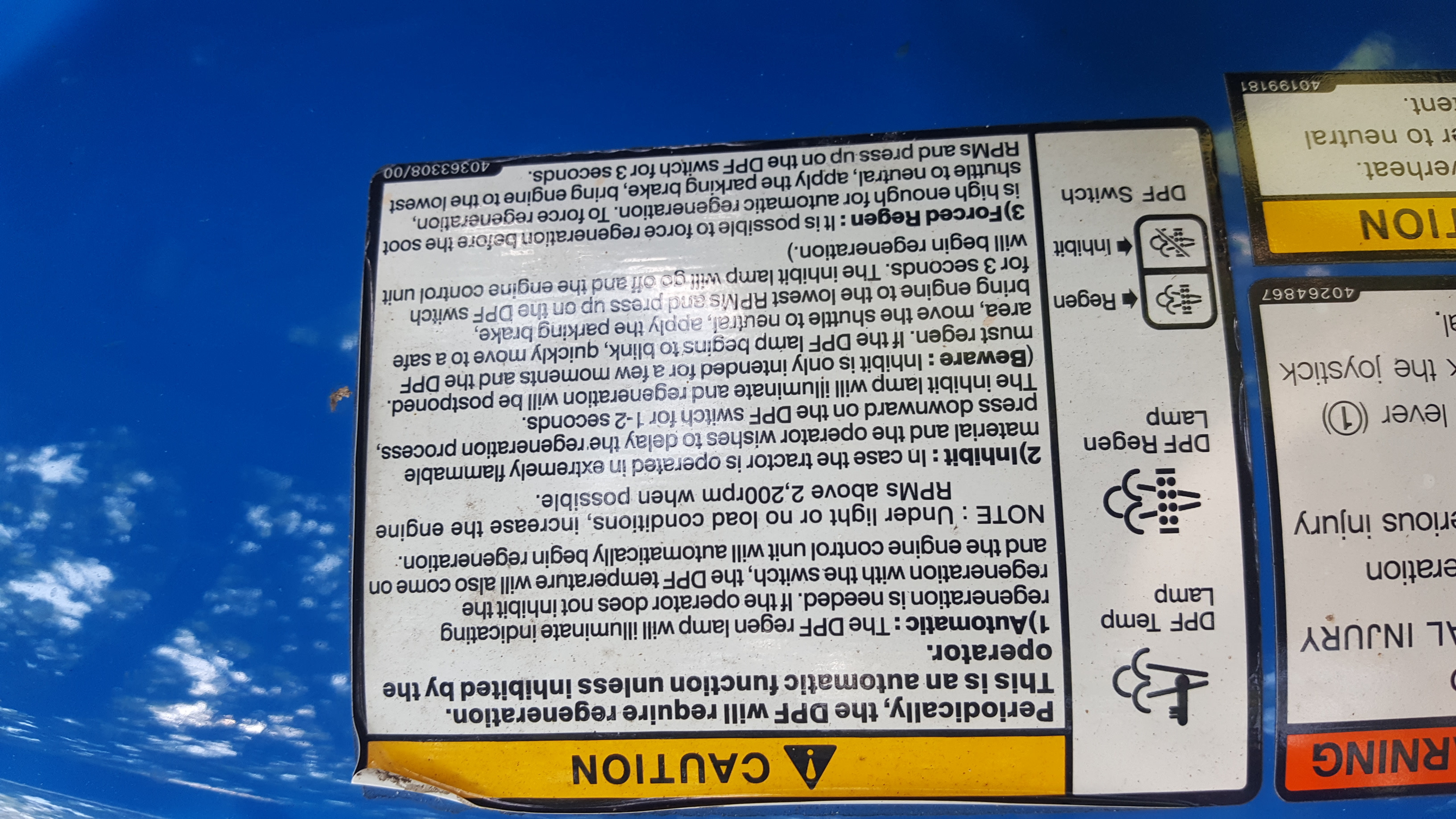

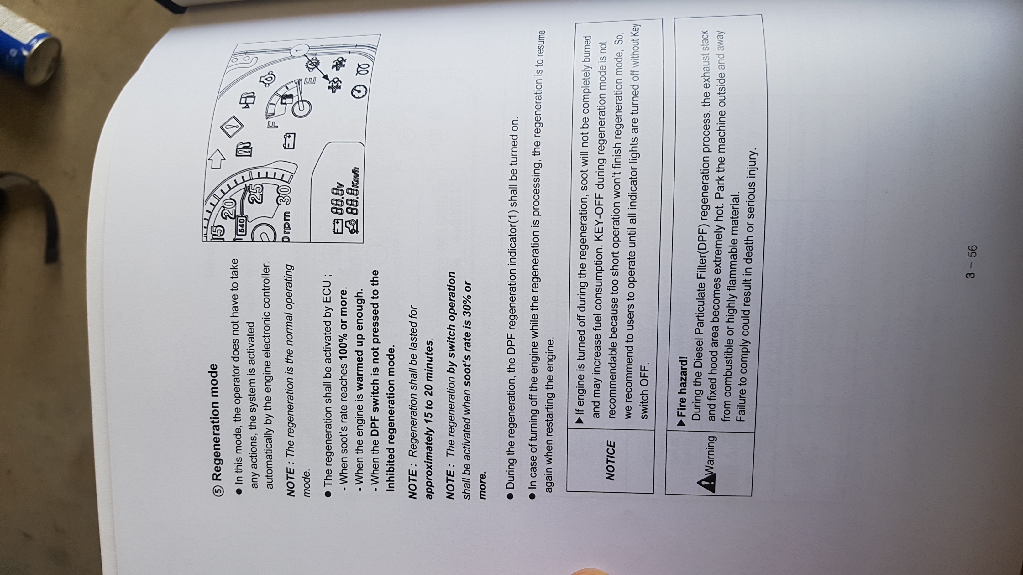

My manual makes ZERO reference to the DPF temp lamp. Only the regen and regen inhibit lamp. And for a 150% soot condition it says the DPF lamp will flash fast.
The original manual for my tractor was lost by the dealer before I purchased the tractor; this one I have was ordered by the dealer two months ago, directly from LS, and then forwarded to me. To me, this means it should be the most recent REV of the manual. But the date on it is 2015. I knew it must be dated information (not showing all the lamps, plus other issues) but I assumed it just hadn't been updated by LS since 2015. Now the things you're quoting from your manual don't match what's in my manual, and I wonder if you've got a more recent copy than I do.
The only indication I have to the function of the DPF temp lamp is the sticker on the fender, which ironically suggests the opposite of the sequence quoted below:
rlgustafson said:
Re: LS XR4140H Regen intervals
The first light comes on to indicate the DPF is being heated up. When the second light comes on the regen. cycle has started. When the cycle is over, both lights go out.
According to the sticker, Regen lamp comes on when it needs to regen, temp lamp comes on later when it's up to temp to perform its intended regen, and then it regens.
I can't confirm the sequence suggested in my manual, or the one in GSVette's manual, or the one on the sticker, OR Gustafson's observations. So far (only 30hrs) my only experience with auto regen was when the DPF temp lamp alone came on and I'm still not sure if regen occurred.
It would be nice if the documentation provided by LS was clear, consistent, and accurate.

My manual makes ZERO reference to the DPF temp lamp. Only the regen and regen inhibit lamp. And for a 150% soot condition it says the DOG lamp will flash fast.
The only indication I have to the function of the DPF temp lamp is the sticker on the fender, which ironically suggests the opposite sequence quoted below:
I can't confirm the sequence suggested in my manual, or the one in GSVette's manual, or the one on the sticker, OR Gustafson's statement. So far (only 30hrs) my only experience with auto regen was when the DPF temp lamp alone came on and I'm still not sure if regen occurred.
