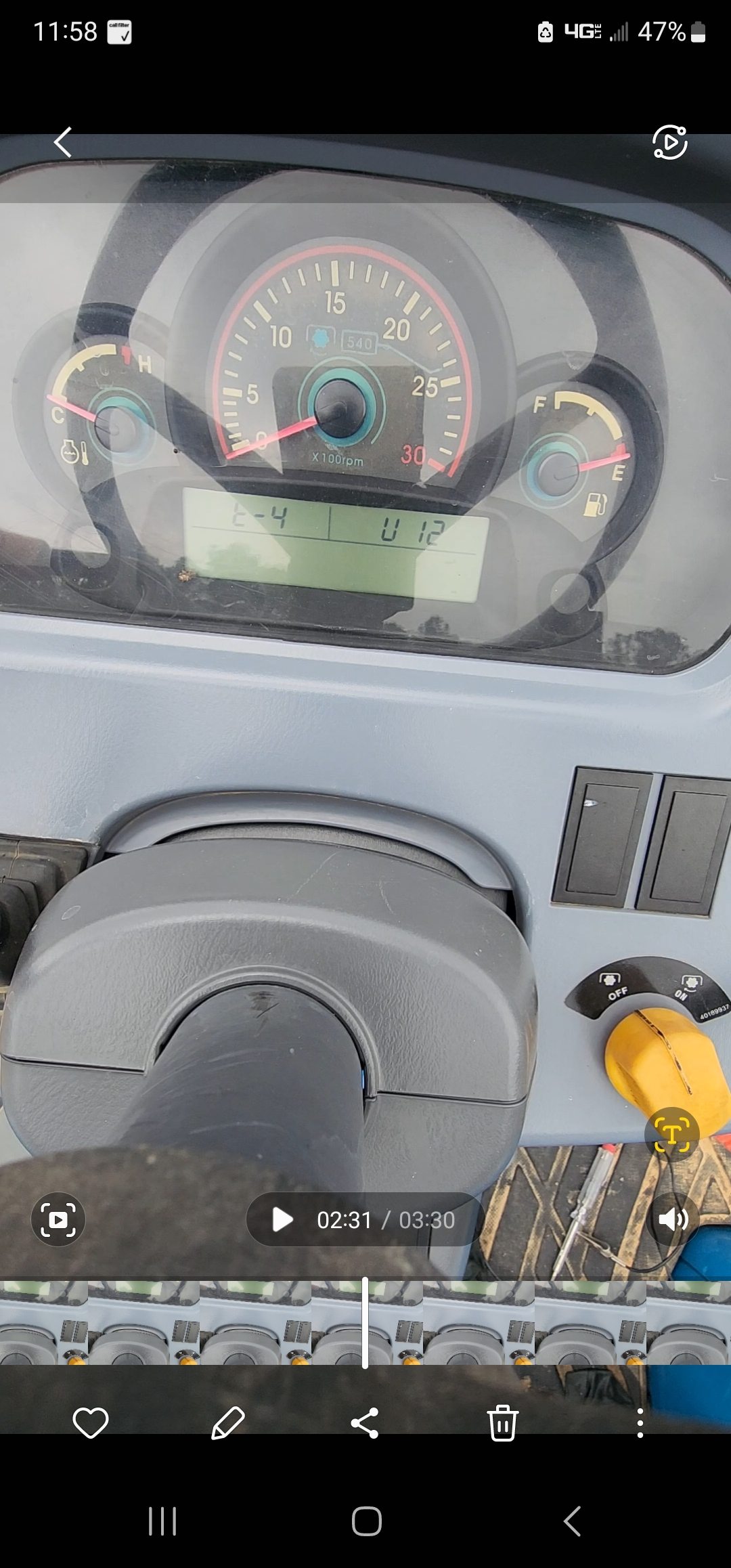

Battery died so I changed it out. With new battery in dash will not light up checked all safety switchs that I could find. As the emergency brake seat clutch pushed in. Even the 60amp fuse along with all the other fuses. First tractor to have so any help would be nice. I bought this tractor with 136 hrs on it and it's a 2016 model.

I sprayed contact cleaner on all connections then went over to make sure they was all tight. Then with a pen light voltage detector. Traced the hot from the battery to the starter to the alternator to the key ignition switch. Which it had power all the way through.

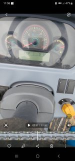

Still no dash lights on. I haven't got back to messing with it yet. Just had a baby boy.
   / Ls xg3032
Now this is showing up
