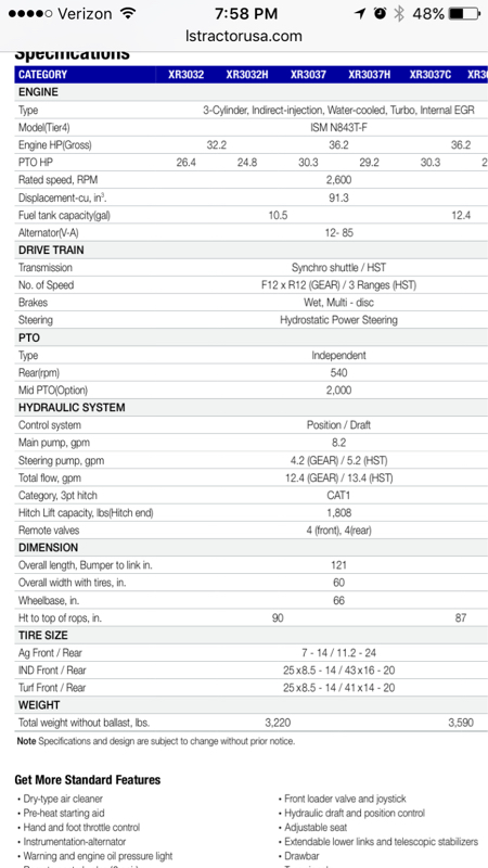

I have the XR3037HC cab model and a few of your numbers are off.
The XR3037HC with R4's is 66" wide not 60" unless maybe the one you looked at had R1's.
XR3037HC weighs 3605 plus 1056 for the loader totals 4661Lb.
It has 2 remotes, not 4. 2 ports per remote.
It does have telescoping lower links and SSQA loader bucket which is also 66" wide.
XR3037HC has the Shibaura engine which regens about every 5 hours, 3135 has the new LS engine and regens about every 50 hours. The XR's are what LS calls premium tractors, the XG has Shibaura engine and fewer standard options.

I'm not picking on the OP either. There ARE 4 remote ports or fittings to plug into. each pair is controlled by one lever. IMO that is 2 remotes.
This what prompted me to put 4 on my sheet. I understood that to mean 2 pair, but I do appreciate the "clarifications". It also shows the width at 60".
/ LS vs. Kubota questions #28
Unless something has changed in the past 2 years mine only came with remotes on the rear as pictured in my last post. Front remotes were available but were an option. Maybe that is now a standard feature but the official LS website only shows rear remotes as standard on the XR series. Front remotes may have been added by the dealer which is a 1K option.
Not sure where you got your comparison chart from.
As far as width I measured mine when purchased. 66" wide bucket and rear tire width with R4's.
Weights I posted were taken from the owners manual and loader manual.

Unless something has changed in the past 2 years mine only came with remotes on the rear as pictured in my last post. Front remotes were available but were an option. Maybe that is now a standard feature but the official LS website only shows rear remotes as standard on the XR series. Front remotes may have been added by the dealer which is a 1K option. Not sure where you got your comparison chart from. As far as width I measured mine when purchased. 66" wide bucket and rear tire width with R4's. Weights I posted were taken from the owners manual and loader manual.
That pic was from the LS site.
I went to the official site for LS (lstractorusa.com) and didn't see any comparison chart like yours. Hope you find the tractor you need..

I went to the official site for LS (lstractorusa.com) and didn't see any comparison chart like yours. Hope you find the tractor you need.. I forgot to ask, was the Kubota trade in quote for your tractor as is. And you may want to consider a larger tractor other mentioned.
It's directly from the .pdf brochure that you can click on to download when you navigate to the XR3037H page on the LS website.

Found it. Thanks, its a different brochure from when I bought mine. That's a great deal IMO if you can get front and rear remotes included per the brochure. You may want to check the price difference moving up to the 4000 series.
