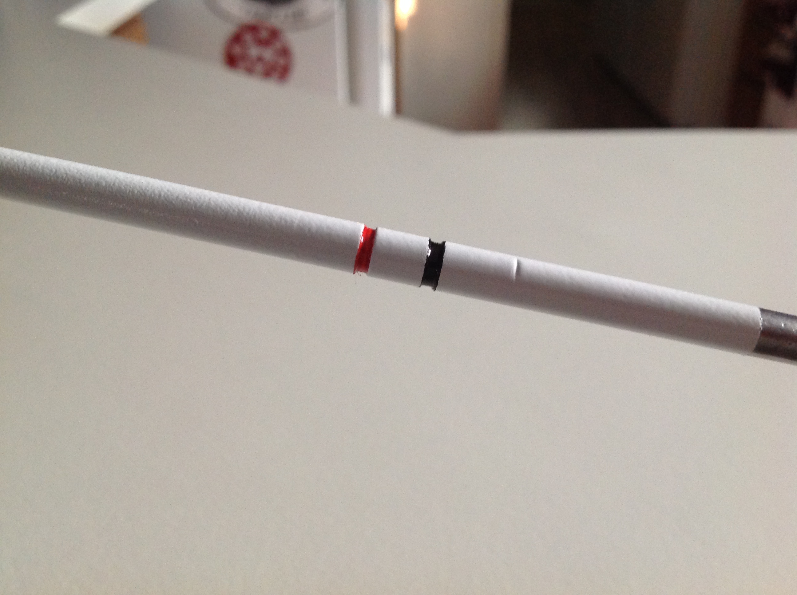

Should be able to find a paint or coating that would hold up or you could add a sleeve near the top of the tube to prevent the rod from rubbing or you could reduce the diameter of the tip of the rod slightly where the paint wouldn't rub off.
Here you go "Doofy". I removed the indicator rod and took it to my friend with a lathe, he cut a .020" deep groove at my two indicator marks. I then repainted it and can't wait to put it back on. Paint can't rub off now. Just trying different things.
Thanks for the idea. We're improving our tractors by "Committee" with all great idea's presented here.
Very nice! Let us know how it works. My eye sight is getting so poor I probably would have made them just a little bit wider.

I really wanted more like 3/16" to a 1/4" in groove as you said. But my friend set it up and had it cut before I added any input. At that point I didn't want to get picky about it. I have lot's of 1/4" rod and can play and play. The end run on this may be just cut the rod flush at the black mark. When it emerges from the end of the tube it's level. Simple. But for now it looks kind of fancy, white, multi-color and when I show it off there is something going on there. But a flush indicator is where I may end up with all this. But I'm having fun and sharing for everyone to choose what works best for them.
