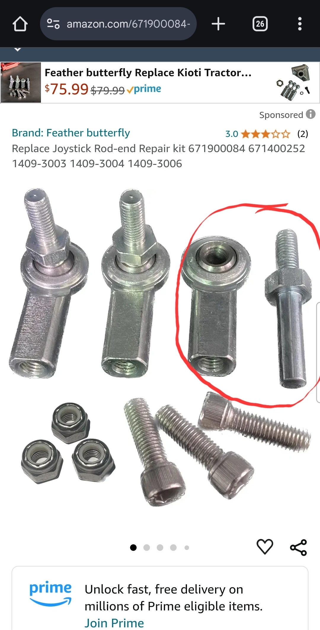

Hey so has anyone found an aftermarket repair for these joystick rods? My loader can't curl anymore and I see the rod and slider joint are worn. I can order through my dealer, but they are very far away. Amazon shows several kits as the three piece set, but they are 1/4" threads, so I'd have to modify a bit. Any help is appreciated. Thanks.

I am thinking about ordering this. 1/4" is a tick bigger so I may have to drill out the loader mount where the three bolts go through.

I've gone through their website and for the spherical end alone, they have like a dozen choices in m6x1.0. But i was not able to find the little slide shaft that it engages. Maybe I'm just struggling with their selection?
Straight pin to fit the eye and your post. I opted to convert to heim type joints and it works well so far.

LS dealer says national back order. I ended up getting that SAE kit so I'll follow up on how it goes...
   / Ls mt122 loader joystick rod repair
OK so the sae kit was just a bit off for sizes. So I dug deeper. I think the shifter was bumped out of adjustment. I loosened the jam nut, then moved the shifter away from the steering wheel, and locked it in. Good as new. I can't believe I didn't think of trying this at first glance. Thanks for the replies yall!
