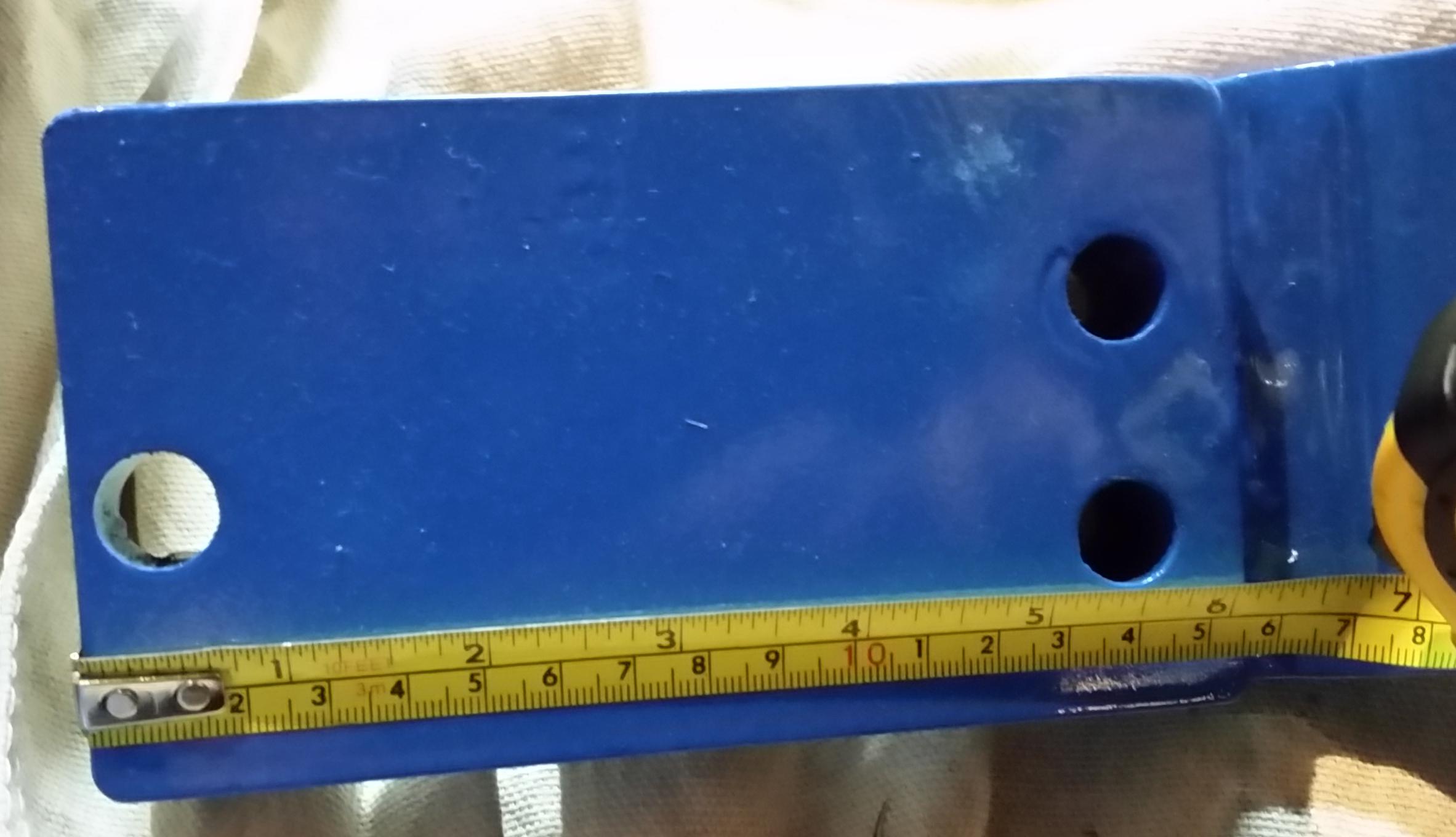

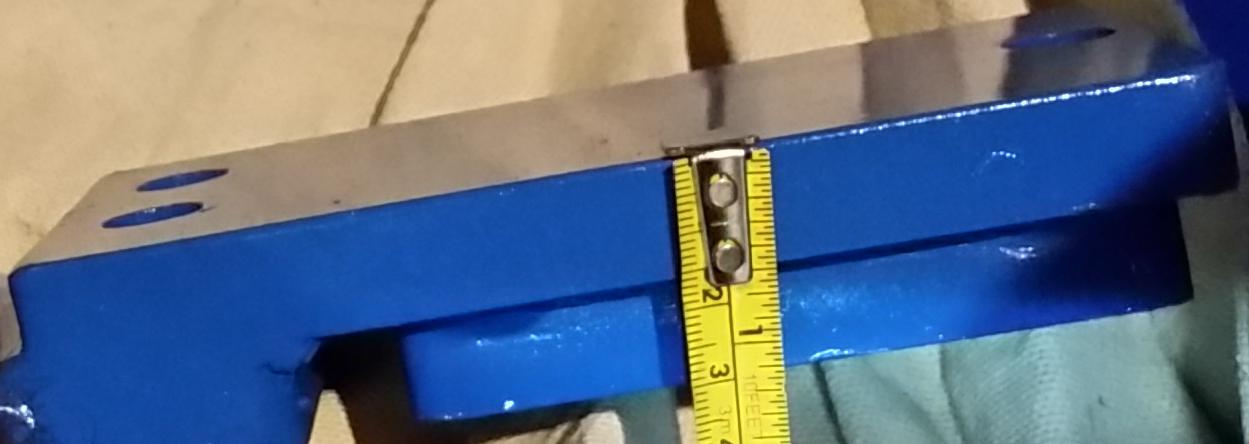

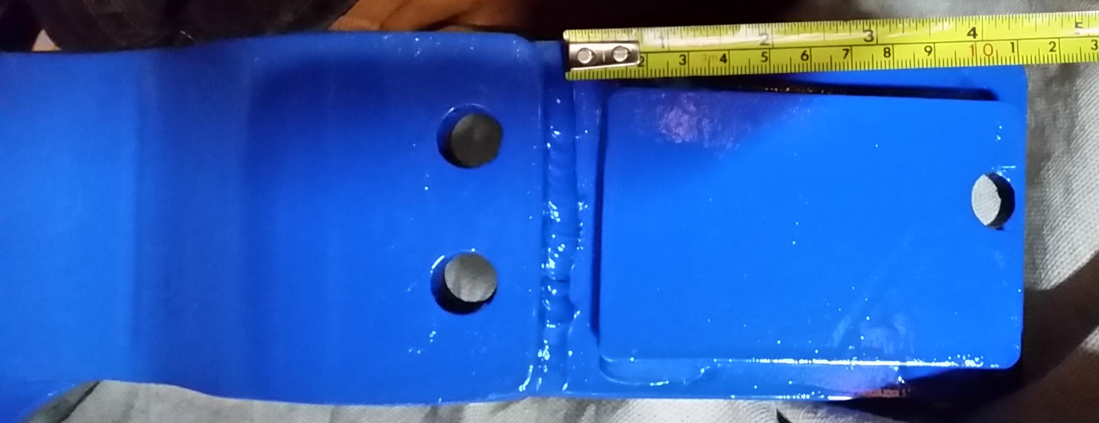

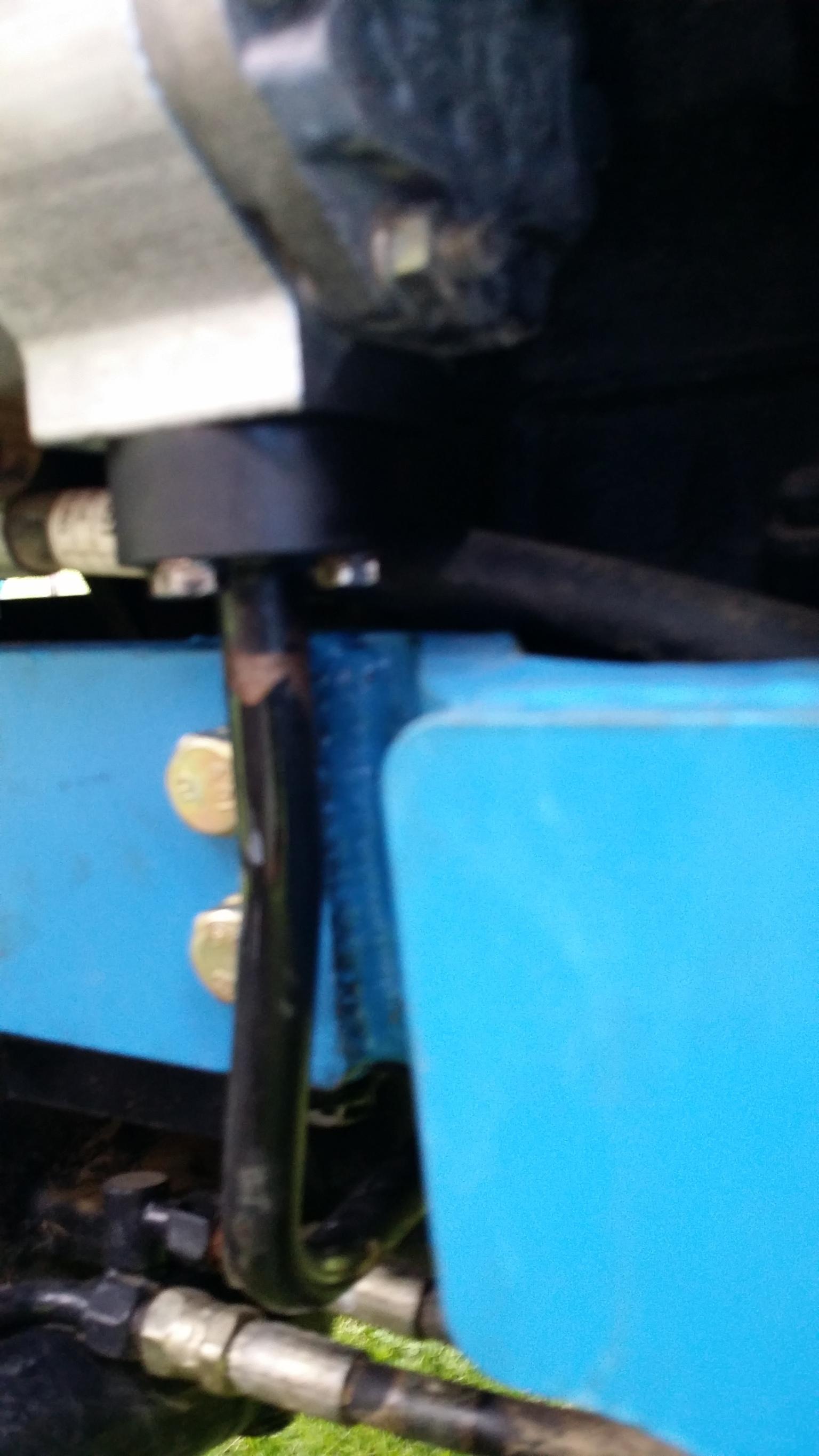

If you don't get any satisfaction ... here are pictures of the reinforcing plate in case you have to take matters into your own hands (get a welding or machine shop to make parts if they are too hard to find/get or cost too much $$$):
Inside view:
Outside view:
View from top:
... if you look back in this thread at the picture of the crack in the frame, you will see a single bolt hole about 5 inches in front of where the original FEL mounts ends ... that's how far forward the reinforcing kit on the FEL extends. Looks like the fix is to extend the FEL mount to be forward of that horizontal cross member weld in the frame.

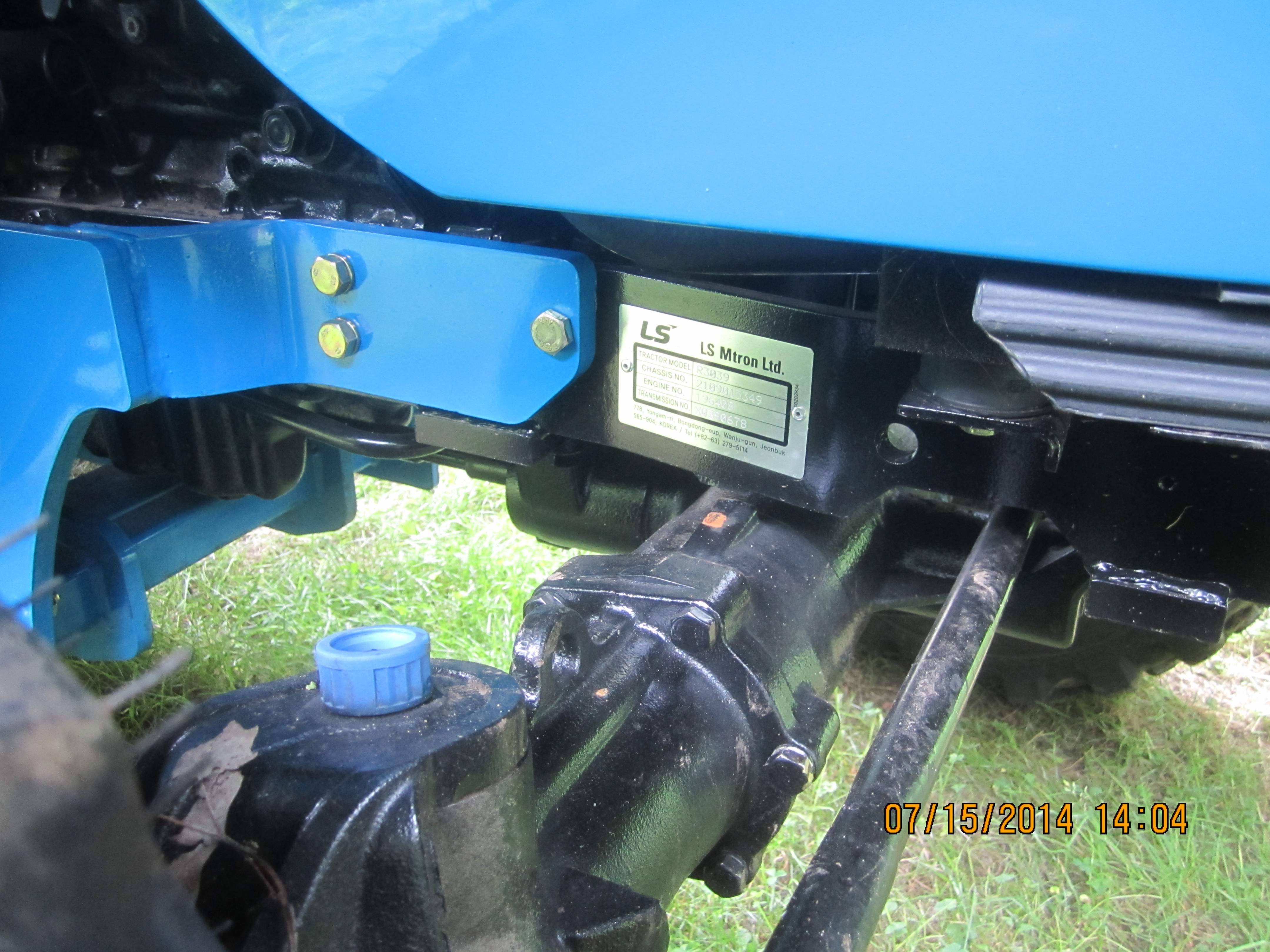

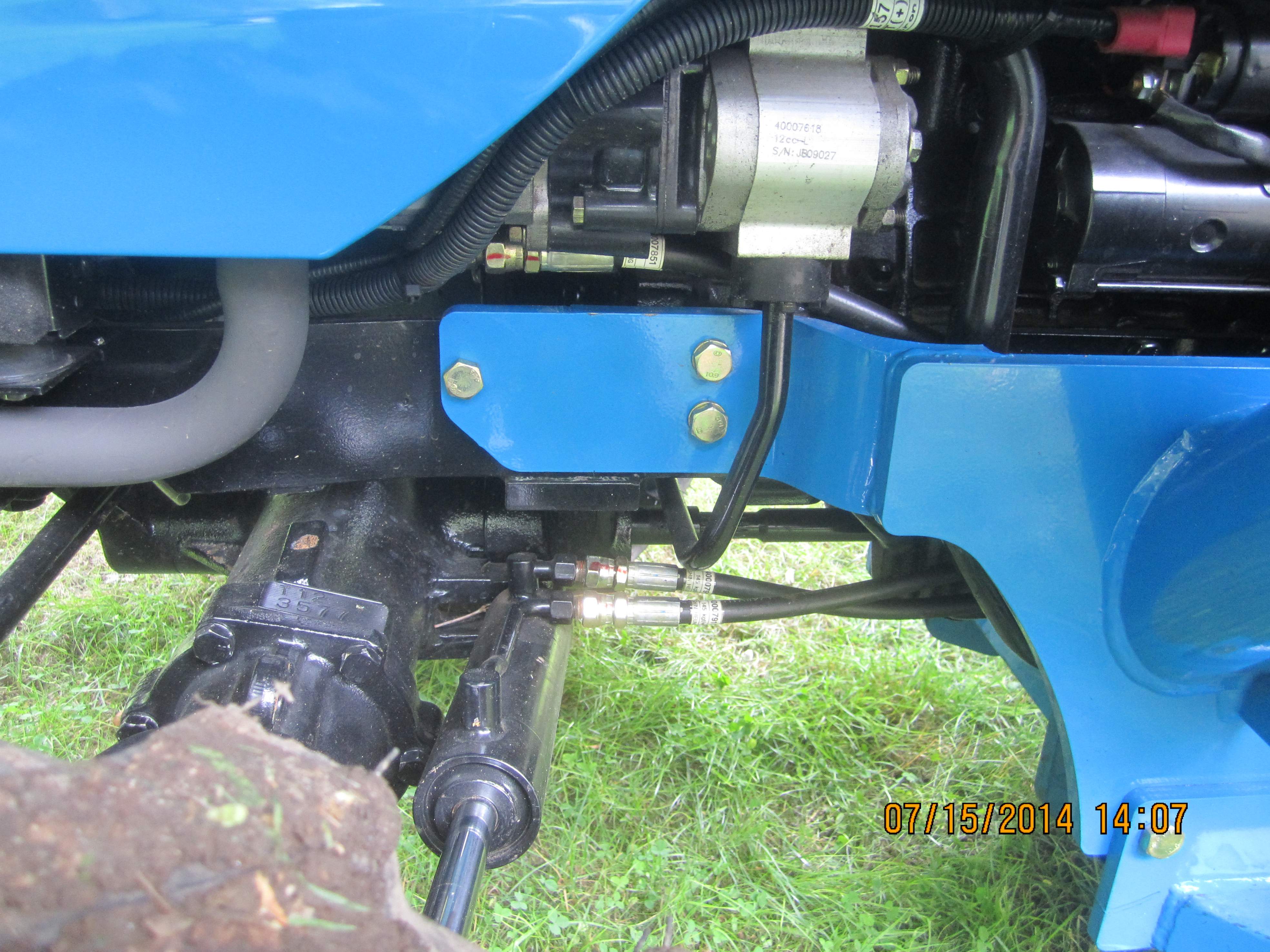

Verdict is in....
They picked up my tractor early yestarday - sadly it sat on their lot all day, and didnt go in the shop until this morning :confused2: bummed, since I could have used it!
Anyway, they delivered it back tonight about 4:30!
When I stopped in yesterday afternoon to check on it, I was able to skim some more info. Seems my tractor had the latest frame design upgrade already. Not good since I managed to break it! But he said the new loader brackets should solve the issue. He said (and is evident from what I see now) that they bolt the new brackets in place, then tack weld them to the existing loader frame. Remove entire loader frame, and weld it properly. (see pictures).
Now - my service guy agrees with my concept, that its likely there was something metallurgical wrong with the original frame. Something that was maybe a 'bad batch' issue. He said he has only see one other 'new' frame broken, and it was exactly the same as mine, crack starting right at the edge of the weld like that. From what I understood, the older frames exhibited a different break....
View attachment 382147 View attachment 382146 View attachment 382145
I just noticed something in these pictures I didn't see the first time ... the bolts are grade 10.9 (basically grade 8). The bolts they put in mine match the other frame bolts going into the engine block which are all 8.8 type bolts. I think the max torque on those 8.8 bolts is around 60 ft. lbs.

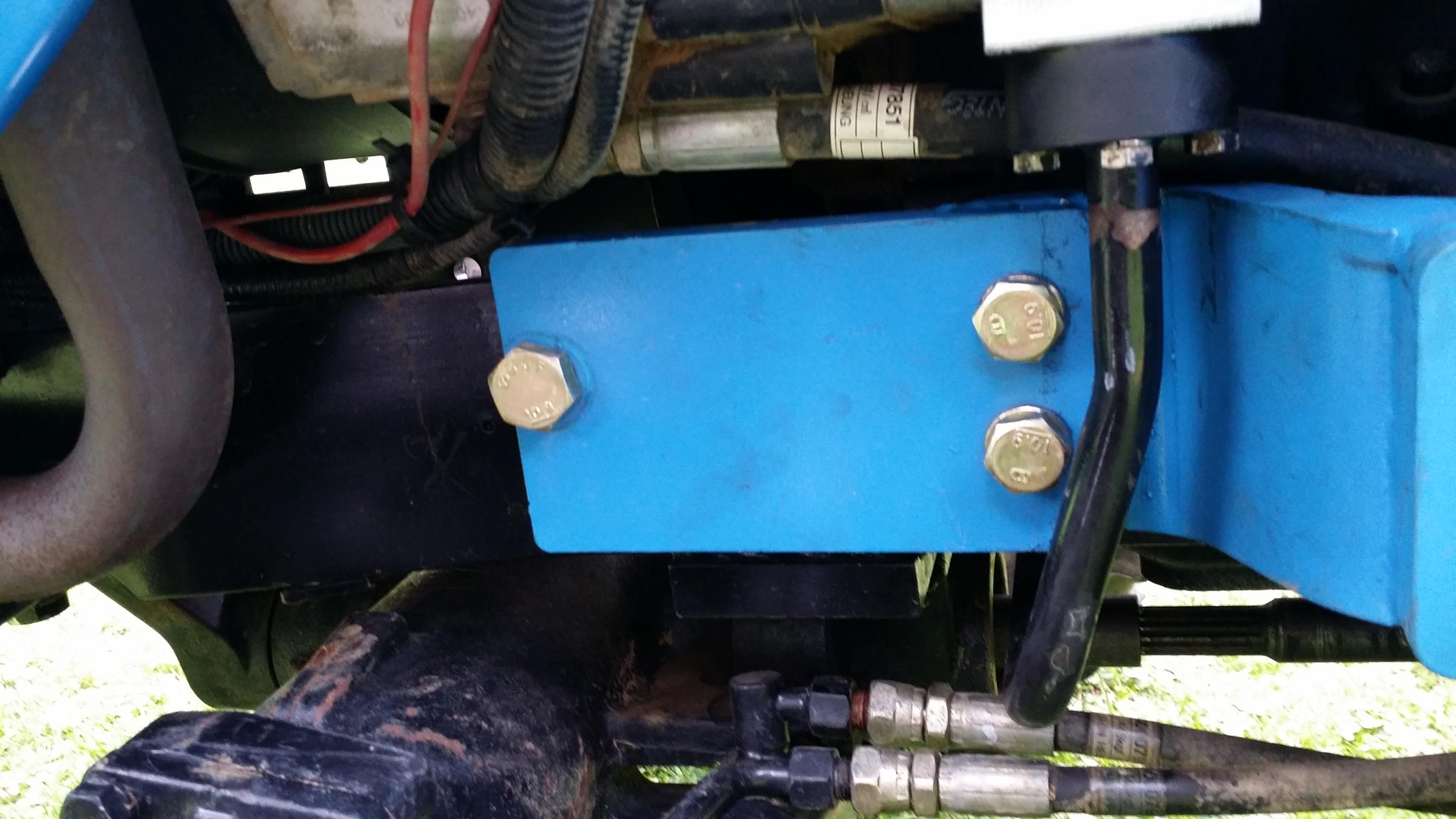

View attachment 382932View attachment 382933 It appears that the one I just purchased has had the same procedure done to it. I hope the pictures come out.
I was comparing to the pictures of magnus580. I think like some one else mentioned the loader puts a lot of stress on that area and it needs beefing up. Now that I am looking closer, it looks like mine is a little different. But same idea. I am confident the redesign/ repair will resolve the problem.
Also I know it is a frame, but to me it is about 1/4 flat stock tying the front end together as a reinforcement. Some tractors don't have that and there is no frame / reinforcement, just the components bolted together. But I am no expert.
My feeling is it was a design flaw and the redesign of the loader brackets will solve the problem however I am going to be watching this closely.
... Hmm, this one also has 10.9 bolts. I wonder if the torque spec was changed too ...
/ LS Frame Issue Video #160
Can someone verify the reinforcing kit bolts are 10.9 grade and is the torque 76 ft. Lbs.?
For obvious reasons, I don't want to ask my dealer (who used 8.8 grade bolts at 55 ft. lbs.) who did my repair.
I'm afraid to switch to 10.9 grade bolts and that torque without knowing that's the latest spec. Don't want strip the casting.
