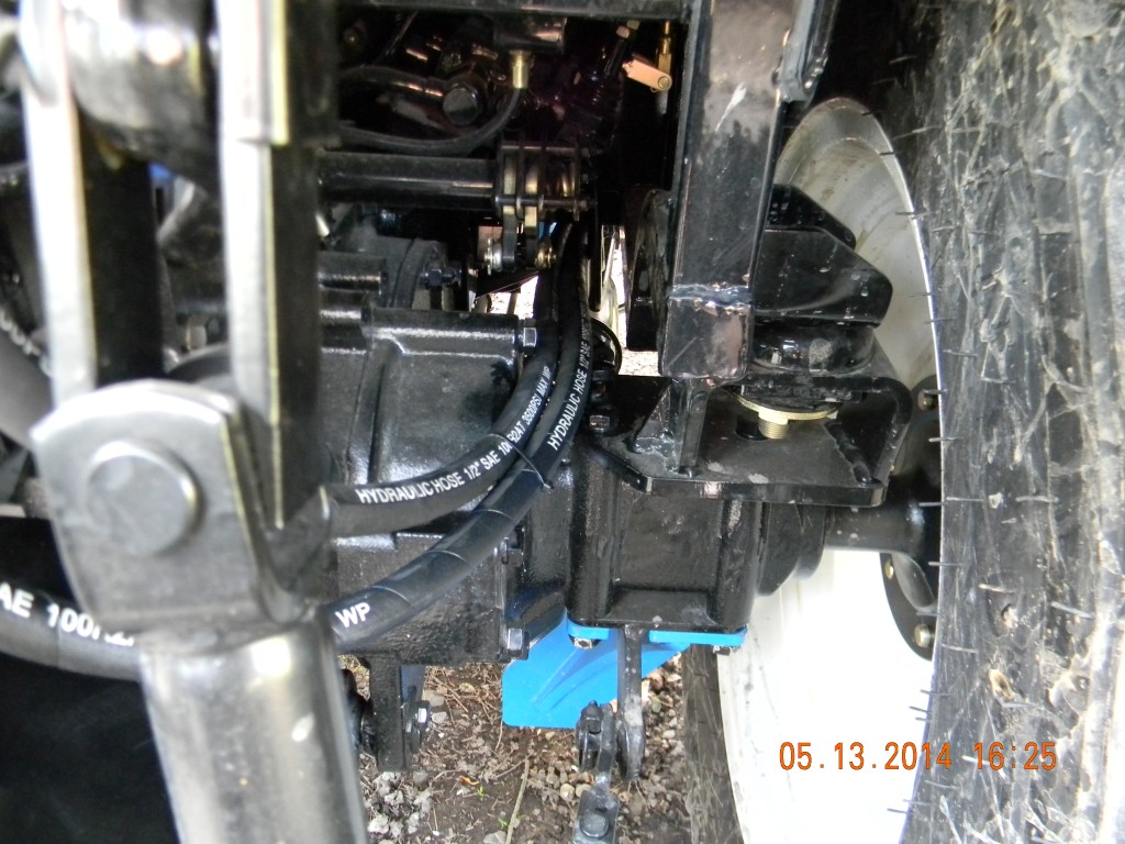

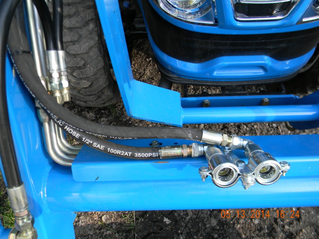

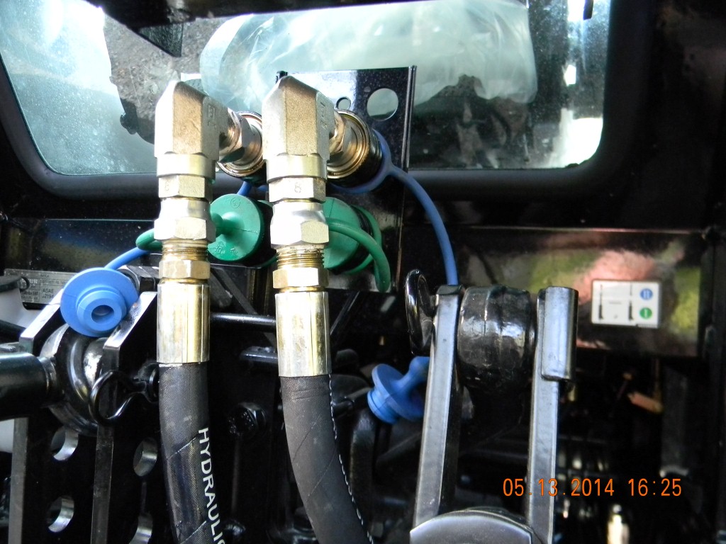

I just ran my hoses this past weekend. I used 1/2" 2 wire 3000 PSI hose. Here is a list of parts available at your local TSC store.
You will have to measure for the length hose you will need. I don't have any front hydraulic attachments yet just wanted to have the lines run for when I do. You can use 1/2" or 3/8" line but you have to bush the 3/8" hose up to 1/2" male pipe to fit the couplers.
My list
2- SKU# 1819884 - 168" (14') long 1/2" 2 wire 3000 PSI hose w/ male to male pipe each end
1 - 5006-4 - Double breakaway clamp with bracket to hold the front couplers
4 - SKU#1818626 - 1/2" male to 1/2" female swivel (or 1818105 1/2" male to 1/2" female 90's, your choice)
6 - SKU# 1824407 - VP4200-4 (or VP4000-4 your choice) 1/2" pioneer 3000 PSI coupler sets. (I bought some extra)
I also bought a 4' jumper hose I used to bleed the the lines. I can later use the 4' hose to connect to a front cylinder when I get something to install that needs hydraulics. I still have to get the rubber caps to plug in the couplers when not in use. They were out of stock.
I ran the lines under the tractor in between other lines and up to the front. I just used zip ties about every foot or so front to back. If your tractor is HST make sure you don't run the lines under where the pedals arms. I ran mine between the fwd and rev arms.

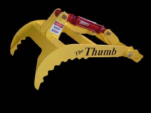

I'd like to know the travel also. It will be pretty much the same on any of his thumbs since they all use the same cylinder. Only problem I see is the cyl. only has a 6" stroke. I haven't found a video of one installed on anything yet. I'm sure it will close down on the bucket but unsure how far between the forks it will go with only a 6" stroke. I'd hate to buy one only to have to replace the cyl. with a longer stroke one and maybe relocate the mounting hole locations.
/ ls 4047 grapple #26
I suppose if it didn't close down far enough I could weld some extension "teeth" on the end of it. When it is retracted I want it mounted vertical so it is out of the way for picking up pallets.
/ ls 4047 grapple #27
Here's another one I found that looks well built. It's about $675. incl shipping. It also uses a 6" stroke cyl. but a larger dia piston and the tines are 1/2" thick.
