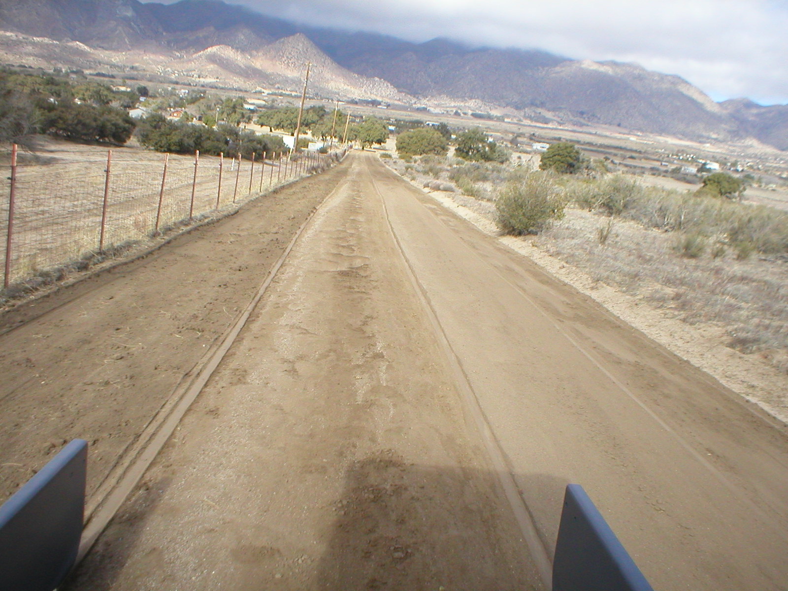

/ LPGS sizing #6
I have a 75hp, 12,000lb tractor, I use a 7' 1400lb LPGS. A perfect match for my applications. If I had to purchase a new LPGS today, I would most likely get one of these in the industrial series with NO HYDRAULICS.
The majority of my roads take 3-4 passes and would be the same if I had an 8' unit. So an 8' unit would serve me no purpose and just work the tractor that much harder.
Good luck with your decision

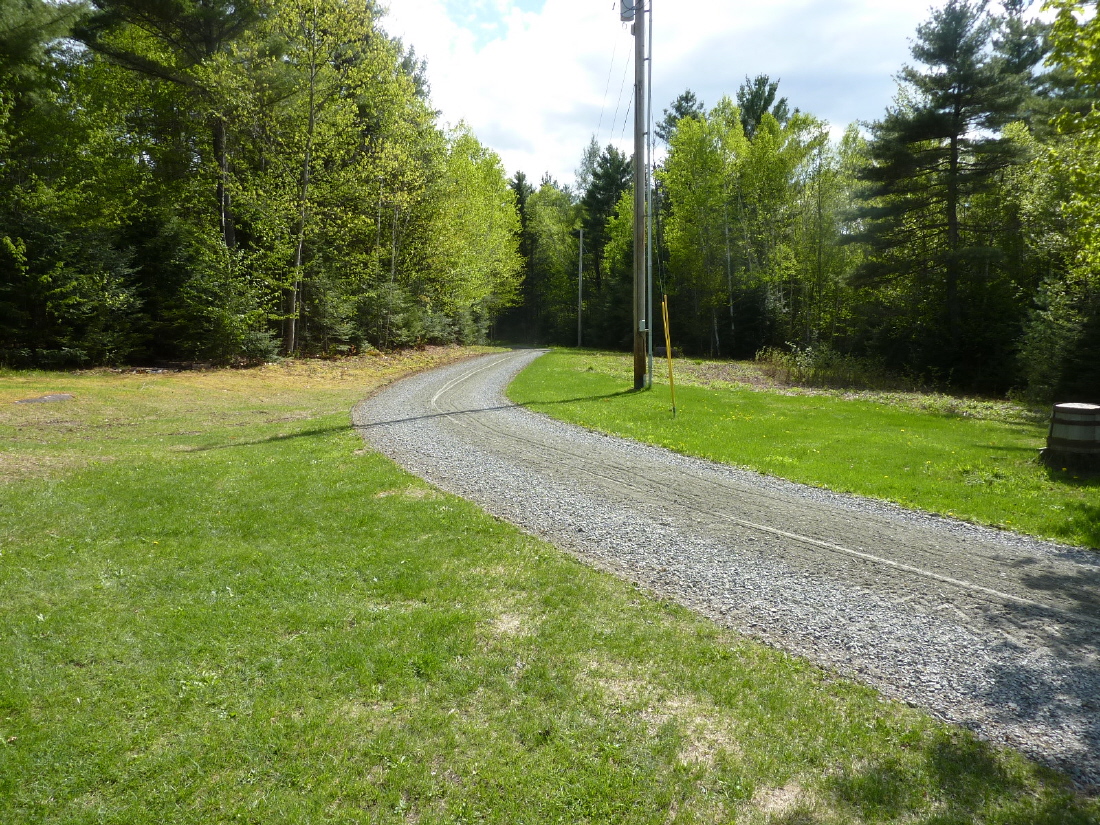

/ LPGS sizing #8

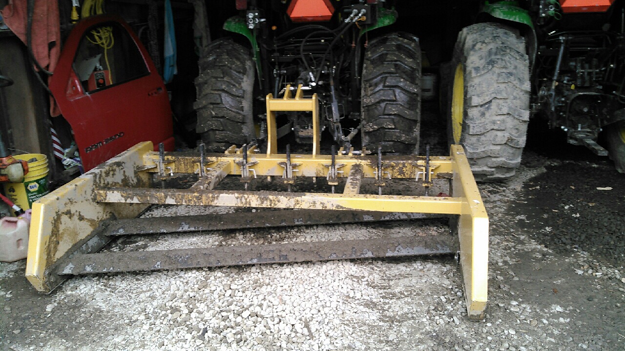

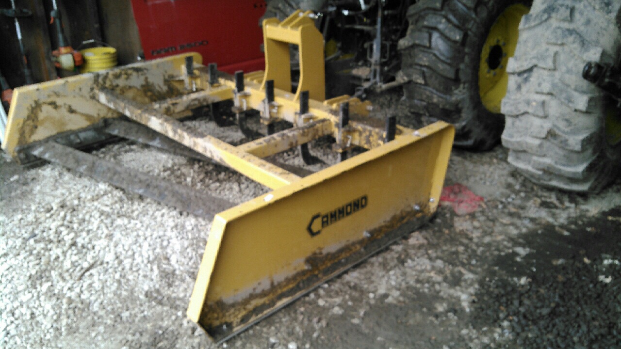

I have a 7' cammond industrial that weighs 935 lb that I pull with a deere 4720 and if I get it full it will all most run out of traction in four wheel drive . I have loaded tires and the loader on I would assume I weigh around 6500lb. If your tractor is considerably bigger You might want to go with an 8'.
