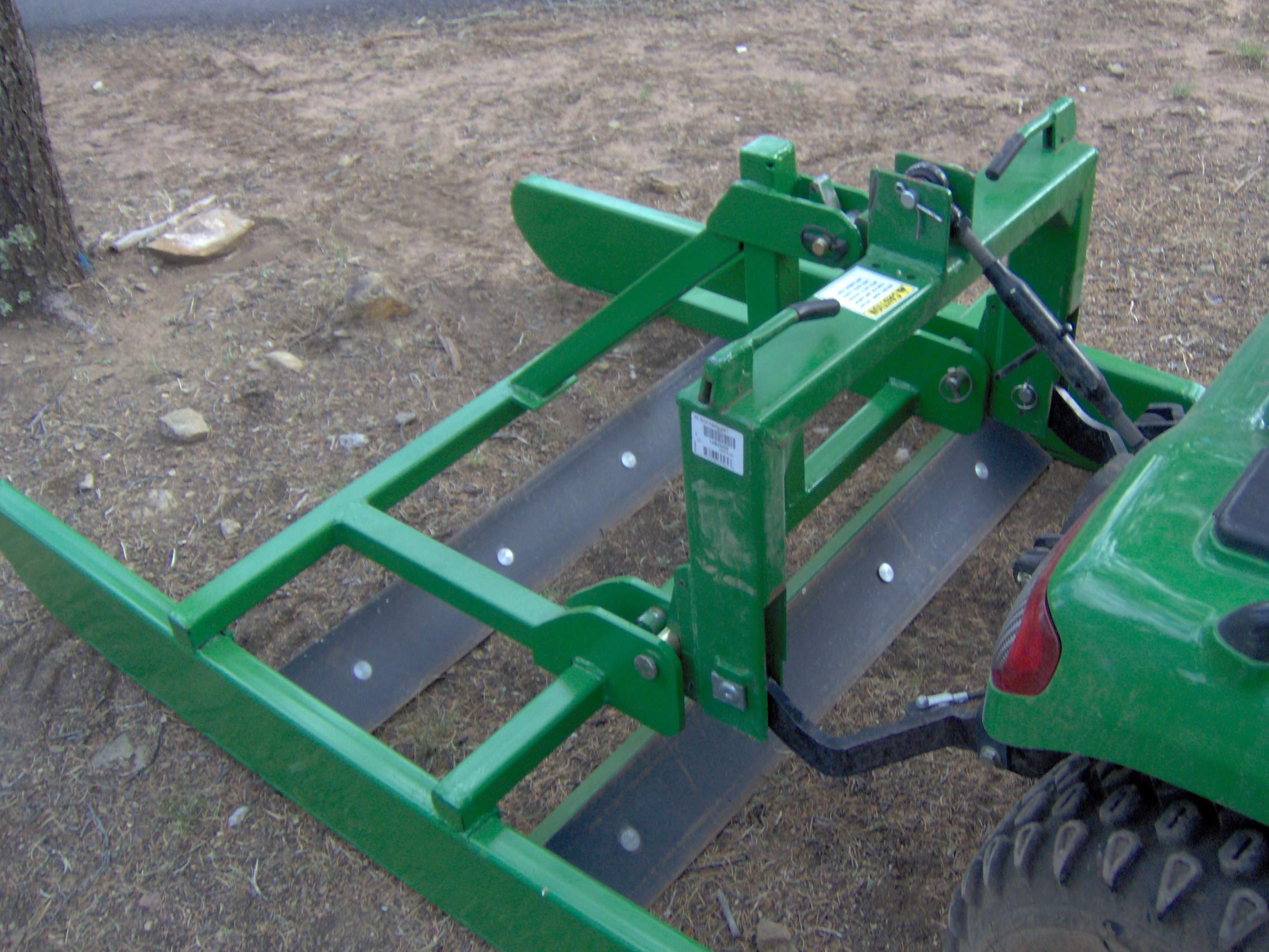

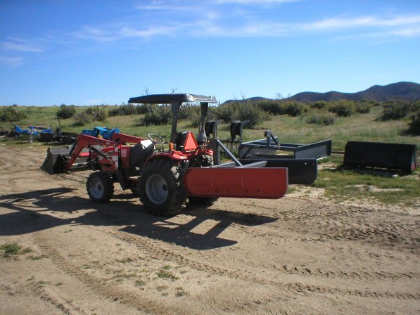

My 7 footer is 1400lbs, 84"long, 22" tall sides, 3/8" thick. My 5 footer is 800lbs, 72" long, 18" sides, 3/8"thick. Cutting edges on the 7 footer have an 18" angle what ever that works out to be in degrees? And are currently 21" apart. Pretty sure that if I ever get some time I will move the rear cutting edge back so it will be 30" apart on the 7 footer. My runner's are 2 & 1/2" wide. My angle to hold the cutting edges is 5/8" thick 4x6. These have been GREAT units for me, and have had no reason to want anything adjustable on them.
Yes you are correct in that the material migrates side ways very very little. I actually painted a stripe on the ground to watch how much it did actually move side ways. In my test it was less than 1" after going over both cutting edges.

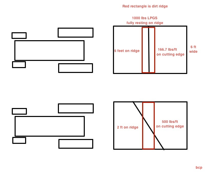

I believe the main benefit of the angled blades on most LPGs is not movement of material to the side, but concentrating much more of the weight on the cutting edge when cutting a crossways ridge, such as a washboard road.
Here is a simplified diagram
Bruce

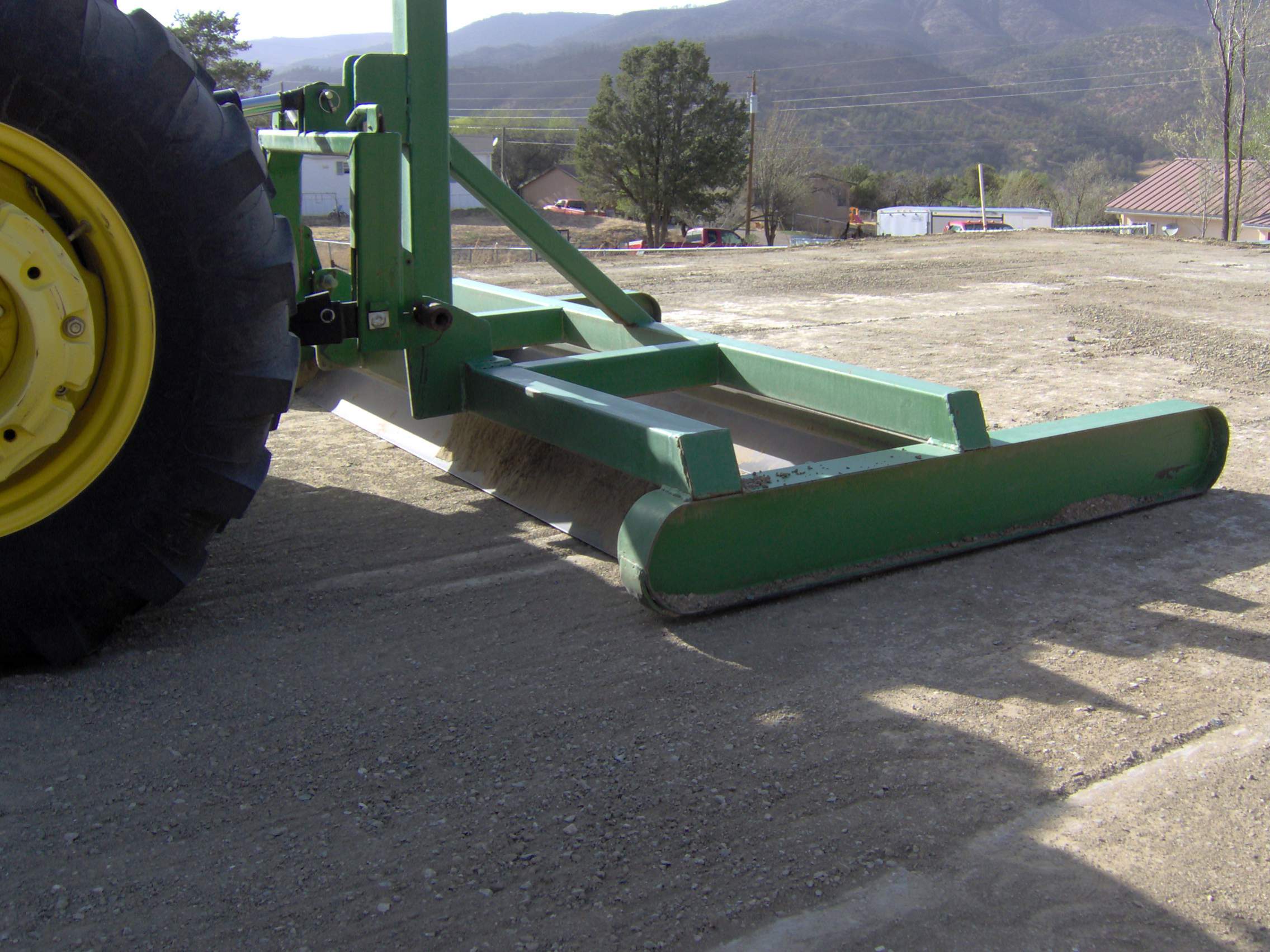

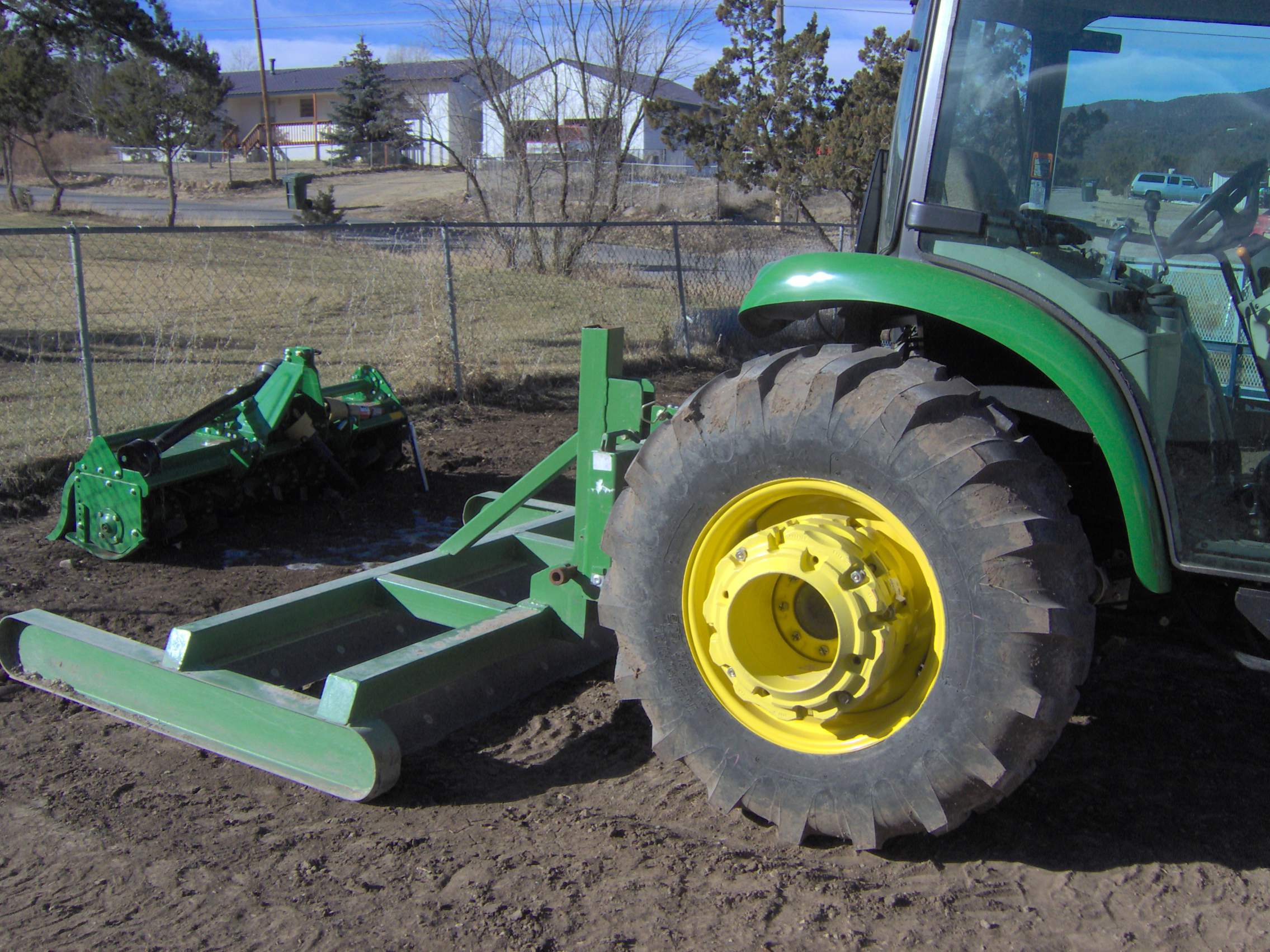

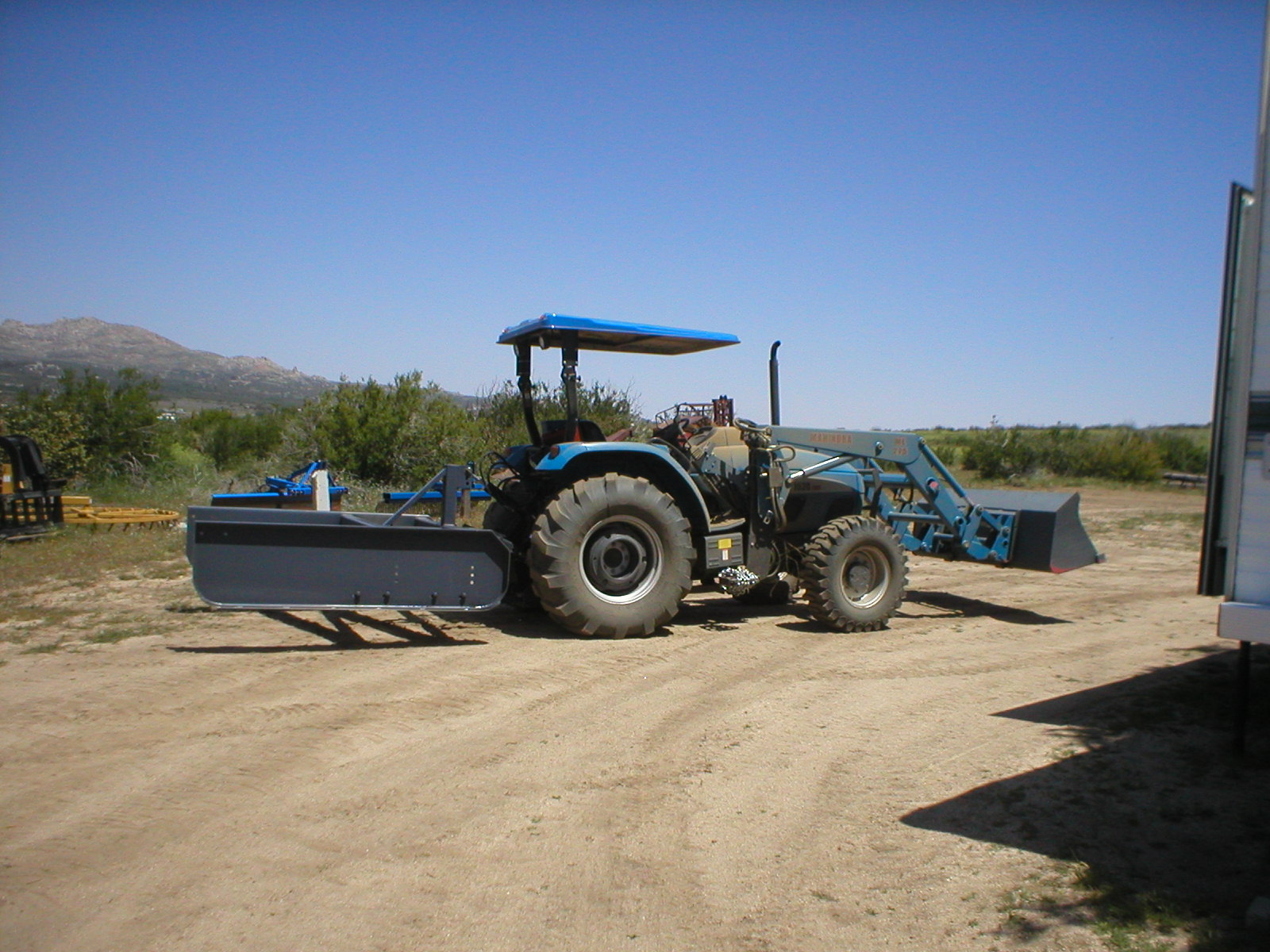

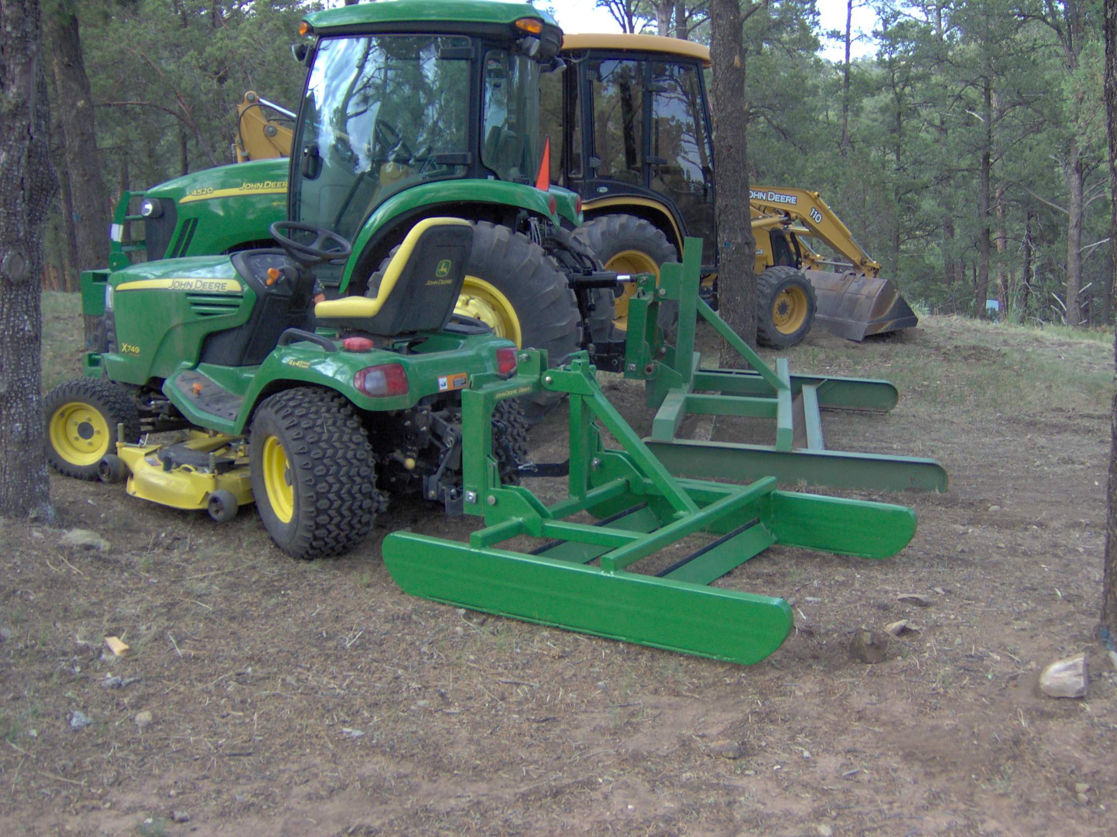

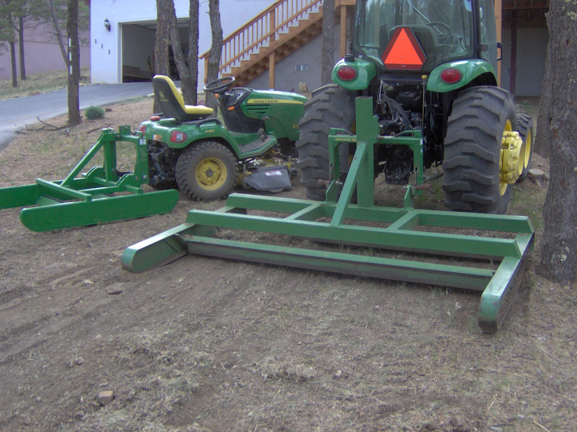

I have built two lpgs so far and would recommend heavy construction and long skids. I prefer the box tube skids as these do not hold gravel to drop on the grass. Longer skids of 6' would be good for straight runs imo. I would look for some drop pieces of larger rectangular tubing maybe 2x12, 3x12 or larger. You could fill them with sand or concrete for cheap added weight. A non flexing frame work with lots of weight is important, along with good grader blades properly angled to cut cleanly.
For driveways a lpgs ideally should be about half the width of the driveway. For smoothing larger areas such as pastures and parking lots wider is better. Most of my work is pasture smoothing in New Mexico as I find the gravel driveways and roads seem to stay in good shape and only need an annual touch up.

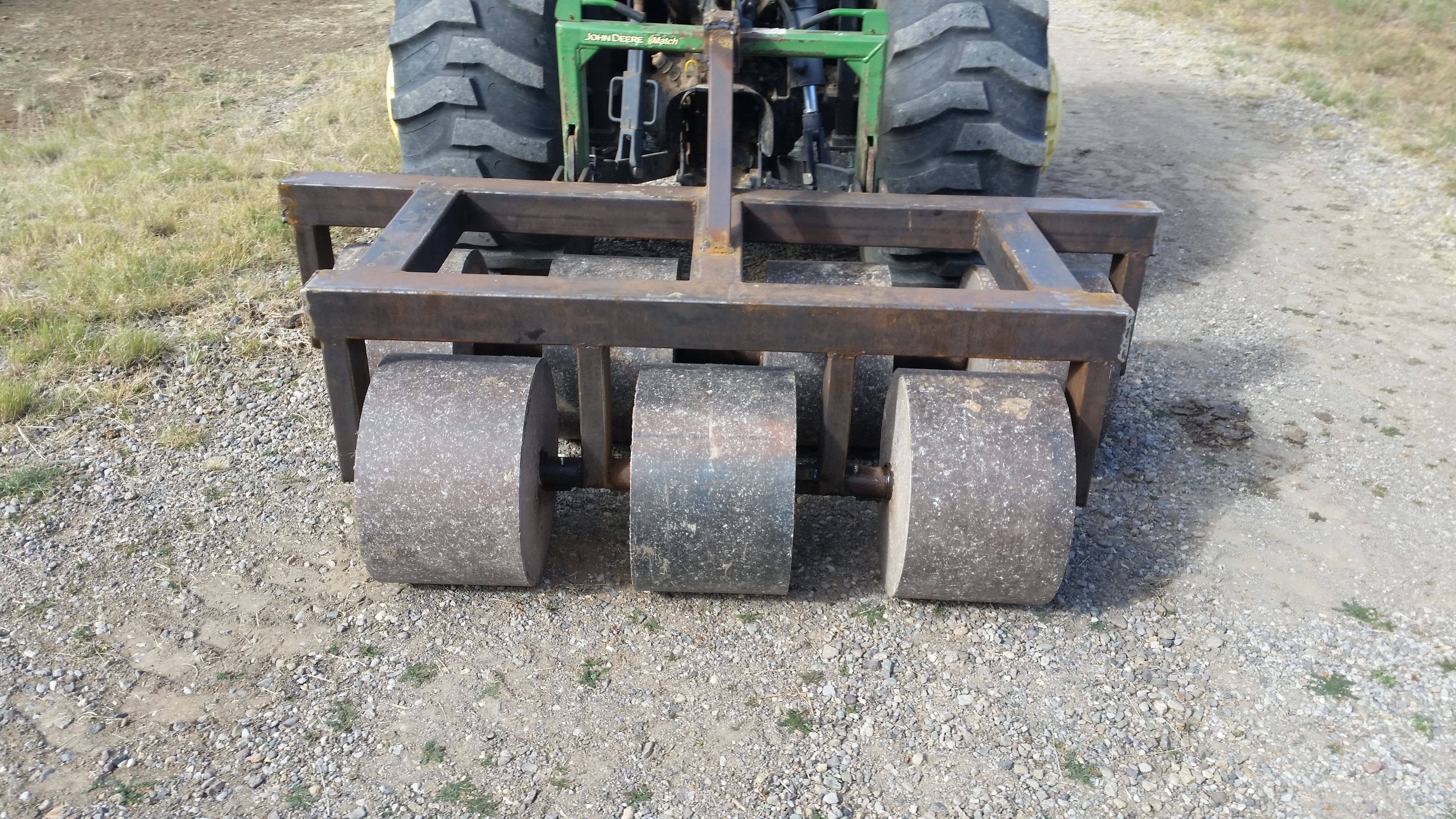

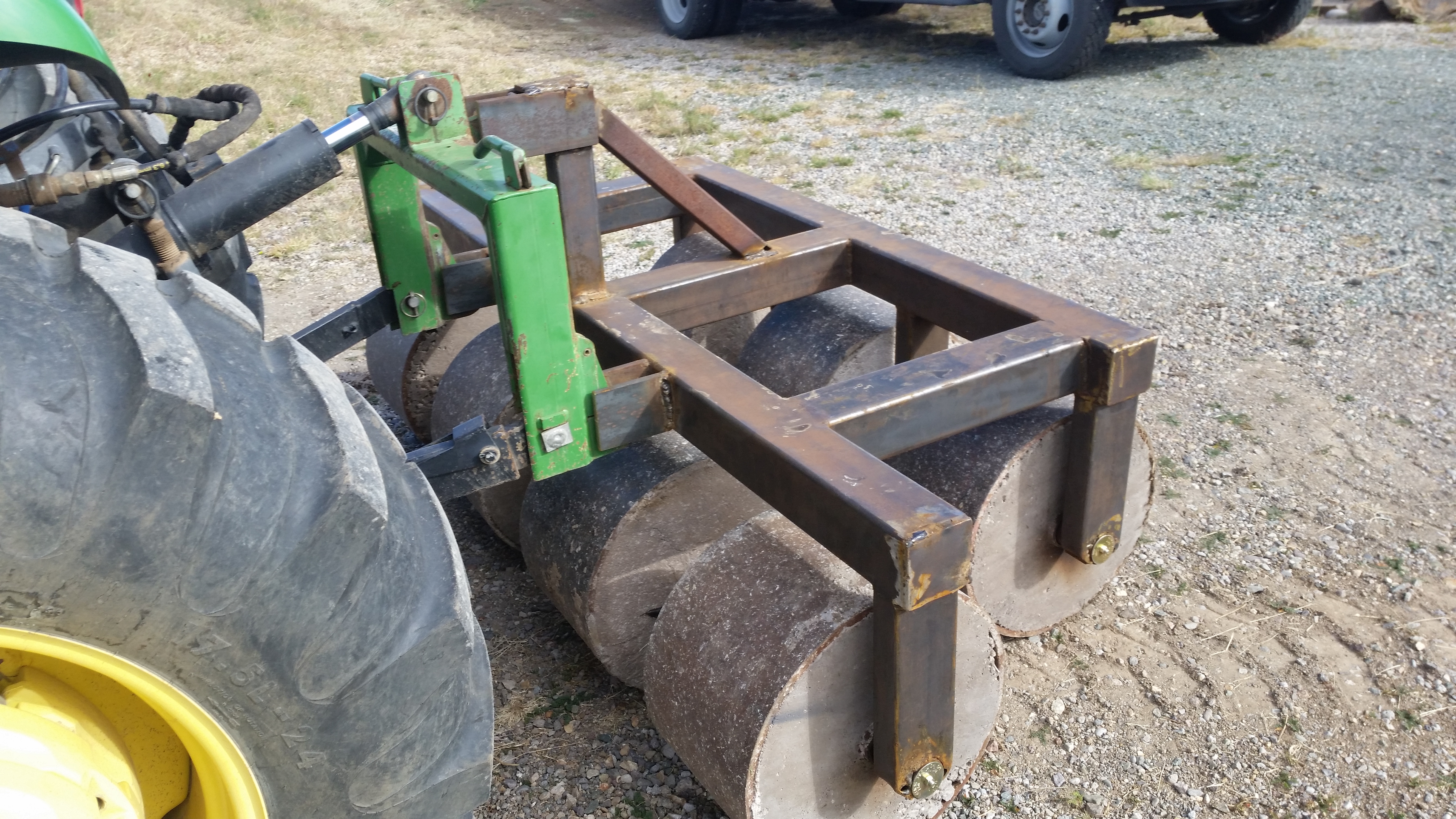

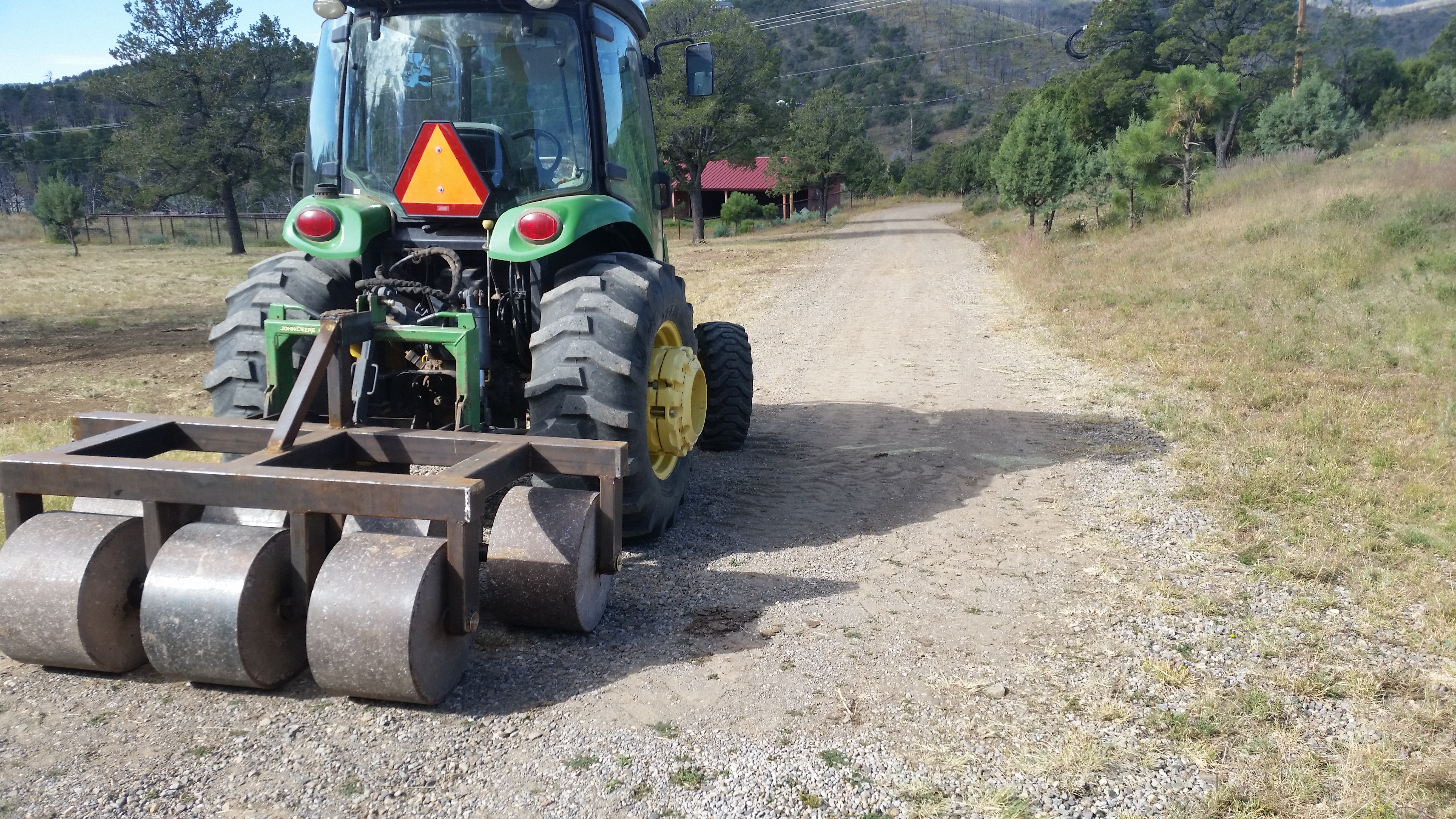

I recently built a heavy roller with 3ph and will soon try it out on a few projects. This roller weighs about 400 lbs./foot of width using 18" pipe sections filled with concrete. The segments allow for tight turns with little scrubbing. I took the pictures when I was testing it out. Wanted to be sure I could pick it up before continuing. The welding sucks, I did this before having cataract surgery, couldn't see what I was doing. Have to get the other eye done soon, recover from it before resuming any welding projects.
Here are pictures of my lpgs and roller.

What did you use for bearings on your roller?
No bearings, the center shaft (2 3/8" drill tubing} has grease in it with small holes where the roller wheels run. The rollers have 2 7/8 drill tubing for centers which turn on the smaller pipe with grease zerks.
I did put a piece of 1 1/4" pvc pipe capped on each end inside the axle tubing. This reduces the amount of grease needed in the cavity.

I really like that new roller Idea Steve. What do you think the total weight is?
Thanks Murph, the roller weighs about 2600 -2700 lbs. Having two rows gives full coverage with the slight overlap and makes it easy to hook up. I cut corners and eliminated the usual hitch pins and went for quick hitch attach with welded in place bushings (cat 3). With this much weight that was a good choice imo. Cheaper too.
The roller wheels have about 3/16" of movement on the axles so if you have a rock sticking up that is persistent you can run the roller over it (centered) and push it down with the weight of the entire roller. The roller casing is 18" diameter with 1/2" wall with spokes inside to strengthen and hold the concrete I was busy the past year so the concrete had a full year to cure. Hopefully it will hold up to rolling about 15 acres a year for my laser grading jobs.

I was walking through a friends scrap pile and saw the 18" diameter drops in a pile. I was not thinking "roller" that day as I was looking for steel for my laser tail wheel assembly. But, a week or two later it dawned on me and when I returned to the pile I bought seven of them all 11.5" in length. Designed the roller frame and the next concrete job I filled the spools with left over materials.
The separate spools made sense because I have to turn quite a lot between borders (terrace rows) that are close together. The two rows was an advantage for the quick hitch since the frame is up right with no jacks or stands to deal with. Being compact is important for me since I trailer my equipment often.
I have about $160 in this so that is cheap enough it can sit for long periods without use. Should be great for rolling and firming tilled fields for leveling and will be the major use for it.
