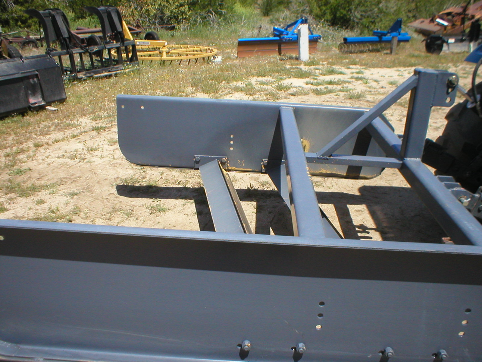

I don't know if anyone has ever come up with an optimum cutting edge spread. :confused3: On my bigger LPGS, (7' runners) the cutting edges are 22" apart, there is room to move the back one back, I want to put it so there is a 30" spread between edges and see what and if it actually makes a difference. My thinking is that it will, I just need to find the time to do it along with everything else. :sigh:

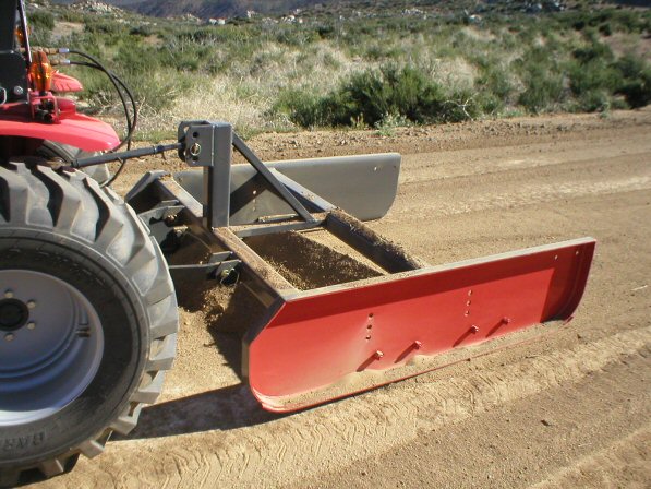

This may be late to the post, but i also recently acquired one. It痴 difficult to get results on Florida痴 sandy roads. It seems to either be loading up like a BB or barely scraping. I've tried about every adjustment, speed, and technique i can think of. The skids either dig too deep, or you are just skimming the surface despite being on the draft like a hawk.
Note: mine is a fixed blade design from A&B, but i doubt it matters. If anyone has any new tips for use, they would be appreciated
/ LPGS - I got one! #29
Set the LPGS so that both cutting edges are cutting, either an equal amount or just a bit higher in the front. You can see in the picture that mine is about 1/2" higher in the front. My cutting edges stick down 1" from the runners.
Now let the implement down until it is on the ground. DO NOT push the position control lever any further forward than to just let the implement down. You want the hitch to carry a load, not just go down as low as the implement wants to go on it's own.
Try this, it typically works very well for people that do not have or do not use draft control. :thumbsup:
