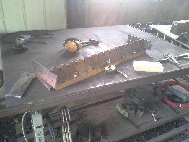

Good picture, but I hope you didn't weld them on that end!
/ LPGS build
#22
Uh, no. Needed the flat surface to jig them. Upright for the top link is in the way on the front. They will be welded on the front edge of the 4x4 not the top anyway

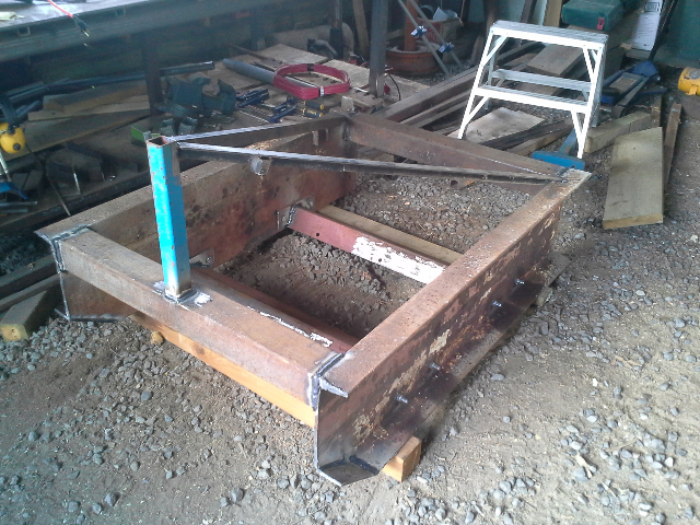

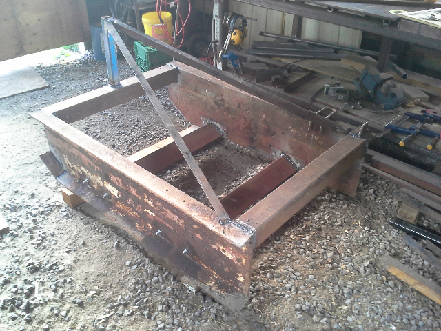

Life has been so busy lately that I haven't been able to update this until now. Stood the thing up on its end to make welding the hitch brackets easier as I'm not the greatest at vertical welding with the stick. The 4" of travel in my flex link translates into about 15" total articulation of the LP.
/ LPGS build
#24
8x8 block used to test the flex
Sorry for the sideways pics, I can't seem to get them to rotate upright on my phone
