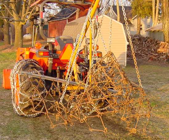

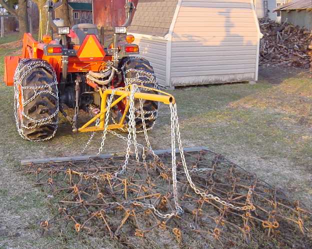

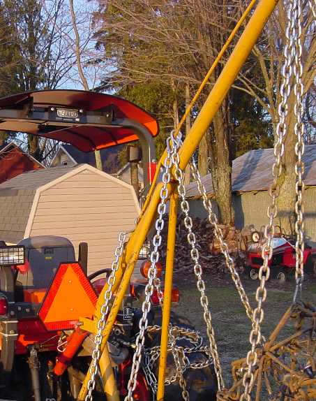

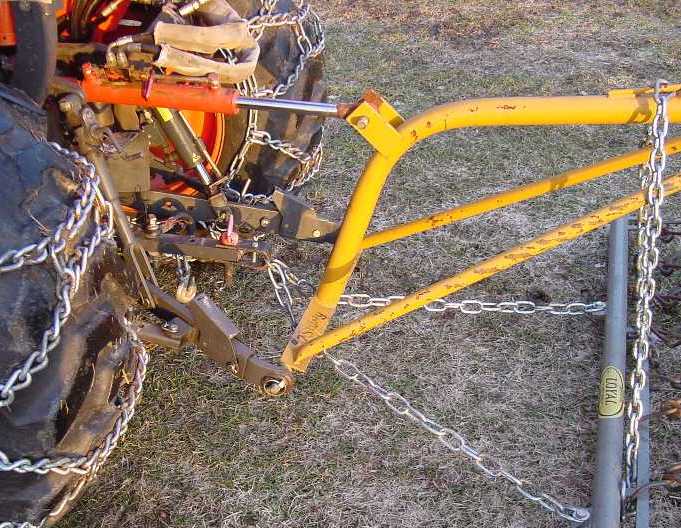

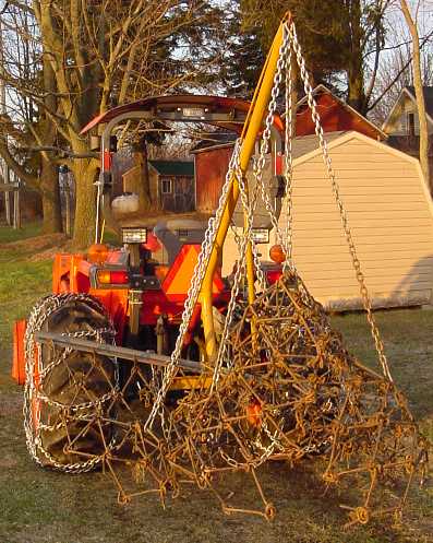

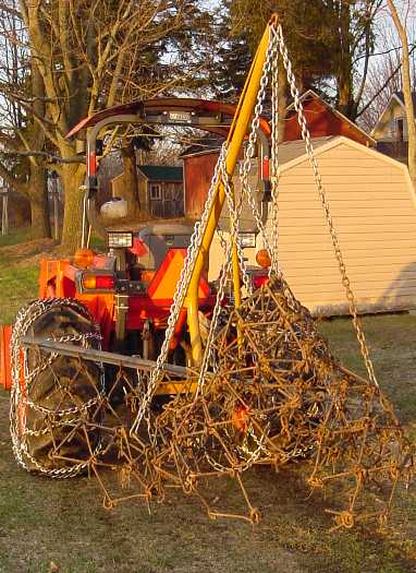

Thought I would show off my chain harrow setup. It's a Loyal 8' X 8' Chain Harrow from TSC and a King Kutter Boom Pole.
I ran two chains down from the front, three chains in the middle and three in the back. This lifts the mat completely off the ground with the three point and the CCM top link.
I really like this setup. You could build a drag from chain link or old bed mattress, but they don't last long and can spread metal around when they wear out. Plus the Loyal Chain Harrow can be flipped over to be more aggressive.

Three point up and top link retracted. Chain Harrow completely off the ground. Also check out the CCM side link.

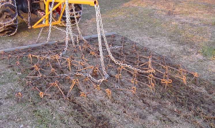

Photo: # 06
Completely lowered.

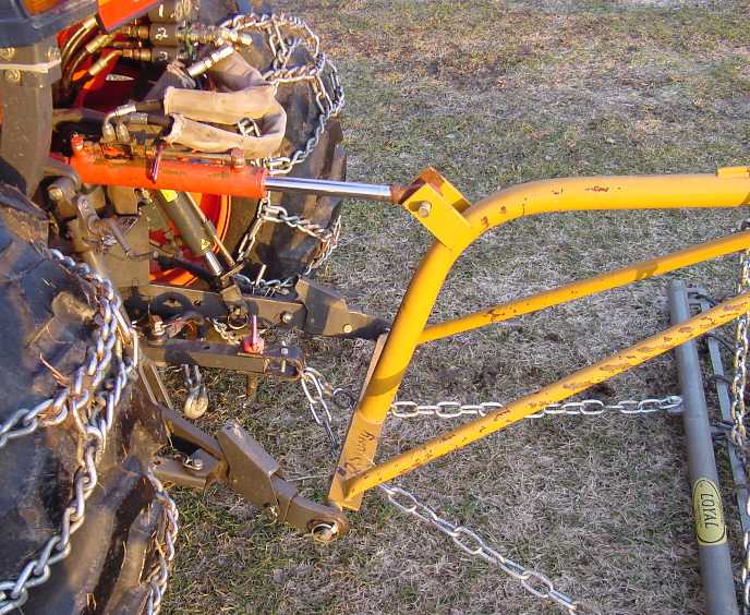

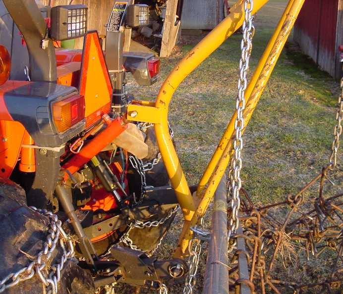

Another side view of top and side links.

Forgot to mention I used Grade 30 3/8" chain and carbiner type snap links to attach chain harrow to boom pole.

Yet another side view. I used old fire hose over the hydraulic hoses for the top and side links.

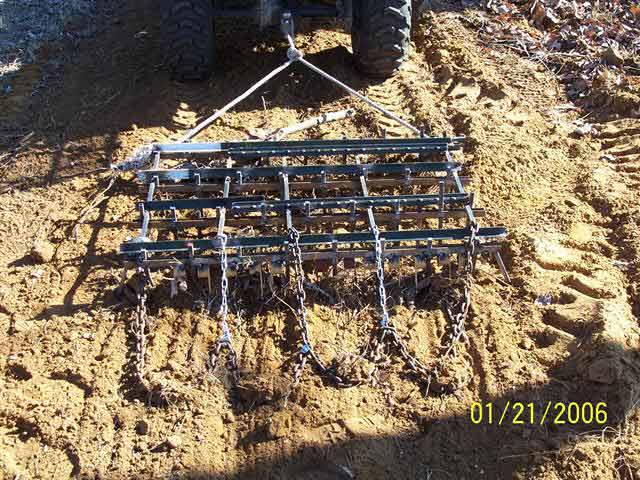

Cool, any way to build a frame to pick it up level? I built I little 4' harrow from 1/2" solid bar and some t-posts for deer plots. Pulls easy behind my ATV. While testing it out the other day in some root infested ground I noticed it trapped a lot of stuff. Just pucking it up from one side and the stuff just fell out. Might rig it up on the 3pt. But I like how I can go faster on the ATV.

And a second....
Ain't pretty but it works OK. Does bust up the clods.

I used an "x" bracing with the boom pole and it pick's it off the ground very well...and it was something I had laying around...simple and easy
