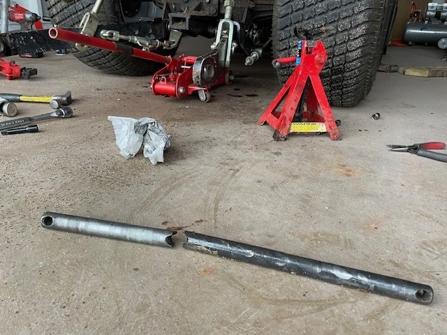

While running the flail mower the other night I broke the pin on which the lower arms of the 3pt pivot. I think I cornered too tight with the flail on the ground. Couldn't get a replacement from TYM for a couple weeks. I heard that TYM makes some Mahindra models and found a pin from a Mahindra dealer that had the same number. Slipped right in and does not have the hole drilled in it where the break occurred. Did have to take the left wheel off to install it. (I took the left of so I could access some of the linkages on that side for the 4wd & PTO levers to lubricate them.)
