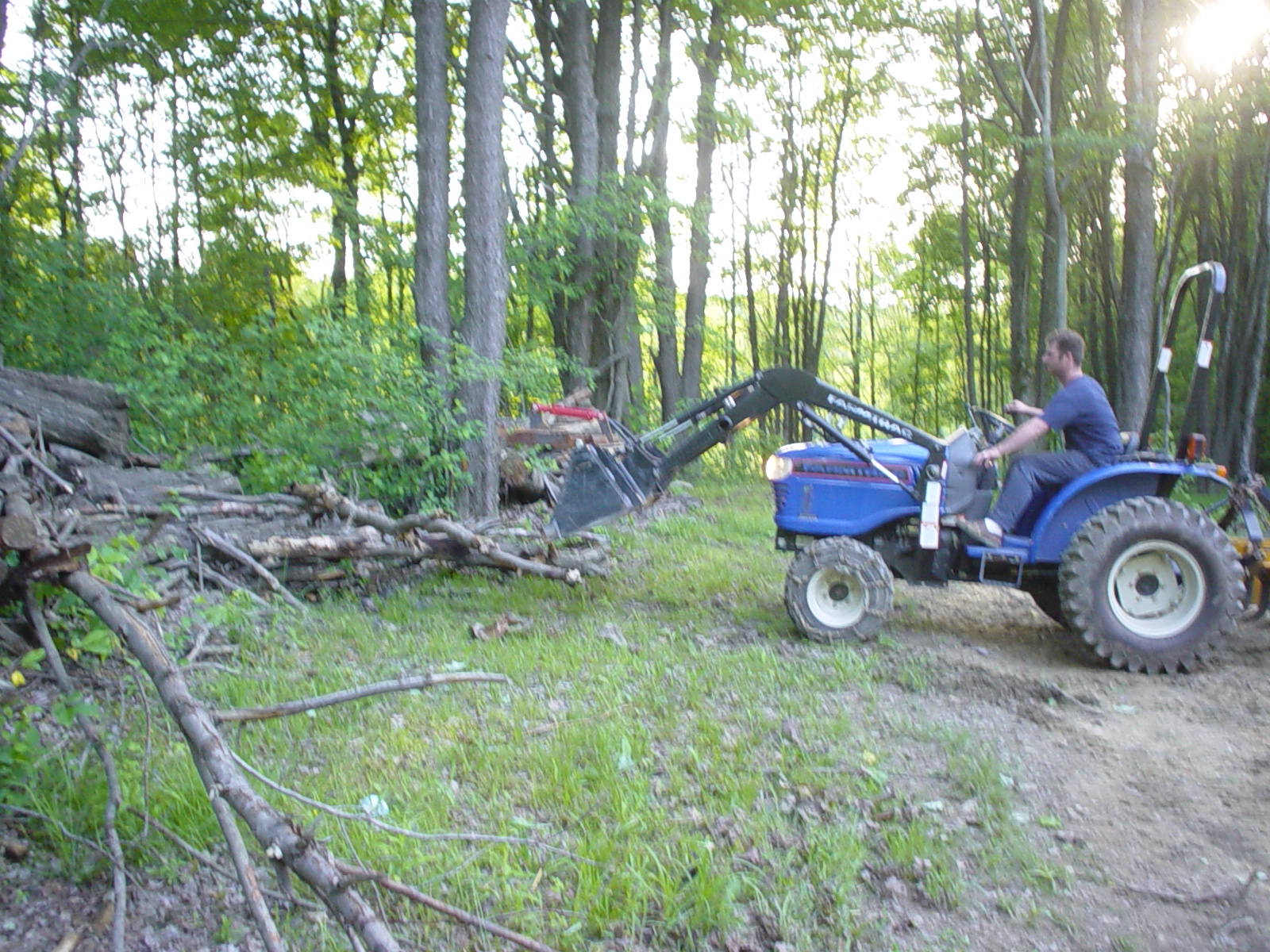

I bought some more items for the grapple today, two 8ft. 4000 psi 3/8 hyd hoses at TSC., 19.95 ea. and one 3/8 x 18 in hose, $8.00, and 4 3/4 to 3/8 npt reducer bushings. As it turns out, the reducer bushings were not the correct size, 3/4 is too big, and 1/2 is too small, so I am thinking 5/8 to 3/8 is what I need, but when I go to the hardware store this time, I am taking the valve in with me so that I buy the correct stuff. I did some rethinking on the position of the grapple control, because if I were too put the controls on the right floorboard, I could not use the brakes while using the grapple. I think that I am going to use a momentary on off on toggle switch similar in design and operation too an old fashioned meyers snowplow power angle control switch, Napa stocks these and they are only 6 bucks, and for another 4 bucks, I can get a rubber boot for the switch to make it weather resistant. I am now thinking about mounting the switch to the loader control joystick.

I finished grapple today, it works better than I ever could have imagined, tried to get video of it tonight, but batteries were dead in vid. camera, wife took pic with digital camera, and tried to take vid. with it too, but it came out so blurry that I dont want to post it. The vid camera is charging now, and I will post vid clips of grapple in action tomorrow weather permitting

When you started thread, Low buck grapple build, back in march, I think you said you had about $162 in it. How did the final total compare to that? Looks like you saved a bundle and have a fine working implement/attachment.
   / Low Buck grapple build
#67
final cost was 370 dollars, this includes the steel, welding rod, fittings, hoses, and hyd. control valve. check out the video link in the owning operating section
