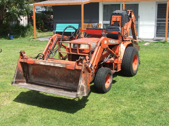

Good luck with that! Superficially it may seem that a 4in1 is just a bucket with a grapple but theres more to it than that. Its better to think if it as a dozer blade with a swing-up bucket. Mine is pretty old and very heavy. I dont know what brand it is. Its really at the limit of what this little Kubota can manage. I've seen others that look a bit lighter and simpler, but its unavoidable that some parts need to be very heavy duty . The dozer cutting edge takes quite a pounding, and the back edge of the bucket also needs to be strong. Having 4 rams also means theres a fair bit of plumbing, weight and expense. I'm surprised that Kubota dont offer one anymore. Perhaps they think they put too much stress on the loader arms. And all that weight means you certainly need a counterweight at the back end for balance and traction.

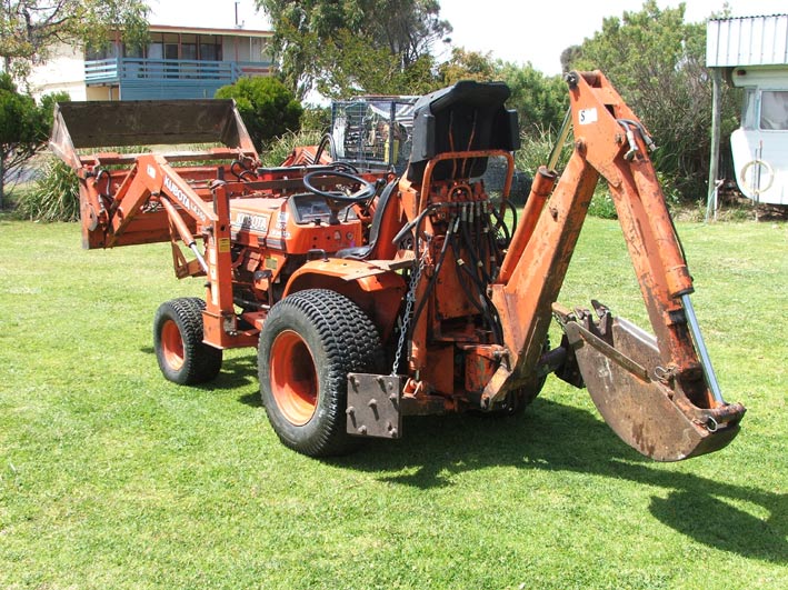

I meant to add these pics to the message above.

Its 4 including the usual 2 bucket rams that most loaders have anyway. Theres 1 small ram each side of the bucket to operate the grapple. That seems to be common to most 4in1's but maybe a clever engineer could design it with just 1 ram in the middle. Mine is only a 300 kg loader (with a 5 gpm pump) so I lose a bit of lift capacity with such a heavy bucket but its worth the compromise. (I notice this most when I've got forks on the front of the bucket). Some of the sheet steel could probably be lighter but it needs a pretty sturdy frame around all the edges. Some clever folds and and bends could add strength in place of just relying on brute metal thickness. The bottom of the grapple need to be very strong so it doesnt get bent while backdragging or pulling stumps out of the ground. Regarding width, it needs to be at least as wide as the tractor wheels so it can doze efficiently. Some 4in1's often don't have the volume capacity of a dedicated bucket but thats another small compromise worth putting up with in most cases. And mine doesn't curl back as much as I'd like but thats another minor shortcoming probably just unique to mine.
One other benefit of a 4in1 is that you can build and dump on a higher pile because you dont have to dip the bucket to unload. You can just open the grapple and let the dirt or brush drop out the bottom. Its a handy feature when you've only got limited lift height in a small tractor. (See, I'm raving about it again).
