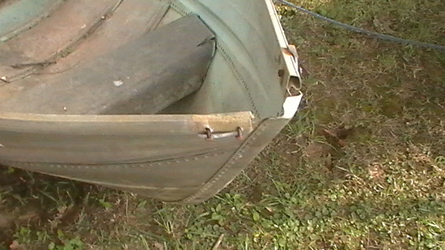

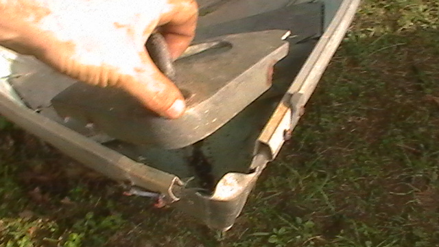

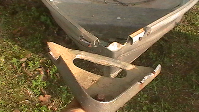

still need to find part for boat that broke off in attempting to pull it out.
