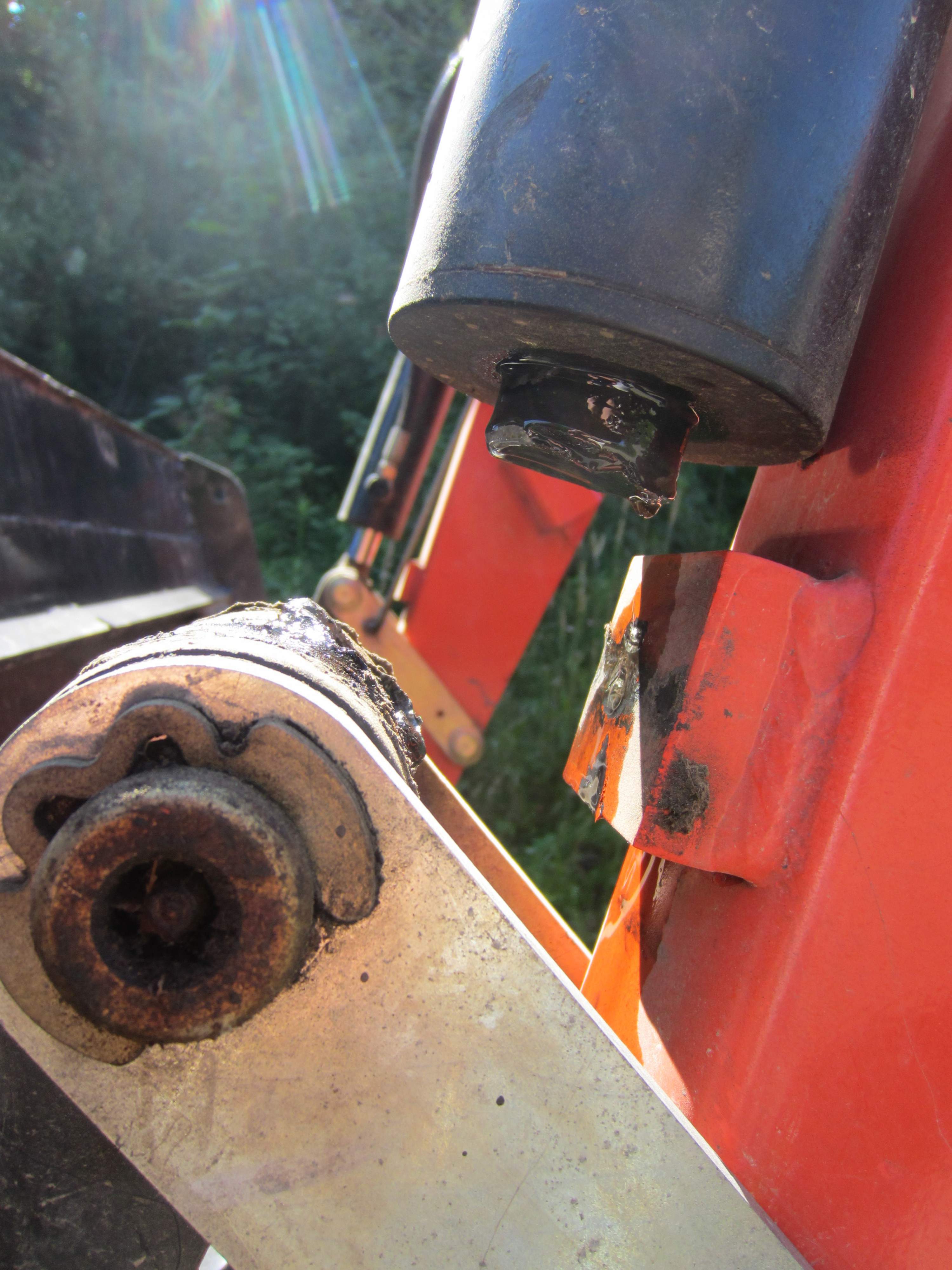

I was moving dirt, the other day. While dumping my loads, I was pertially driving up the dump pile. On one occasion, the edge of the bucket came down on to the pile annd I started rolling backward. Mistakenly, I attempted to dump the bucket further, and since this would have had to pull the tractor up the hill, this didn't work.
I now have up and down pressure on the loader, up pressure on the bucket curl, but NO DUMP PRESSURE ON THE BUCKET. When I dump it goes slow. If I attempt to hold the edge of the bucket against the ground, it just gives way.

That said, I go out and diconect all the QD's from the FEL. I reattach. Still operates the same. It seems that the right side IS pushing down, but the left is not. I decide to actually go take a look at the bucket and cylinders.
****!:thumbdown:
Another lesson learned. When something stops functioning as it did/should, take the time to check things over.
The rod broke the weld on the bucket end. Though it is tempting to re-weld it, the rod does not seem to be actuating and is leaking. I'm assuming the rod bent before the weld broke.
I got a price of ~$170 for the cylinder assembly. Plus shipping. Picture 042.jpg

I would also guess you bent the rod. To check for a bent rod place the bucket flat on the ground and then try to dump the bucket. Pressure will build and the left cylinder should extend.

You could try and fill the cyl first, or just connect the hoses and operate the levers.
It may take about 5 complete cycles to purge the air from the cyl.
The FEL valve will supply fluid to the cyl with the least resistance first.
