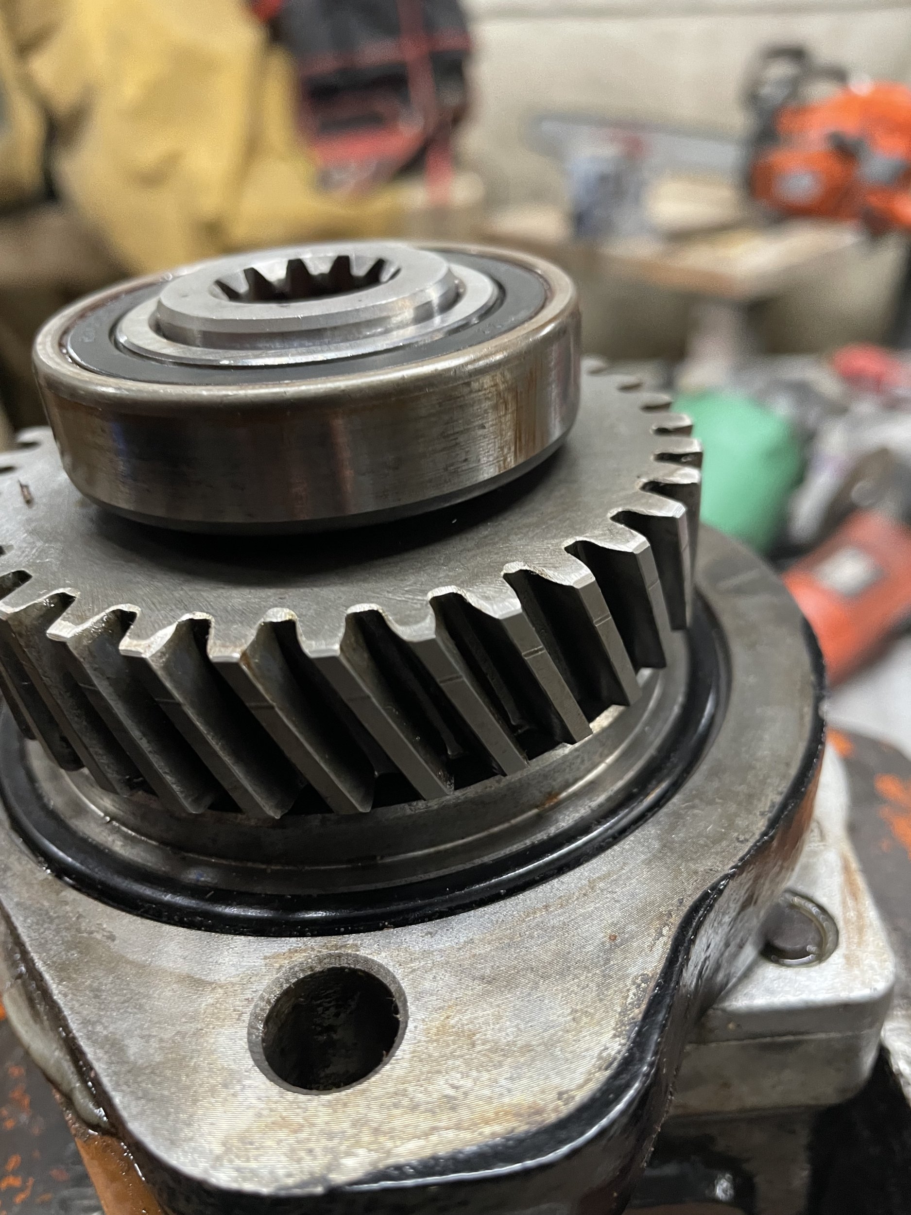

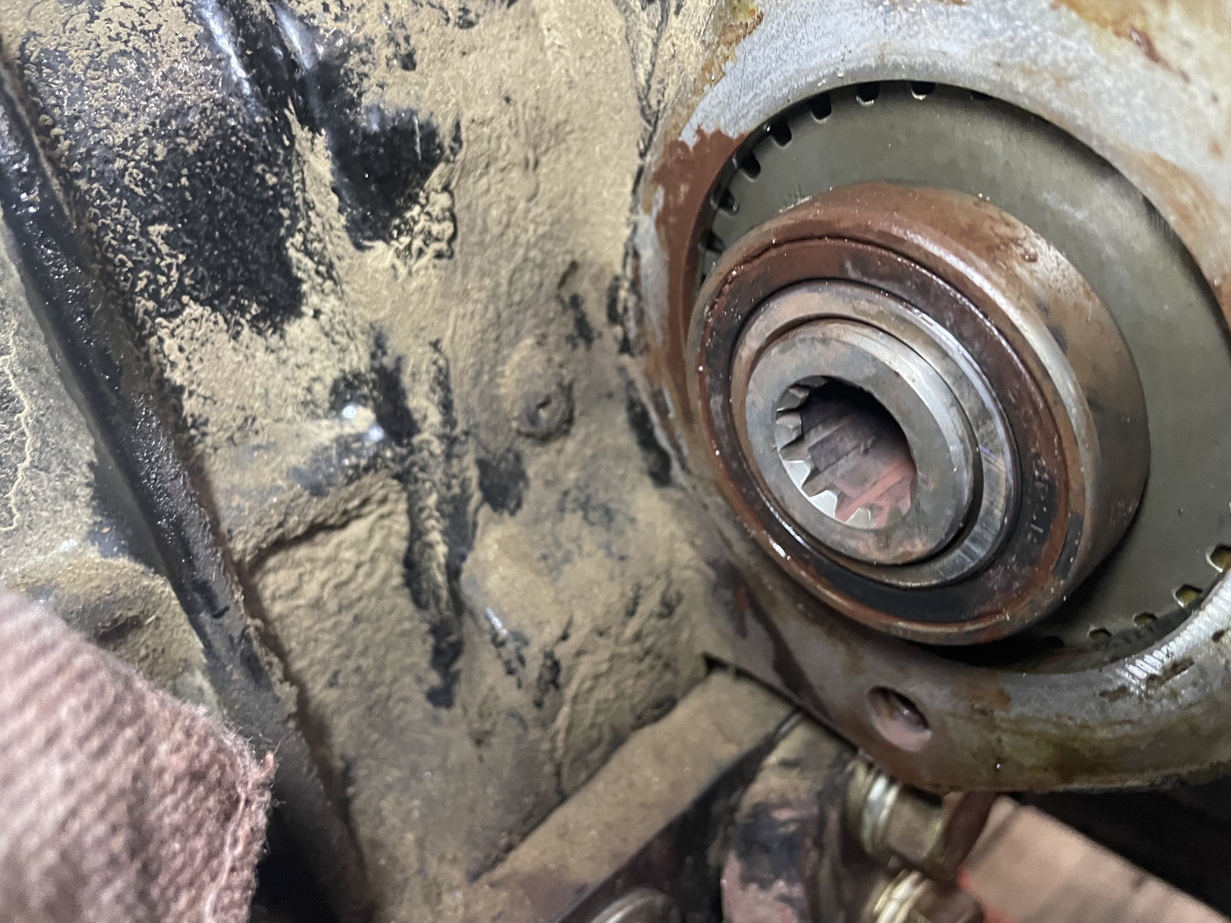

I am 75 hours inside of recommended hydraulic filter and oil change. Removed the pump and the inside drive splines are gone. Now to see if that drive gear is available or how that drive gear is made. It will require pulling everything off the front to open and remove.
/ Lost all hydraulics today 1538
Part is "sold out" per 2 dealers when checking Mahindra's inventory. One of the dealers I checked with was Bill's Tractor. According to the parts person I talked to: "we have never sold one of these." It is called the gear-hydraulic - part # 006005024D1 if anyone may happen to have one lying about. If I am lucky the gear is cut straight and I can just flip it over and used the undamaged portion of the internal spline. The bearings on the ends of the gear are the same. Otherwise I may have to machine some other type of fitment for the pump to gear. That would require disassembly of the pump so that I can turn the shaft down and weld on an extension(?), bore out the gear and broach multiple keys?
Went to the nearest dealer today with gear and pump in hand. ALL the parts necessary to reassemble this to really fix the issue are "out of stock". I placed an order anyway. In the time between now and whenever the parts are available I will be able to swap the worn gear around and operate it that way. The bearings are identical and the gear is symmetrical. Discussed this option with the mechanic and service manager and both agreed it was a viable option. Hopefully it will work until the parts arrive or Jesus returns. There was a lot of rusty dust in the open end of that coupling when I opened it up so that it wasn't a catastrophic failure, but one that had been building for a while. Photo below is the same regardless the way I slip the gear on. It meshes with crank gearing either way as well. I will lubricate the splines when I assemble, maybe that will mitigate the wear.
/ Lost all hydraulics today 1538 #6
Put some good moly grease on those splines before assembly. Under certain conditions fretting occurs which is a fancy word for the splines disintegrate the moly grease will slow this down.

There is no oil bath in the spline of the pump and gear, so changing the oil would not make a difference in this case. In the future I will be opening the cover over the hydraulic drive gear annually and check and lubricate.

metalcaster, I opened up the cover and pulled the pump out a little way on my 2538. The splines looked fine and everything was coated with engine oil. Makes me wonder if on your engine a manufacturing process that would have kept the splines oiled was overlooked which is why you found your pump splines the way you did. It is only one data point but maybe you could bring that up to your dealer and Mahindra.

Why quality high impact male broached splines are usually coated with what is referred to a 'Super Spline Coating'. It's a sprayed on coating that basically eliminates any shock load, keeps everything corrosion free and requires no additional maintenance plus it acts as a boundary lubricant to eliminate any seizing of the mated parts. Used a lot in truck drivelines where the splines have to have some movement during operation.
