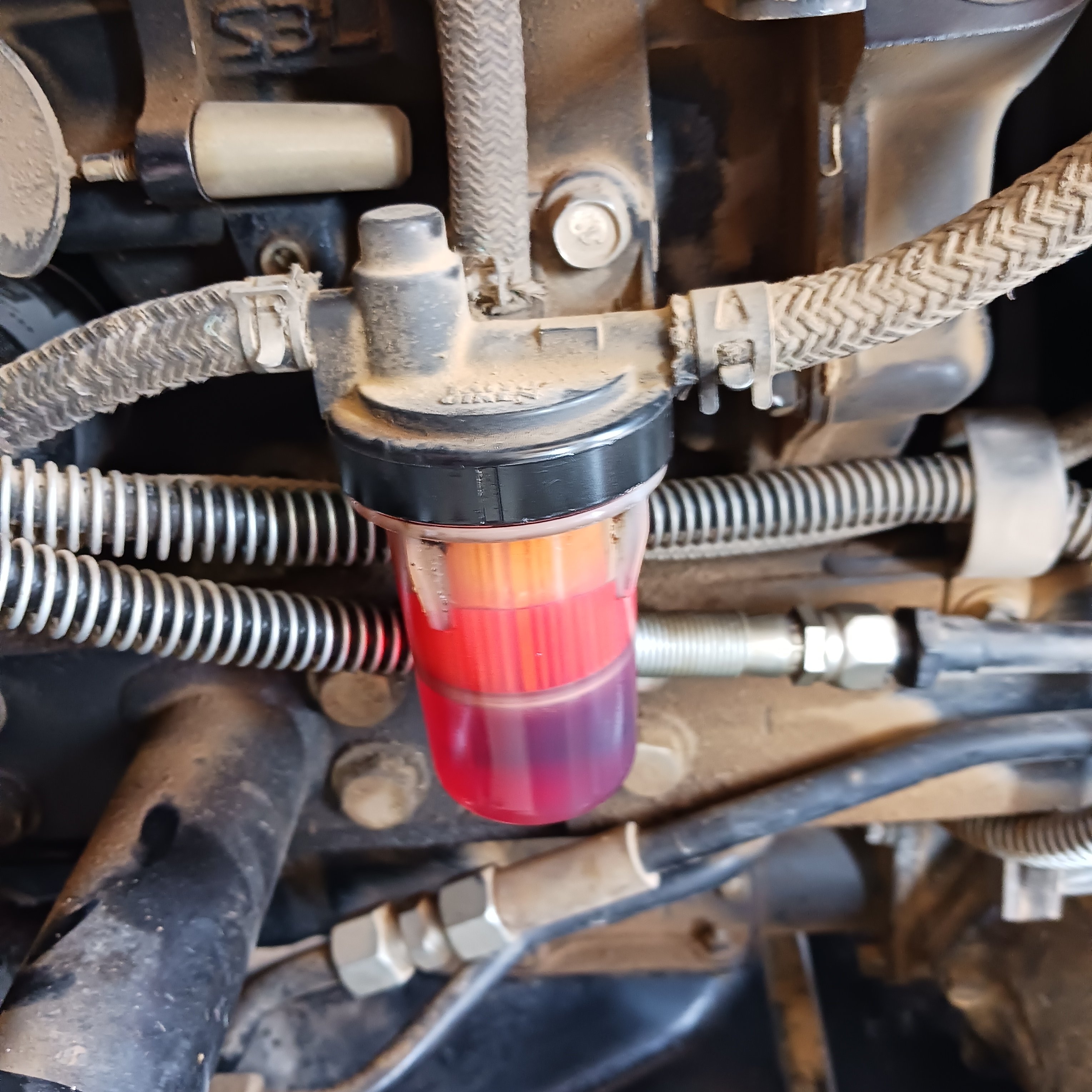

I knocked the fuel screen in the tank shortly after I got the tractor and thought it wouldn't hurt anything being in there. Well evidently it laid over the fuel pick up and the engine wouldn't run above idle.
Ended up removing the tank and fishing it out.
Same symptoms started yesterday. Won't run above idle if at all. Changed fuel and air filters. Didn't fix it.
I've over filled the tank in the past and discovered that there is a sponge in the fuel tank lid and when it gets soaked, a vacuum is created in the tank and the tractor also won't run above idle.
/ Losing RPM #27
I checked something today that I should have checked 1st thing last night.
The filter bowl as the tractor is running.
That was the symptom whether it was the strainer inside the tank laying over the fuel pick up or the soaked sponge in the fuel tank cap.....
The bowl runs out of fuel.
Just turning the key on today drained the bowl.
As the tractor was running at idle, the bowl drained and refilled slowly.
Pic is of tractor at idle
So where is this screen in the tank?????

/ Losing RPM #28
Pulled the line that goes into the the bowl and the flow was weak.
Blew low pressure air into that line back to the tank til I heard bubbles.
Huge flow out of feed line now!!!
Tractor runs Great!!!
Temporary fix
Just blew debris away from the screen in the tank.
Where is the screen?
