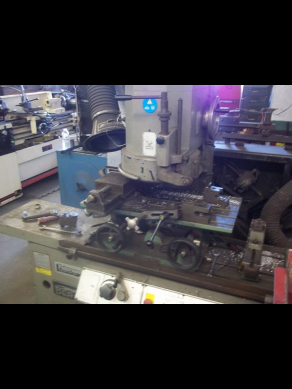

How did you "shave" the head? A machine like this is made for the task. The milling machine vice is not supposed to be there. I was using it to hold parts much smaller than heads or blocks.
