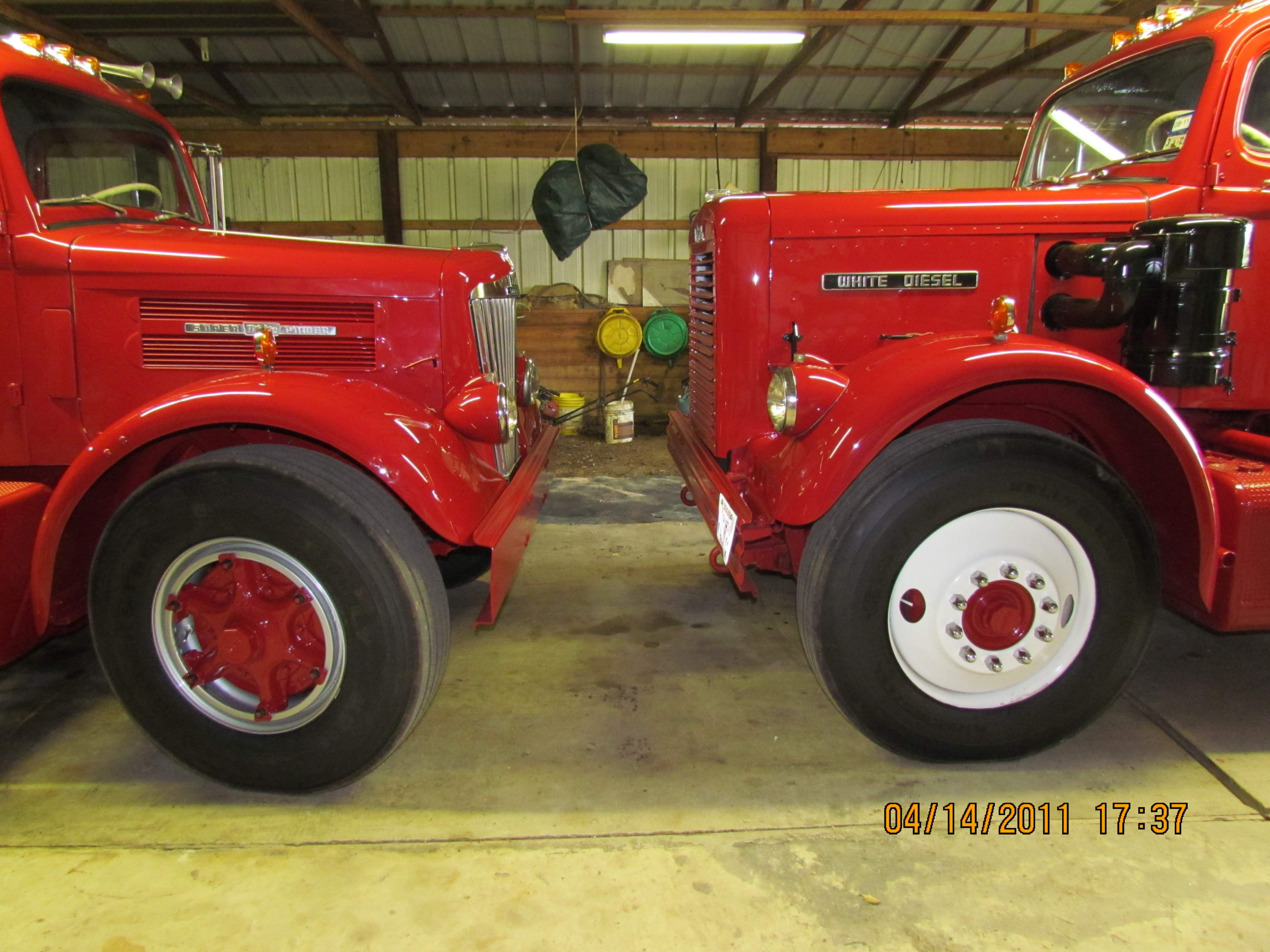

Here's a comparison between a Dayton wheel and a Budd wheel. The truck on the left is a '56 White WC22PLT with 10Rx22.5 tubeless tires mounted on Dayton wheels. It originally had 10.00x20 bias ply tires mounted on tube type Dayton wheels with a locking ring. The truck on the right is a '59 White 4400TD that has 11R24.5 tubeless tires mounted on Budd wheels. It originally had 10.00x22 bias ply tires mounted on tube type Budd wheels. I changed out both trucks to tubeless tires because good quality bias ply tires aren't available anymore.

JESSE1 those are some awesome looking trucks. Thanks for posting the photos. I will be glad to loose the bias bounce on each trip out. :laughing:
