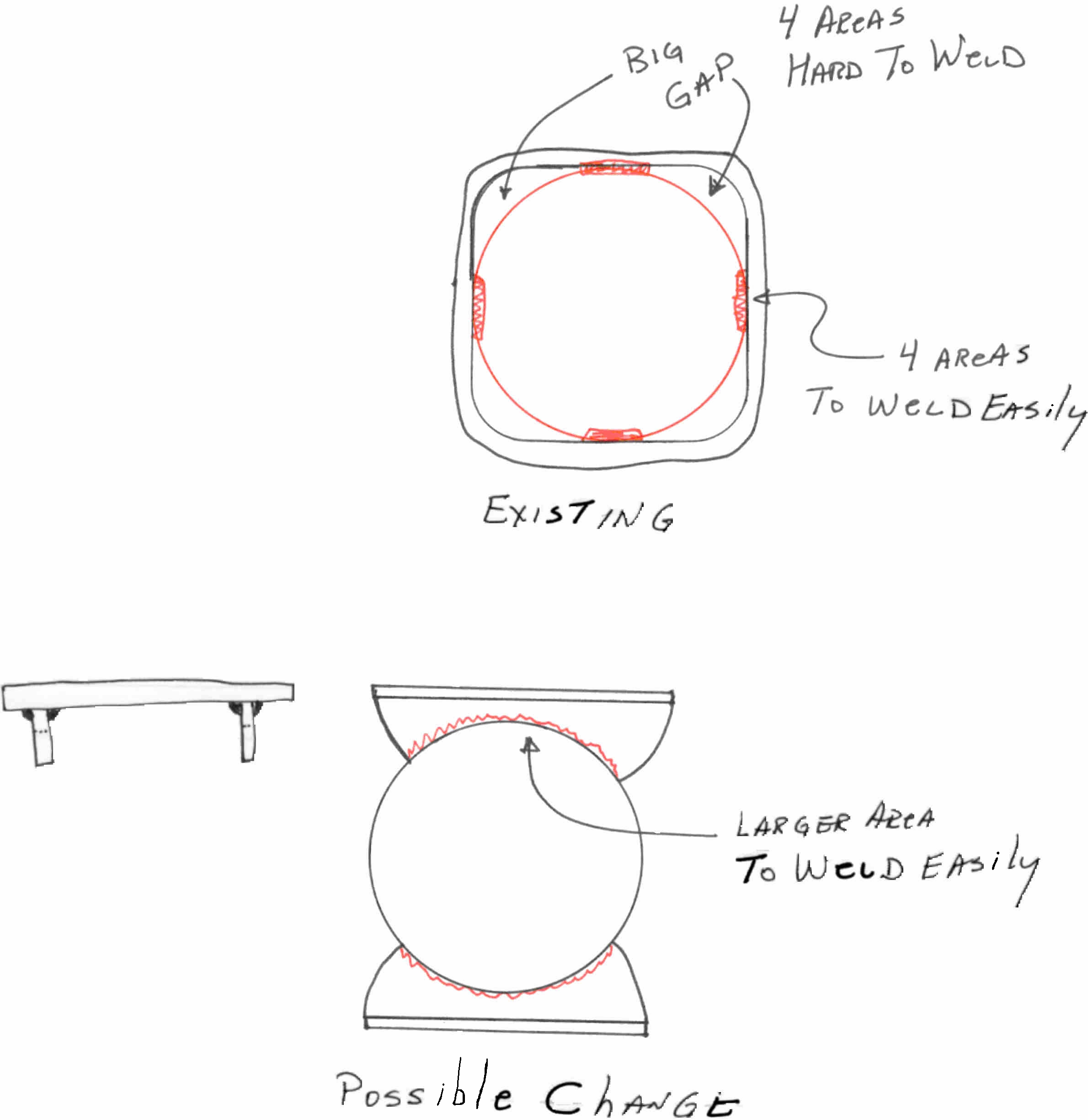

/ Loose ROPS Bolts #20
Harv,
I am not a tractor owner (yet) but I would like to point out the bracket welded to the axle is a poor design. I have welded brackets to axles before and adding a box around a circular cross section does not allow for good welding. The welder is trying to fill in the large gaps created by the bent plate bracket and the crack is the result of the welder trying to fill up a poor joint design. I have attached a poorly drawn sketch showing a possible design change and the problem with the existing design.
Does Kubota add this bracket or is it a dealer added bracket? The plate thickness for the bracket appears to be too thin compared to the size of the bolts and the connector plate used on the top and bottom. All of the loads from the ROP and whatever is attached to it (canopy?) have to be transferred through the welds to the axle housing. The one cracked weld may be okay as is but if you have it repaired be sure and remove the defective weld and have it replaced. Do not just weld over the cracked weld as it will just crack again later on. Post is getting a little long, hope this helps.
Randy
