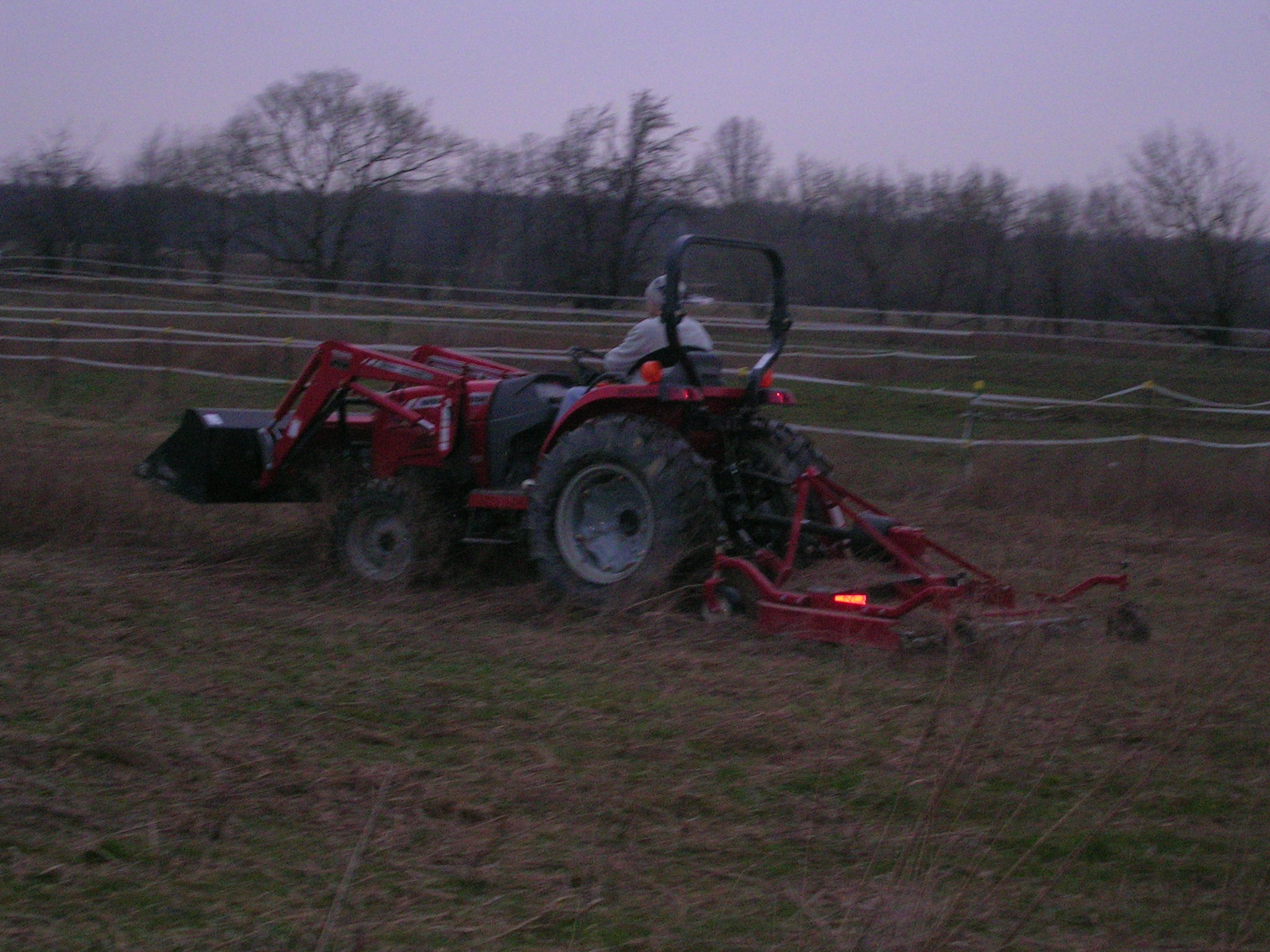

Premium duty by Woods....I cut 12 acres weekly with it... so I felt I needed the best.... but thats up for discussion I suppose. And the PRDs come in your favorite Tractor colors! RED!
See literature:
View attachment PRD series finish mowers.pdf
See Picture of the first cut I used the mower for.... it was the toughest it will ever see I reckon.... could have used a rotary.... but then I would have had to buy one of those too!

Hi Jacob
I thought it was a brush mower, my bad...I havent looked at finish mowers in some time. Thanx for the infos!! BTW I used my old LP finish mower a time or 2 for 'brush' mowing and it worked rather well (at lot better than expected).
