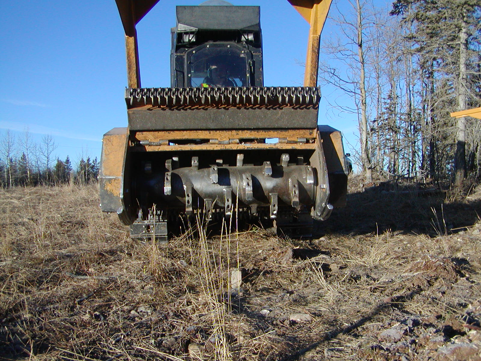

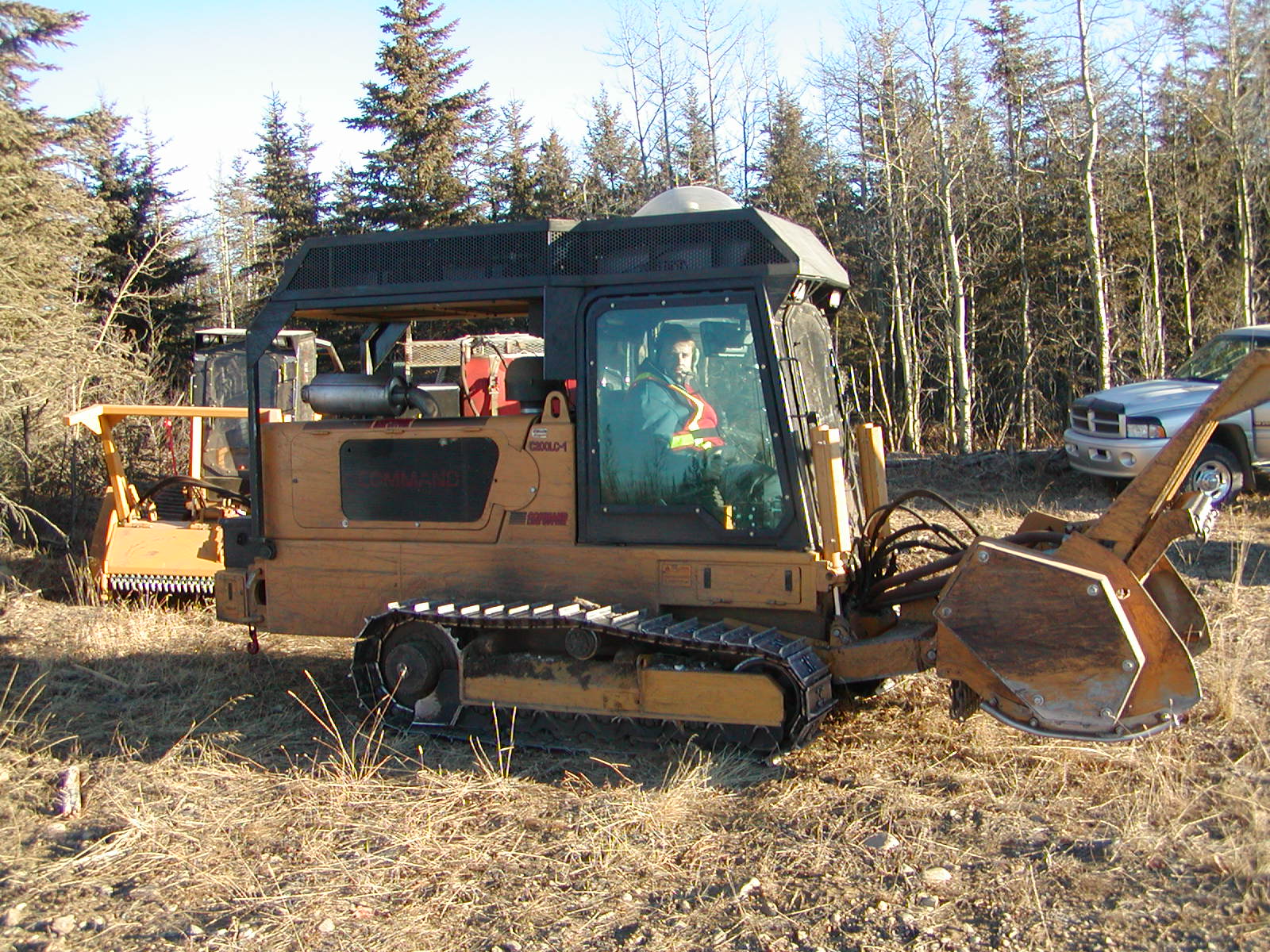

Thanks Guys. I spent fair bit of time with the owners of Rayco at their factory in Wooster and at my shop and job sites in Alberta. I was hoping to convince them to build a machine similar to the one I ended up building. JR is a great guy and his designers are top notch.
From the perspective of mass production a manufacturer has to consider a lot of variables when committing to building a new machine. Us contractors know what we want, but they have to be able to profit from the sale of our dream machine. Cramming 200hp into a skidsteer sized crawler is a substantial warranty risk. It would require betting their brand reliability reputation on what appeared to be a niche market. The cost of the hydrostatic rotor drive components was more then double (the 87fm) and selling new customers a little mulcher for 250K is not an easy task. The other factor as surprising as it is to us, is aesthetics. The machine has to look good to sell! The look on their faces when I showed them my prototype for the first time was priceless!
I did not need to sell them and made no sacrifices to make it pleasing to the eye of showroom buyers. When I calculated how much cooling I required I simply designed a roof to house the hydraulic coolers and AC system. I knew it would look rather bizarre but my focus was on cutting ability, operator comfort and 100% reliability. My competition laughed out loud until my little Frankenstein looking thing ran circles around their $400K lamtrac at a forestry show demo day.
I don't know if any manufacturer will ever offer a 200+ hp compact mulcher but if they start spending more time with the end users they will soon discover that this would not be a niche market. I will try and dig up more videos that truly show what this little thing can do, but most of the footage I have is during reliability testing. We were purposely trying to overload the cooling systems rather then show off it's speed.
I hope this machine inspires someone out there to build or modify their own mulcher. If enough people show the OEM's what we really need then we may be able to buy what we really want.

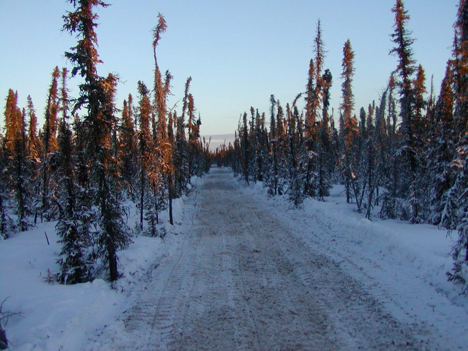

In my particular situation building a 200hp mini machine was well worth it. In the previous years I had proven to my customers that mulching was a viable alternative to clearing with a dozer. They were now willing to give mulcher contractors plenty of work if it could be done for a reasonable cost. The problem was that on the jobs that required a small narrow machine. The hourly rate we needed to charge to just break even did not match the production level expected by the clients. I literally traveled the world searching for a small machine that would satisfy my need to mulch trees as fast as lgp dozers could pile and burn it. Nothing came close at the time and I committed to building my own.
The key was having work lined up if I could produce a machine capable of doing it for the going rate. If you have or can get enough work to justify the cost of a custom built machine I would say go for it.
When Rayco told me (I was a dealer at the time) they were going to build the 130/140 series I was disappointed that they weren't 200hp+ but did do up some drawings for what I felt the potential of this chassis could be. I planned for a 7l to 8l inline 6 making not less then 1000 ft lbs from 1800 to 1400 rpm. Pumps were to be 2 x 130cc set to destroke @ 4800psi. I had a parts list assembled and drawings that showed where everything would fit . The only reason I didn't build it was that tier II emissions were coming into effect and I was concerned about the unproven reliability of the new technologies.
I think it's only a matter of time before someone refits a 140 Rayco to 300hp and it will be exponentially more productive then the 140 in anything bigger than 4" (or even high density 1" brush). If your typical jobs are clearing light brush then the 140 is a very capable machine. It is when we get into the heavy stuff that the payback starts exceeding the investment. In my case it increased profit 700% on jobs paying by the linear kilometer or Hectare. To put that in perspective I was being paid 1000 per km of 1.75 m wide seismic line. I was getting 1 to 1.5 km per machine per day with the C87FM. That jumped to at least 7 km per day with the 200hp machine in the same density on the same job....

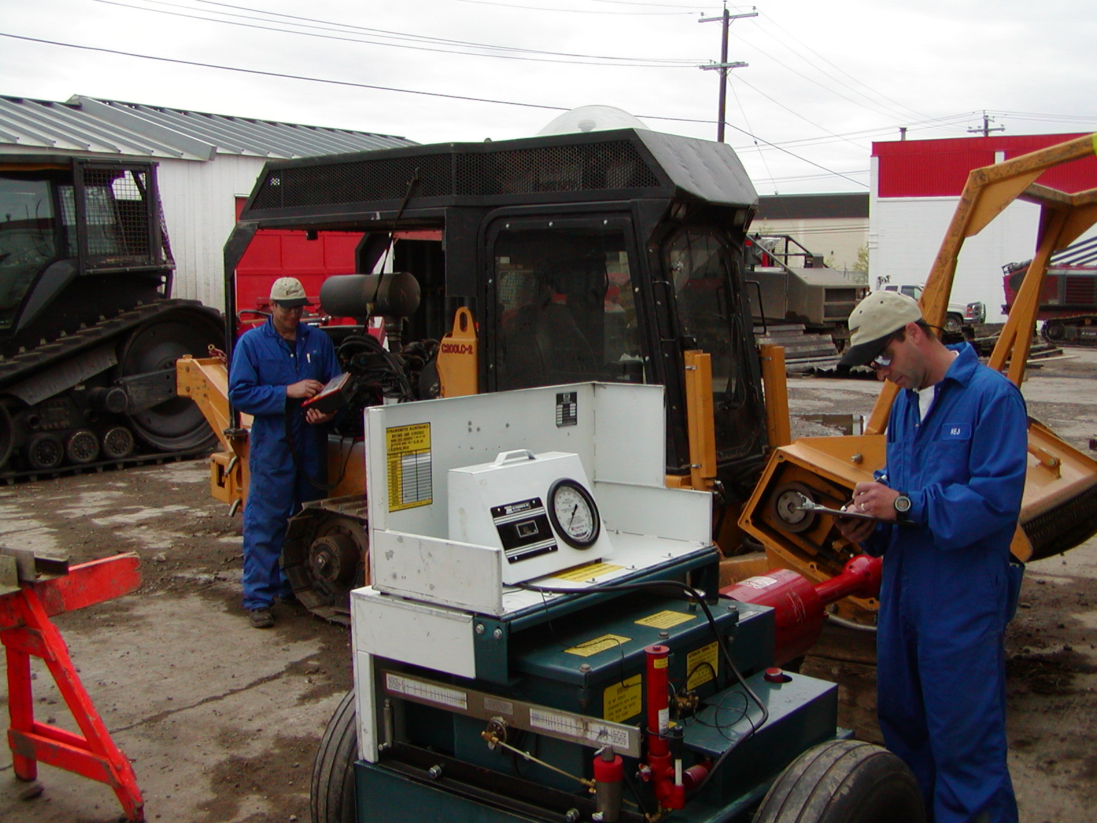

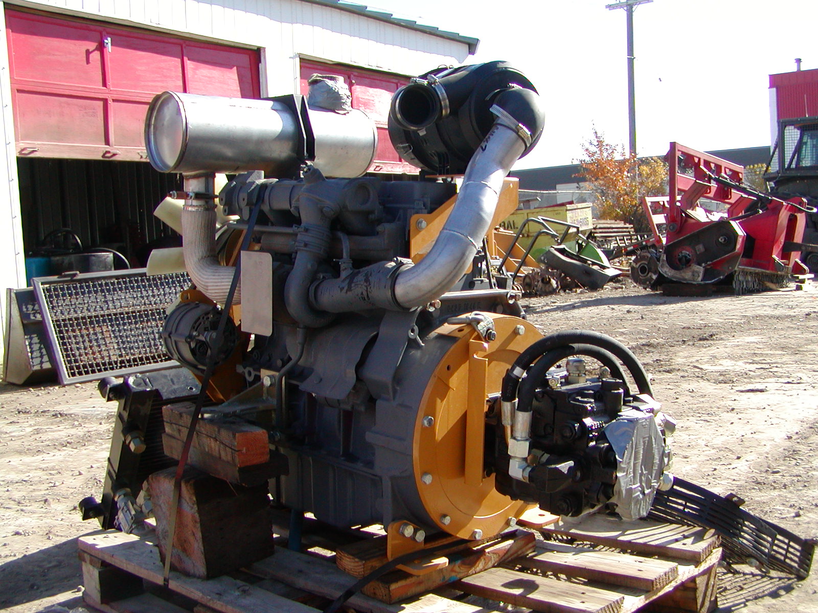

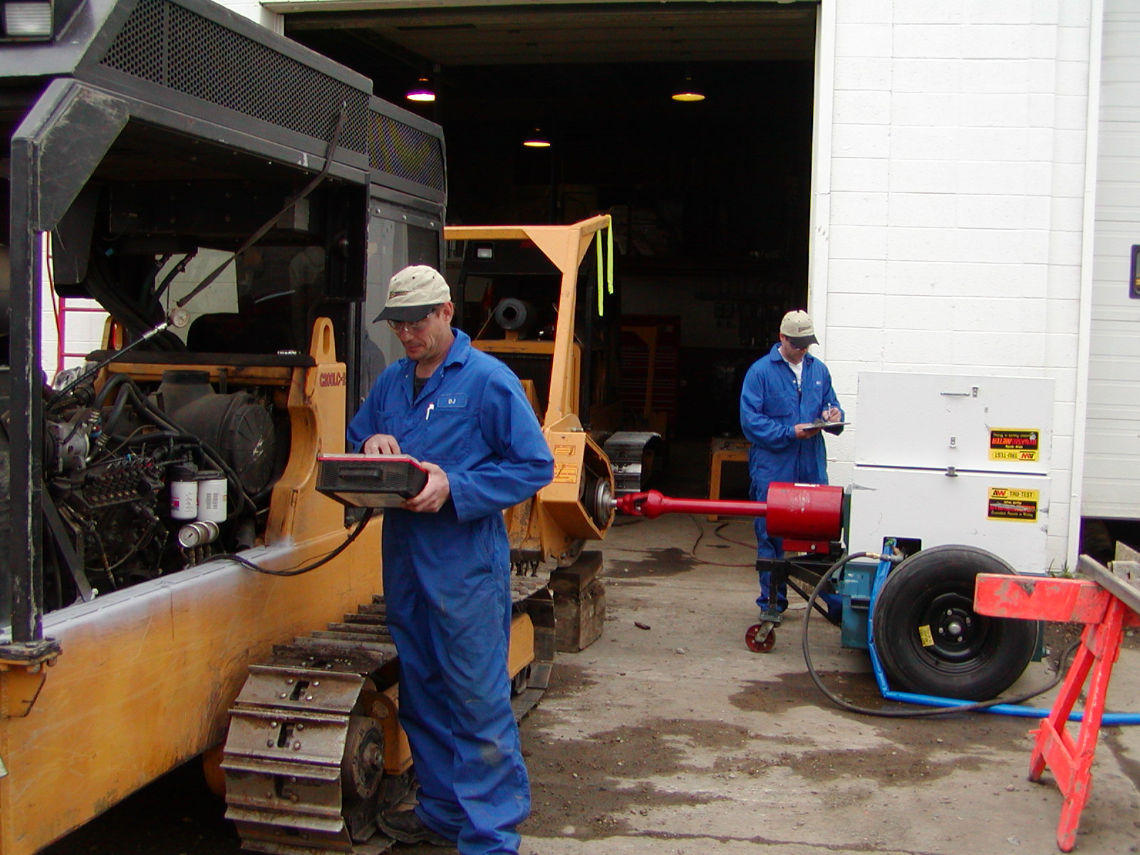

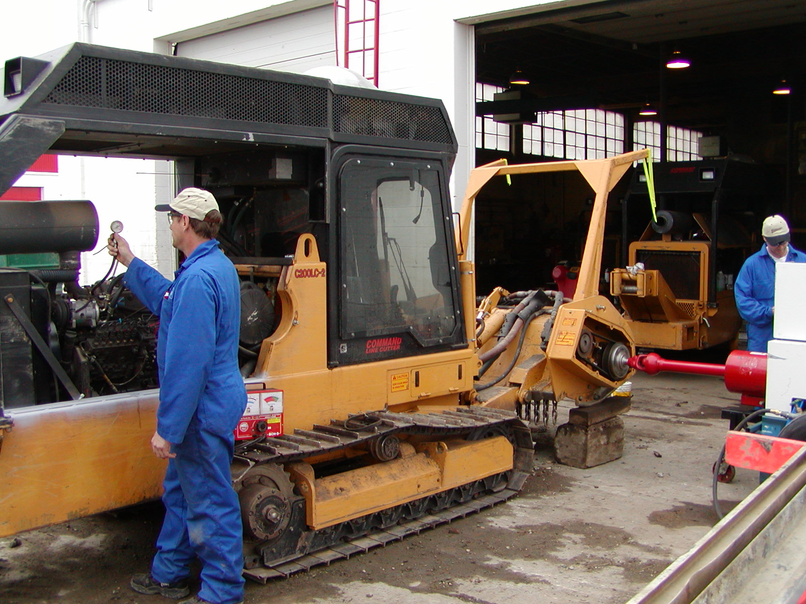

Here are some pictures for reference showing the Cummins B series sitting in the little Rayco (modified) chassis. I bought the engines new from cummins and then rebuilt them with aftermarket pistons, rods, adjustable wastegate and ARP studs throughout. We changed the injectors and pump settings to provide a huge torque rise down to 1400 rpm. The rated horsepower of 200 was not changed but it made 270 more ft/lbs of torque at the target rpm of 1750. The other picture is of the stock 87hp deutz and little 55cc pump that came out. I might be able to find more pictures of the conversion if anyone is thinking of repowering. The problem is most of those photos are trapped in my crashed laptop and I was too stupid to make back-up copies before the BSOD got me!
