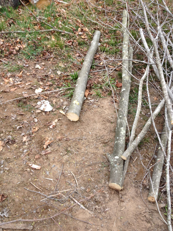

I've got a 3720 and I picked up a Frontier WC1205. I don't have a ton of time on the machine but I haven't had any problems. We chip mostly small oak trees and pine. The hydraulic feed is nice because you can reverse if anything gets jammed up and because it doesn't rely on gravity the feeding mouth is much easier to access.
the machine if pretty large. It looks a little funky on the 3720 but other than that I have not had any problems. Let me know of you have any specific questions and I can try t answer.

Here are a couple pics of the type of stuff I chip.

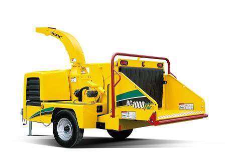

Have you considered renting a large portable chipper? Id imagine it would be cheaper than buying a new one if it's a one time job.

Yes! As a matter of fact I decided to first get a NAI light root grapple for getting all of the stuff piled up, and then will rent from a local implement rental store. I have too much big stuff right now. But I would still like to get one sooner, or later!...Thanks for all of your help!
