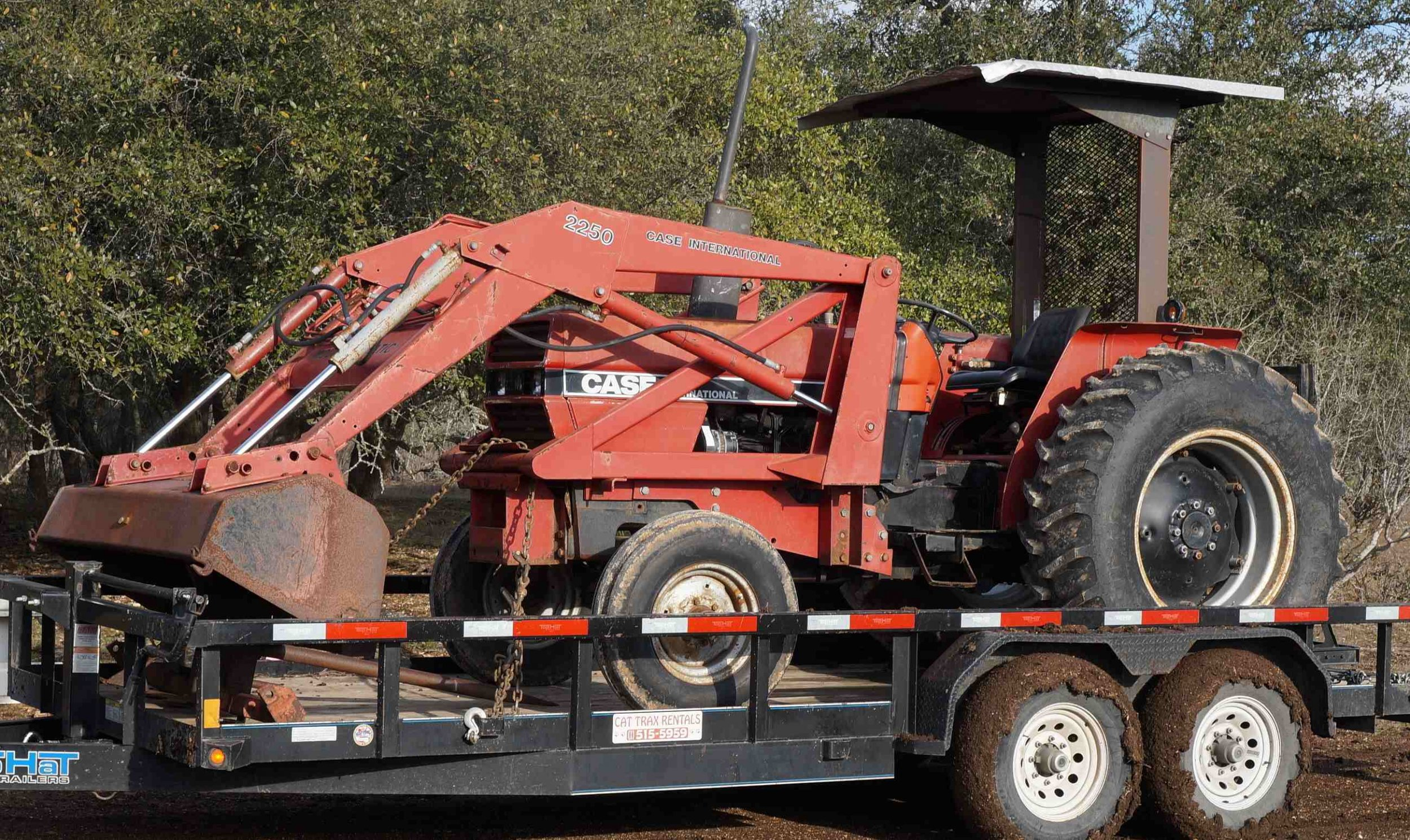

When you test drive them, check the shifting. Clutch's can be an issue. When you push in the clutch, it should stop spinning quickly. I would also recommend diesel instead of gas to avoid carb issues. I picked up a Case 685 for 10k with loader and it does all I need. My first tractor was a 70's backhoe. I loved it, it was built like a tank and had lots of power for only a 35hp but I missed the pto option. It was great for clearing brush and stumps. Another issue is finding a mechanic and they can charge up to 150 an hr. Weight can be an issue if you need to transport it so check trailer specs. If you plan on using the bucket a lot, make sure it can lift what you need. Lifting capacities vary. Tractordata.com is a good source for tractor specs. Last of all, be prepared to do some driving.

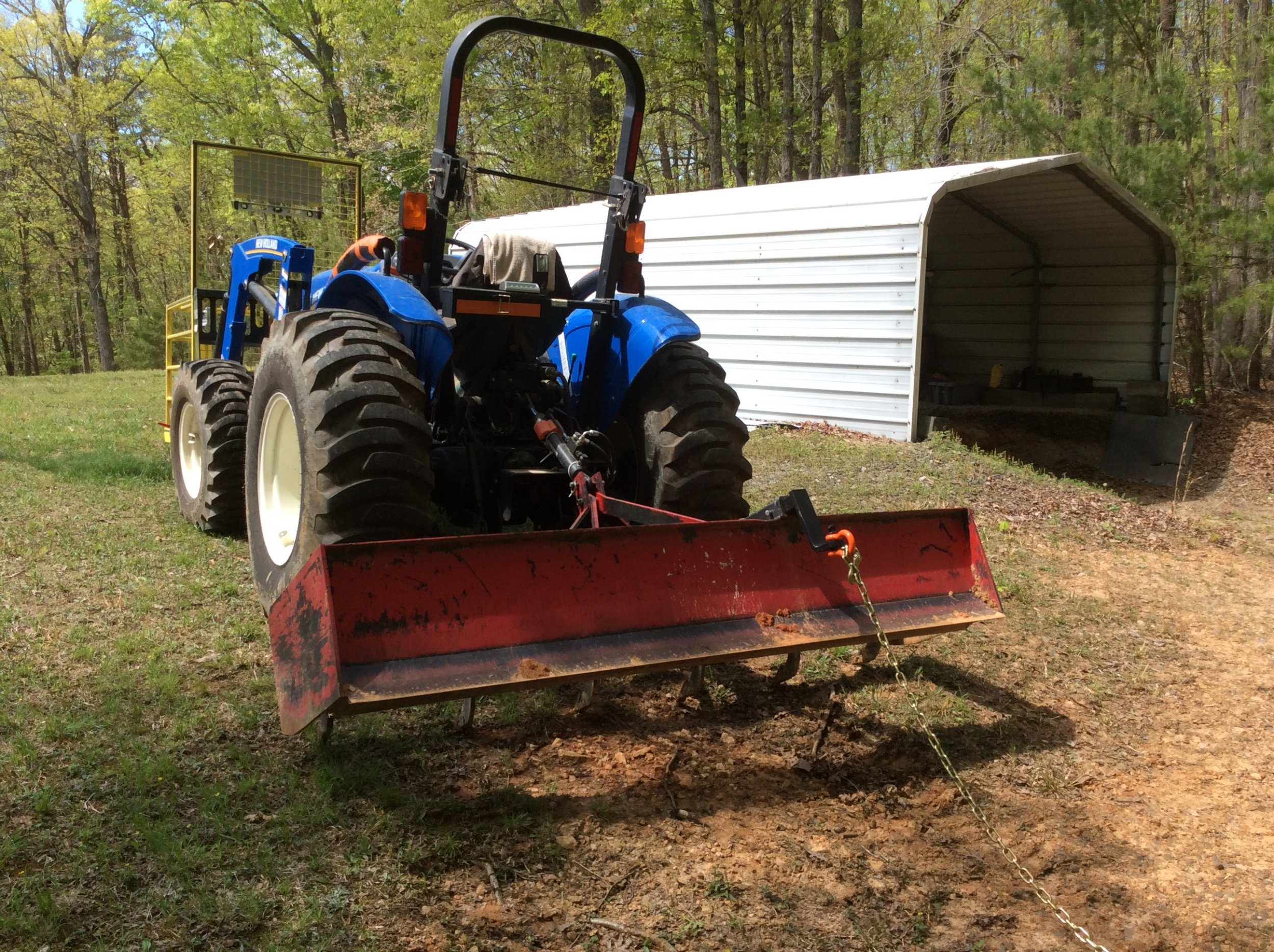

New Holland Workmaster 50, 60, or 70. Look at new then compare against what you can find used. The extra weight this tractor has will make a lot of difference. That is a HD 8 ft. box scrape ln picture on a Workmaster 50.
