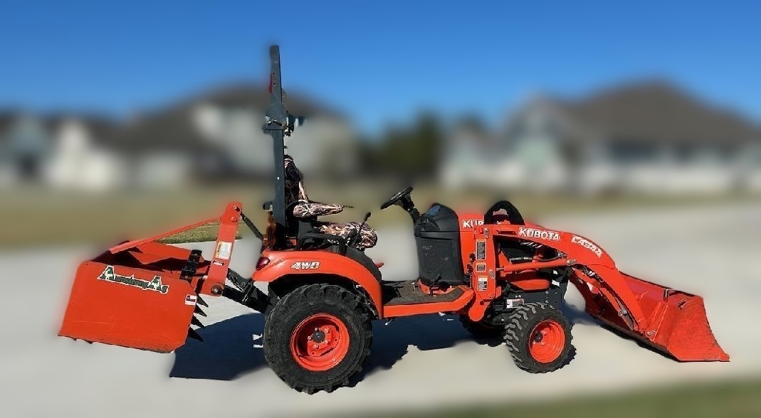

Sorry for the delay. Here is a photo of the BX I purchased. I did the maintenance I mentioned (engine oil, air filter) and checked everything else. I greased all points. I added the piranha bar and the underbelly protector from BXpanded. I also washed it head to toe. I'm building a small garage to keep it in next week.
@dj1701 - yep, front left tire was flat yesterday. Took it to my local tire shop. For $20 I had them pump in some sealer.
At this point I've run 10+ hours on it moving a lot of cedar chips into my burn pile. It runs like a champ.
I appreciate everyone's feedback on my post.

Looking good!
I put a Piranha Bar on my L4060, and really like it. This past summer I excavated about 20cy of dirt for a pole barn, hauled out a similar amount of previously buried demoed concrete, and laid 40cy of stone for a driveway and concrete pad bar. The Piranha Bar looks barely touched.
/ Looking to buy BX2680 #20
Very nice! You're going to find so many uses for that Kubota; good on getting the armor, if I had a BX I'd be sure to have it too.
