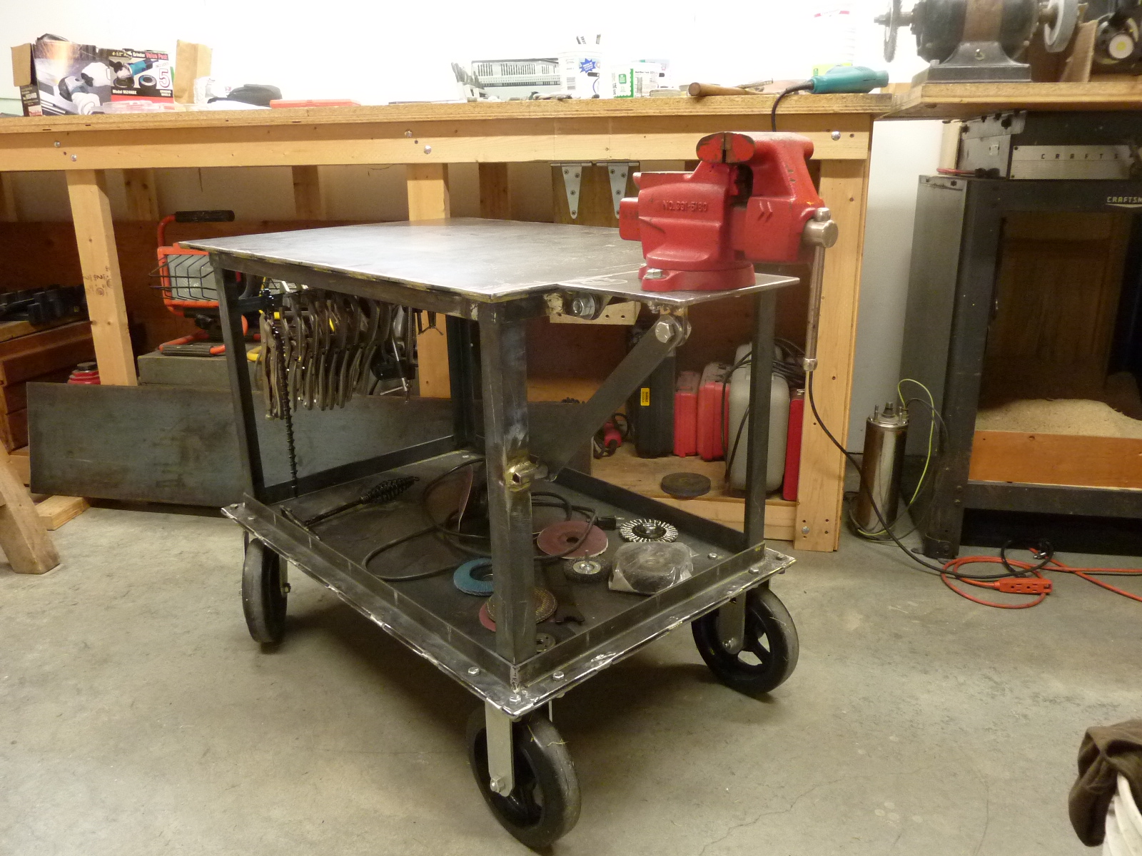

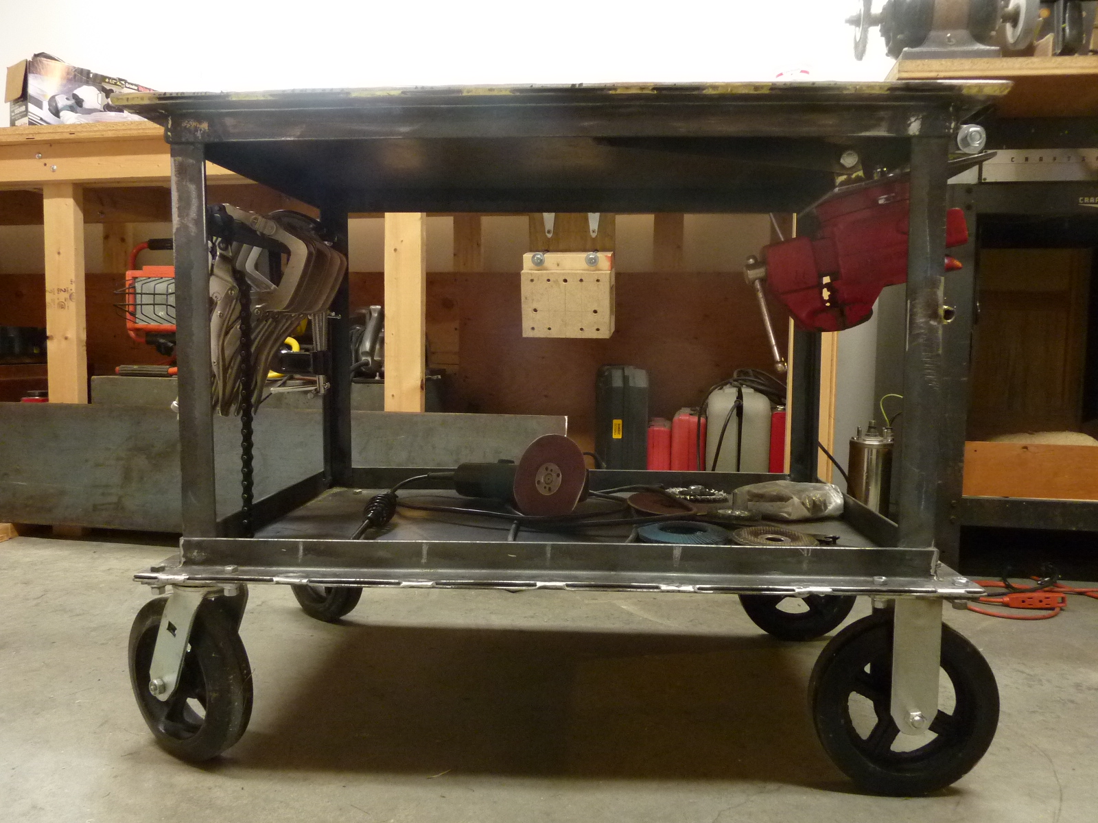

Aha... yeah flipping it over and inserting backside maybe? Definitely worth playing with... I think I have a loose receiver but it not worth buying another and give it a go this weekend. My smaller vices are currently clamped to my small work table 2ft x 4ft 1/2in plate mounted to an old salvaged Craftsman rollaway. The small vice and my ring roller are directly clamped. My medium sized vice is 'Click Bonded' to a small plate that I clamp down. This way I can move and clamp it other places and make my platform completely free of attached stuff on working surface if I want.

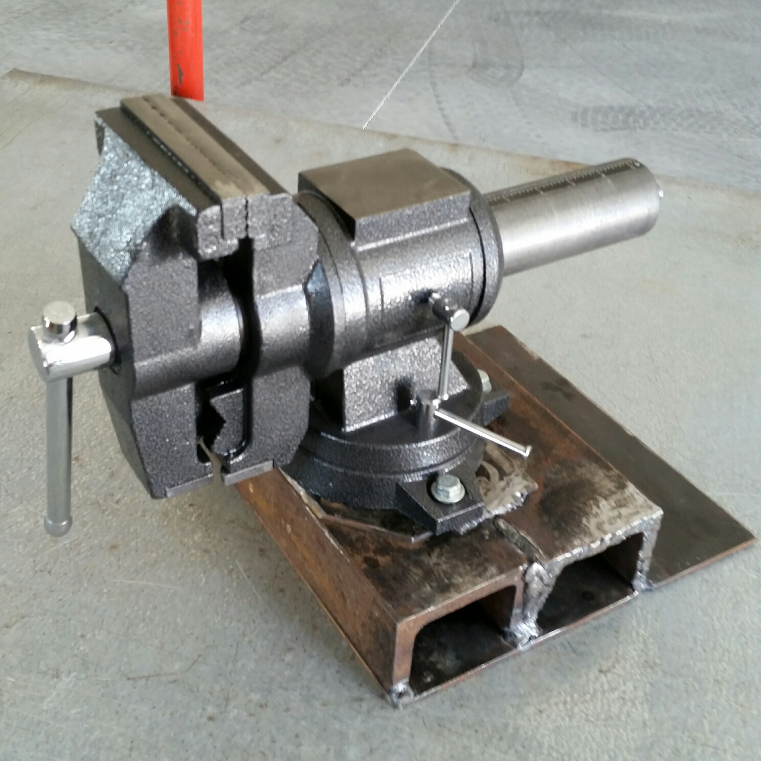

Here are pictures of vise and anvil. One vise base has scrap flat across the brake drum, the other has a rotor as the base covering the hole. Got the brake drums from a scrap yard, like most of my metal.

That's cheating... I just found a long piece of 2in by 1/8in and a hitch I was modifying for a different project. My problem is I don't think I have enough under table space. 11in by 24in is area to work in for concealed under mount. Dang vise is 60lbs. Not sure hanging off my table will make it too easy (top heavy) to flip my cart!
