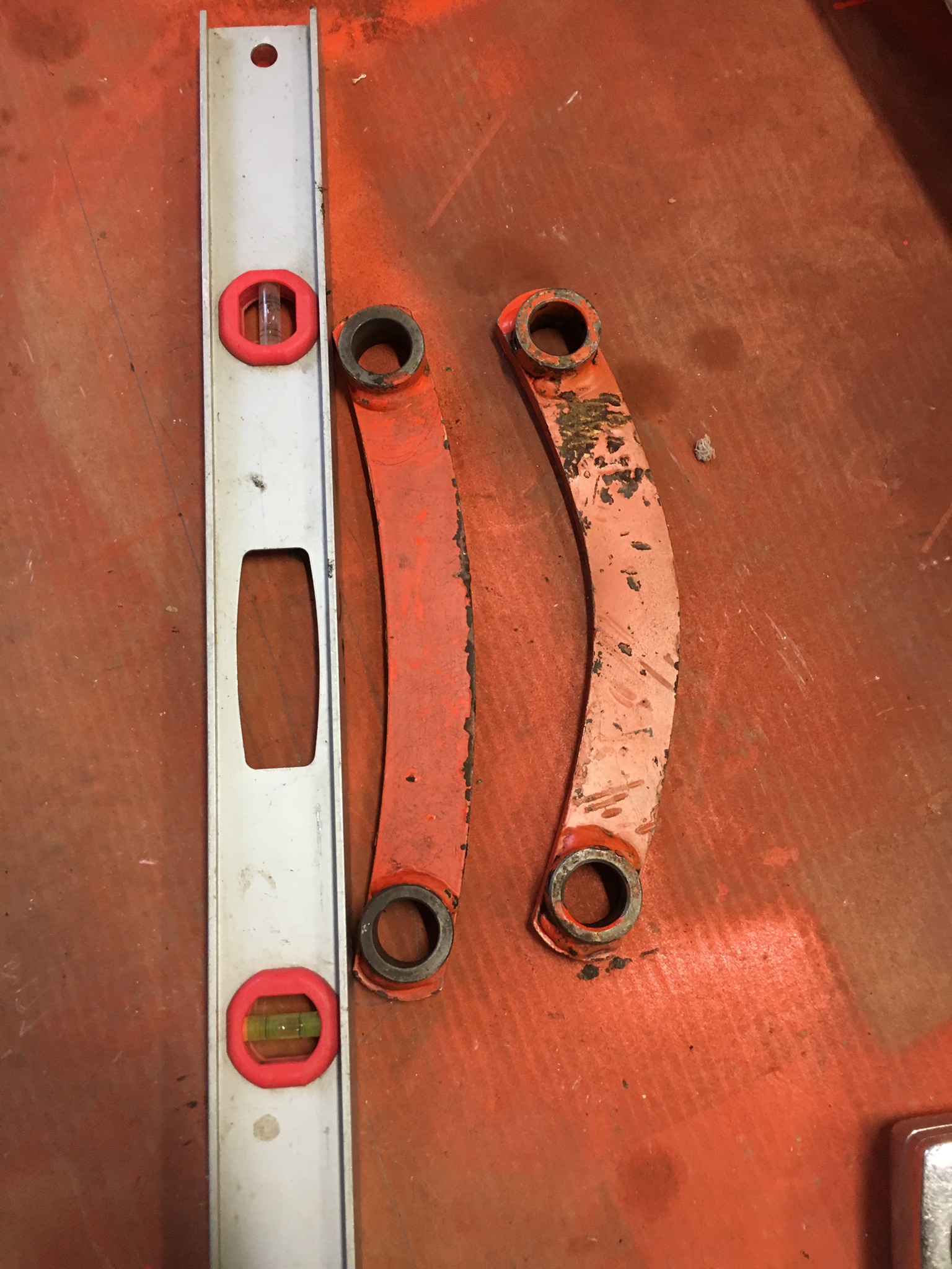

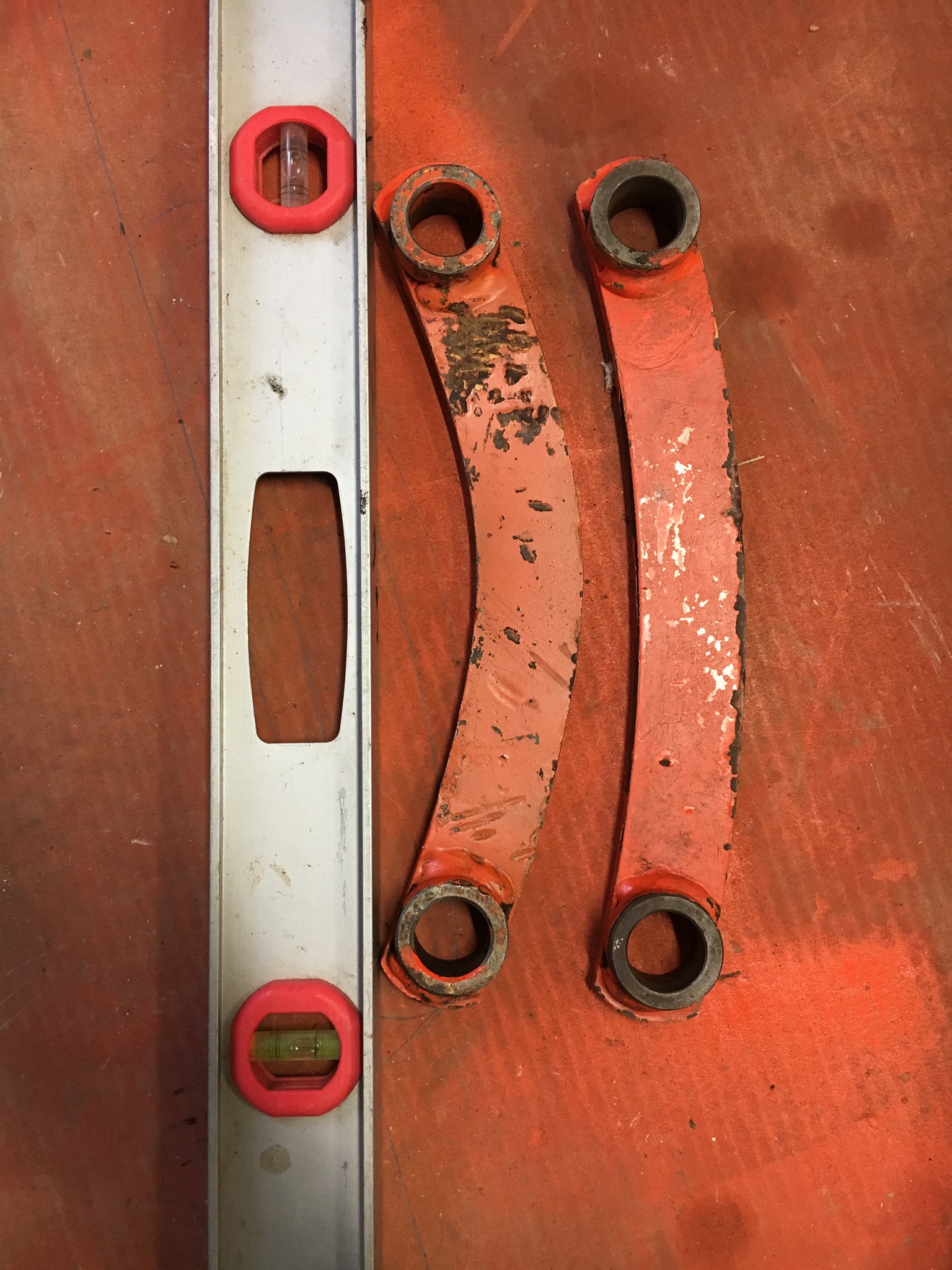

Well after leveling the frame. I then used a 6ft straight edge across rear of frame to use as a point to measure forward to boom supports and then to boom cross member. I知 off 1/2 inch low side of boom to rear of tractor. Measurements to supports are good.
All the comp links are good except one. It appears that it was bent or remanufactured. And throws the radius off 1/4 of an inch. The arc on the remaining 3 links is 3/4 bent one is 1-1/2? See photos. 53D0E4A2-863D-42D9-A8AD-395A9FEDD88D.jpeg4B40C26C-963D-46BA-A200-689C45022D07.jpeg
Lower boom bushings are slightly out of spec. Plan on changing them at later date. Pins are slightly out of alignment.
I知 planning on cutting the cross memeber and bending left side of boom up and in to make it square. Then align the pins.
The two lower attachment points on bucket need to be repaired and aligned. One collar or cleaves on low side of buck snapped off. I believe the misaligned comp link and pin on the upper opposite side put pressure on the opposite lower side causing the breakage.

Sound good, a bit of work but getting there, cutting the crossmember will make for easy rotation/correction of boom. Did you paint strip or wire buff the old repair for a look?
